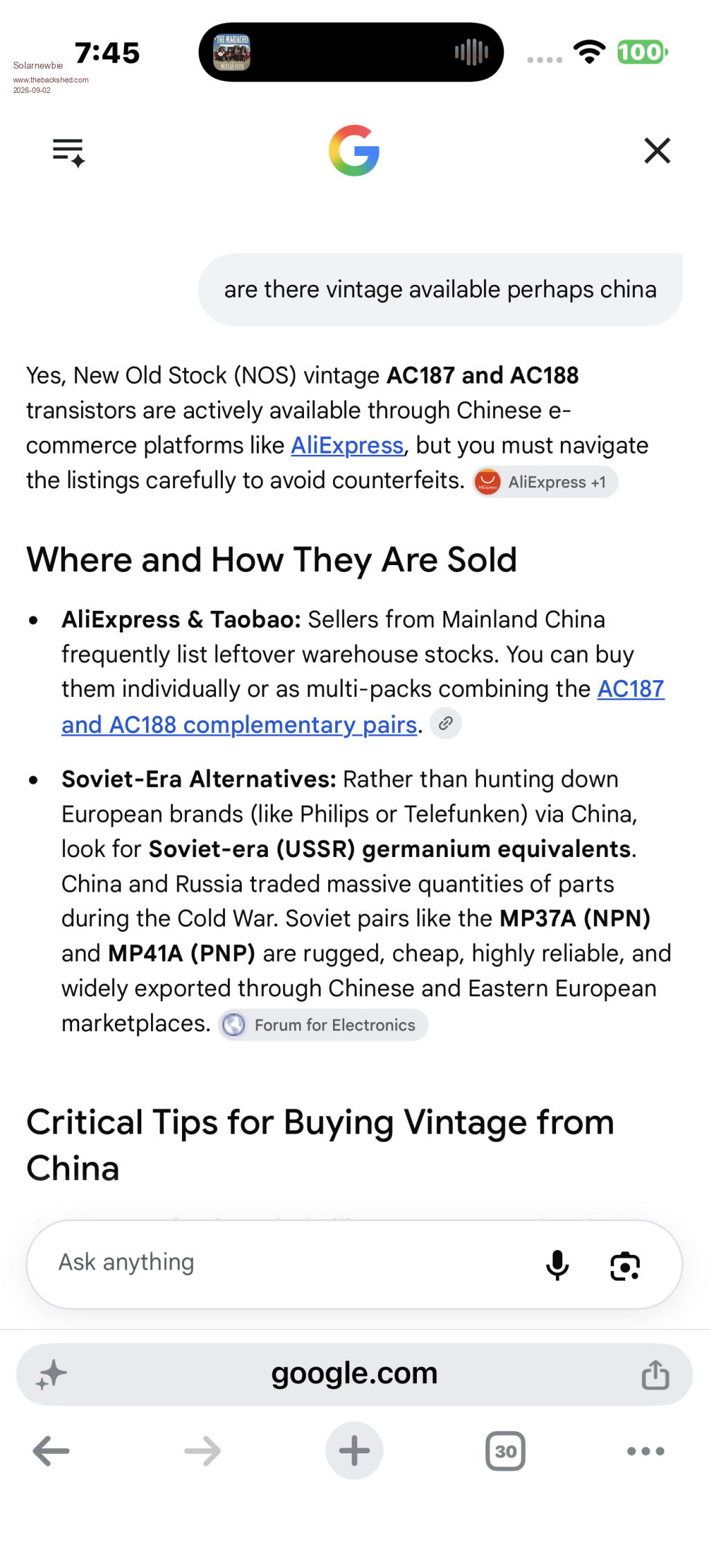

Posted: 11:46am
02 Sep 2026
Solarnewbie
Best I can do.
Posted: 11:28pm
02 Sep 2026
InPhase
It's probably easier altering the bias network to use silicon than it is to source authentic working replacements.
