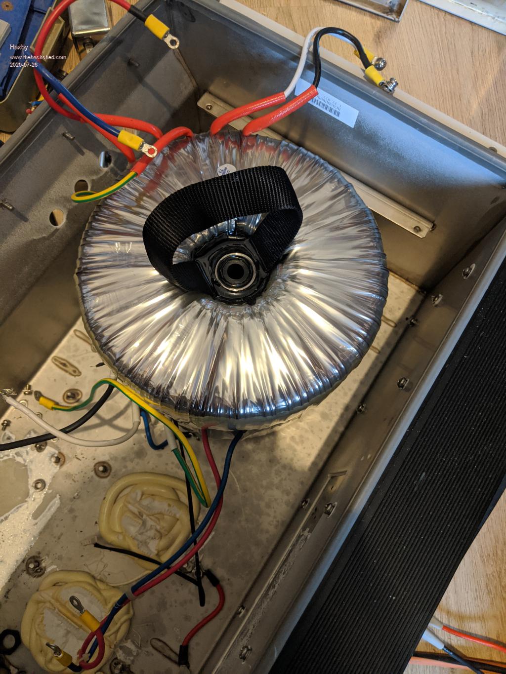

Haxby
Thanks warpspeed!
Ok the second transformer is the one in the pic above. It comes from a 1.5kw aerosharp. Without mods, it's 93v:230v
So at 200v it's output is 80.86v.
That's tantalisingly close to the required 72.33 but not close enough. I wonder if I can unwind a few turns?
If there is a trick to get the core out, let me know!
Posted: 08:06am
26 Jul 2020
O/K 80v is a bit high, but usually the winding with the fewest turns is on top, so it should be possible to remove a few turns to bring that down.
Usual way is by brute strength and ignorance, aided by a BFH.
(BFH = big flamin hammer)
Posted: 08:59am
26 Jul 2020
Haxby
Well that sounds good to me... Two transformers in and I haven't had to do much work yet. For the third toroid, I'll propose to buy a 300va 240:30v transformer toroid. This will give me 200:25 and I can back turn 1 volt to get 24.

Yup !
Altronics have a 30v + 30v 300 Va toroid, and also a 9v + 9V 160 Va toroid.
A slight tweak +/- here and there with the turns, and it should all work out very well.
This will all be excellent for initial proof of concept testing and give you a much clearer picture of how this all works.
Start with the largest inverter first, then add each new inverter successively to that.
Don't be too surprised to see massive overshoot and ringing on the secondary from just the first big transformer all by itself.
The second transformer will give you nine voltage steps, but they will look a bit ragged on the secondaries as well.
Third transformer, twenty seven rather wobbly looking voltage steps, not clean steps, don't be discouraged.
Fourth transformer, magic happens.
The final sine wave will look unbelievably good, and that will be a real surprise.
Transformers don't like square wave current, but when all four transformers are working together in harmony, the combined voltage and the combined current through all the transformers will be sinusoidal.

Good news is that the potted core came out easily. I rested the transformer on some polystyrene and wacked the centre with a sledgehammer with a bit of timber between sledgehammer and the potted core.
It came out nice and clean with no damage to the windings.
Bad news is the 80.86V winding is under the 200v winding.
Now should I:
Back wind the 80.86v winding to get 72.33
Or
Unwind the whole lot.
