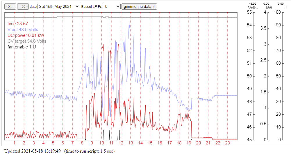

I think I would first look at the loads you expect to have to support.
I can only speak from my experience so my house uses
about 200 - 500 W for most of the time. There are short peaks
of 1,500W when a fridge decides to start up due to their thermostats.
Recently, last 6 months, I have added the dishwasher to the circuit
and this draws 2.5kW for 3 periods of 6-8 minutes each.
Last Saturday is typical. The Red line is inverter DC input power.
The light Blue line is battery voltage. Upper Grey line is constant voltage charge target. Black line is fan command, non-zero means it is running.
So from the above it would be sensible to make an inverter that is running
at it's most efficient when producing about 500W.
It spends so little time at the high levels I can afford to have it at a lower efficiency during those peaks.
My estimation of efficiency is something like 93% at 500W and maybe 91% at 2.5kW
(there are times when the inverter power is zero. This is when the battery voltage drops to below low voltage cut-off and so the inverter is switched off)
So, what is your load profile?
All day at 3kW?
All day at 500W with short peaks of 3 and 5kW?
All day at 150W, just a fridge and some lighting, then you cook at night
using electricity. 1 hr at 4kW...
The home inverter is a 4 x 4 HY4008 power board and in testing I have shown
these are capable of well over 10kW peak power.
The limiting factor will be heat removal.
I chose not to make my own toroid transformer. I use a stock standard 3kW
220V/250V toroid from an Aerosharp. I then wind my own primary over the top of
the two existing windings. This forces me to use smaller copper area than I would like. But I can live with the drawbacks of extra heat and a little less efficiency.
So my toroid gets hot with 2.5kW and after 5 minutes, the fan is commanded to run.
On occasions, maybe when the pool pump is running (1.5kW) and then we run the dishwasher, both fans run - one for the heatsink and one for the toroid.
In the above day's graph, the heatsink only peaked at 32 degC and the toroid winding
peaked at 49 degC.
The nanoverter will also shutdown the inverter due to over temperature conditions
so it's quite safe and can look after itself.
So look at the load profile first.
That might then suggest battery size.
Then have a look at your usual day's energy usage, in kW.hr
This will also inform the battery size choice.
And then you will have enough data to choose the inverter power.

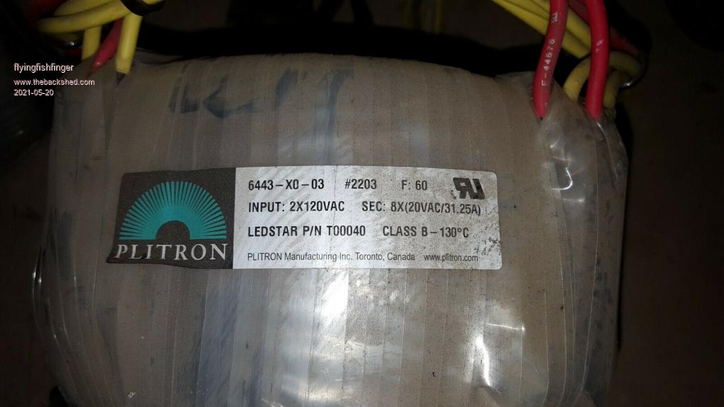

Oh, found something interesting: 5KVA transformer. It's local enough that I could make the drive to pick it up, so it really only would cost $60.
If we look at the last two pictures, they are of a beefy toroid. Could this work?
The ratings on the non-toroidal one are much better, though. I can't quite tell if I would get the toroid or the "square" one, but I have inquired...
R

The toroidal in your link looks like a good start. It's all about the core dimensions and material quality. You won't really know what you have till you take it home and do some tests. If I was you, I'd buy 2 of the toroidals, take them home and run some tests. Unwind/rewind if necessary. Warpspeed is our resident transformer expert and may have more to add.

It almost seems like I could use the first one as-is, but I'm probably missing something relevant.
EDIT: Here's another, , 4.5 inch diameter, 2.5" tall. Too small?
R
Edited 2021-05-19 06:15 by flyingfishfinger

I think the second one is too small for your needs (my guess is only 300 - 400VA).
For the price the 5kVA unit is a real bargain, despite the fact you need at least 28VDC to get your 120V AC rated output. Working backwards from a 24V supply you can only generate ~ 17VAC so at full power you will only have ~ 102VAC. But at times when fully charged you will have ~ 27.5V that will transform to ~ 117V AC.
I assume most power tools would still work fine with 100VAC and the kettle aint going to boil real quick either.  But the rating is for 5KVA, so running at say 1-3 KVA losses will be minimal (certainly less than at 5KVA) and you might get an extra few volts out you weren't expecting. I reckon set the output volts to say 105 and be prepared for it to droop a couple more volts as the batteries draw down.
Its worth the $60 from a learning/fun perspective and if you go to pick it up you can have a closer look at all those toroids he has lying around whilst your there, maybe you will strike gold !
Posted: 11:17pm
18 May 2021
wiseguy
Just had another thought maybe you can wire the secondary in series with the driven primary and get back another ~ 17VAC added to the output. Its unconventional but I reckon it would work fine.  The output voltage is then not isolated from the batteries any more so safety & attention to accidental grounding etc must all be considered. This is not intended as a long term solution just as a means to an end to get going out in the back blocks.  Now you can have at least 115/117VAC and know it will be that for 90+% of the time.
I should also add and clarify that our inverters have mostly (all?) used toroids. In that respect you will be a bit of a pioneer. The toroidals are a bit more efficient perhaps Tony could indicate what comparative losses you could expect, I reckon he has more hands on experience than I do in this area.
Edited 2021-05-19 13:42 by wiseguy
Posted: 04:43pm
19 May 2021
flyingfishfinger
Apparently they're all the same.
Too bad, would have been nice to be a "pioneer" :) I think you mistook the first set of pictures. He's out of "rectangular" transformers, only has toroids left:
I was able to find a datasheet to go with it as well, attached. How much of this could I use as-is?
644303-1_toroid.pdf
