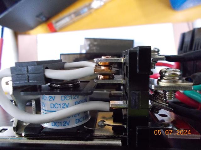

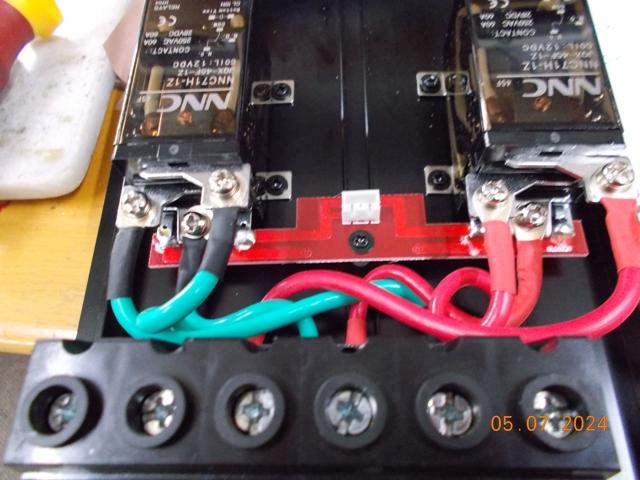

I should have ripped that old ATS apart long ago. Inside I find two relays, each rated at 60A, one switching Neutral and one switching Active - simply connected in parallel, the gaps are TINY, what could possibly go wrong above 5kw, it's rated for over 11kW.
Below

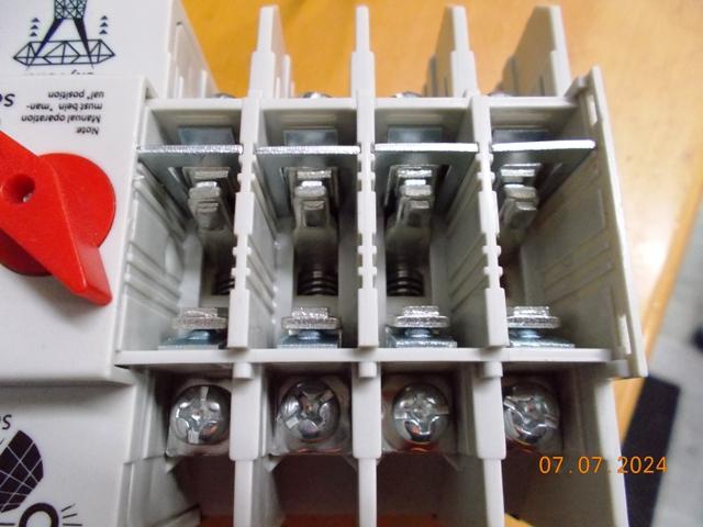

The newer low cost ATS has a gap measured in inches - a rotating cam, huge contacts and dual solenoids.
I'm using the 2 pole version of this similar unit for now.

So, I have it working with the addition of a single small 3A AC SSR "Solid state Relay"
I used the same Mains/Solar priority switch with a tiny 240vac to 6v transformer and small housing I had used before, the only connections to the inverter are the AC enable output pin from the controller FET and a ground connection - brilliant!
The circuit shows two relays, one on the Main power input and one on the solar/Generator input, this is wrong, there is only one relay for the two "Passive contact outputs" on each AC input.
That relay is controlled by the Top input only, because of that, it allows the use of lower input passive contacts of that relay be used to stop the backup AC input powering the solenoid if the Top input also has AC mains. You cannot have AC on both inputs unless one solenoid is disconnected. The solenoids are driven by two wires from each AC input connected to the AR, AN and BR, BN terminals on the two green plugs.
When a solenoid detects AC, it pulls the switch cam across and a micro switch disconnects the Solenoid to stop it burning out. You can see what would happen if both inputs had AC applied. It turns out though, that this is a really brilliant design and so easy to use once you realize the dam circuit is wrong.

FYI:
The GAP on the first ATS.
GAP on the ATS I'm now using.

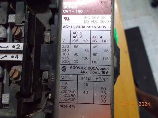

What about one of these solenoid switches
It's the weight of a small vehicle battery.
