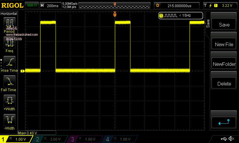

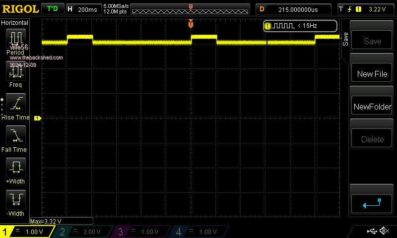

ville56
2 scope images:
1) signal at the DS18B20 without pullup resistor (data are at the low/high transition but resolution is too low to see them)
2) same signal with pullup 4k7 attached
my conclusion: the pico does not properly pull the pin to low with 4k7 pullup to start the conversion because the output is not correctly set since at least V6.00.00 RC17.
Posted: 07:06pm
08 Dec 2024
It looks like that. Perhaps the output wasn't set to low before the in/out mode switching? That would almost certainly be in the firmware.
