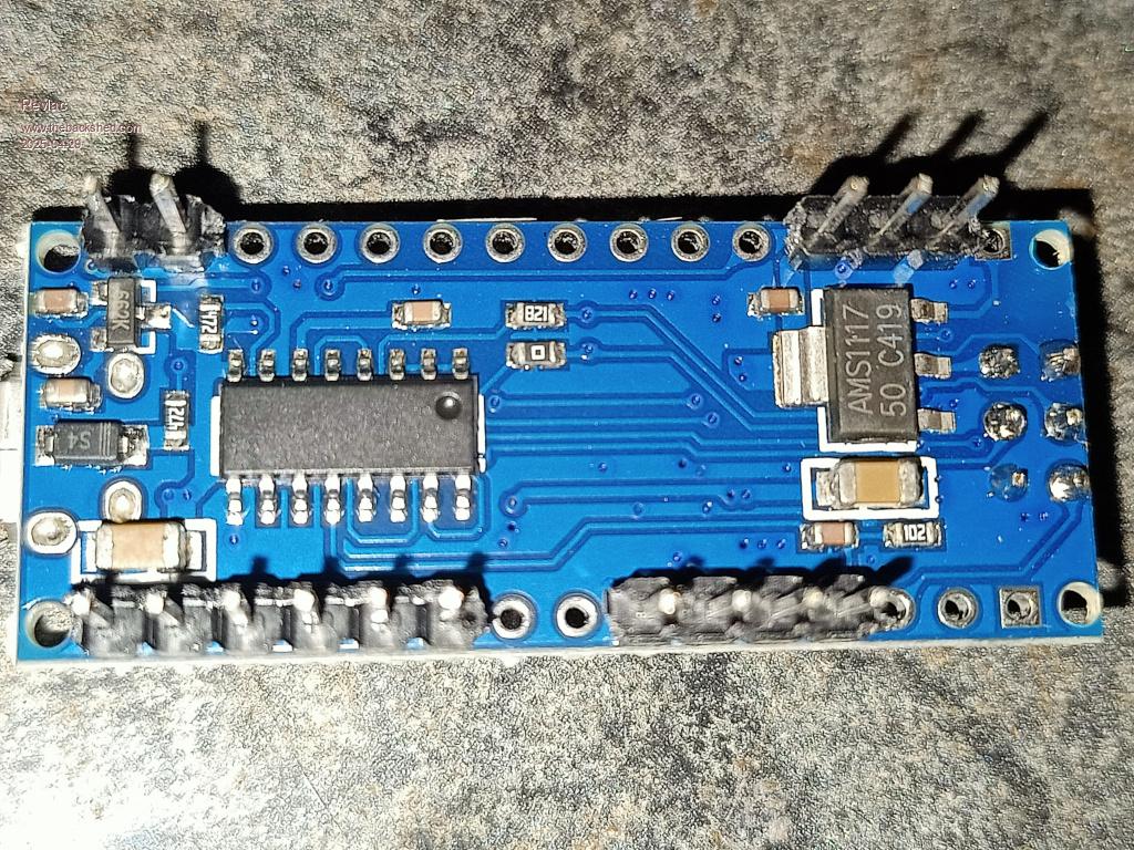

The 5V voltage regulator that was getting a bit hot, after much checking, everything else was working as it should be, just that the LCD was using a little too much from the 5V regulator (in a box with no airflow) so a little mod was suggested by Wiseguy,
"we can cut the track on the bottom side of the LCD +5V pin heading towards pin14 of U6 (HC86).
If we feed a seperate 5V supply to the +5V LCD pin (and the 2 x LED buffer chips still connected to the LCD +5 pin) it will solve the problem."
I also had to fit a 5V rail monitor to the LCD PCB, or it will corrupt the nano first time power is turned off.....I had to find out.

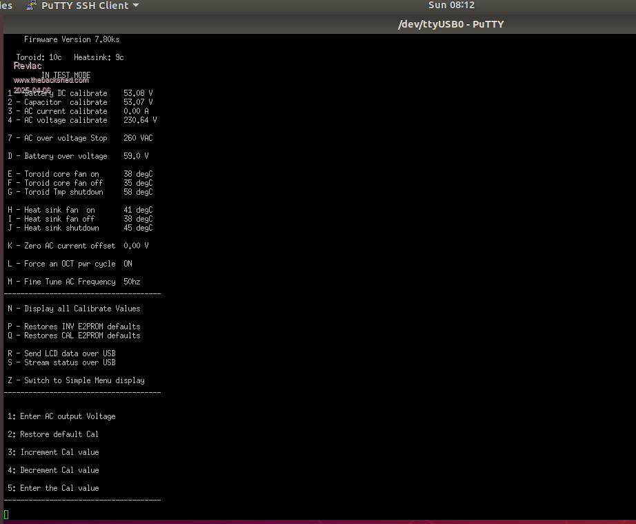

Now I did some of the Calibrations this morning using PUTTY on the Ubuntu PC (the Windows one still not happy) it works a bit like Tera Term, but haven't figured it out completely yet, when selecting menu items it will scroll down the list to where it should, but I couldn't enter the battery calibrations, typing in the new value, it had a flashing courser but no numbers appeared when typed, will probably sort that out later, but no problem I used the increment and decrement a few times and it worked a treat......All Good.
Voltage is good.

There was some strange LCD corruption right from the start back when, and I assume you mean the Nano on the LCD board got corrupted.
This is caused by keeping the Nano Reset pin connected to the USB Chip on the LCD Nano board, depending on the Nano board, the USB chip can really screw the Nano as power falls feeding garbage to the Nano serial port and corrupting Code via the Boot loader if that is still programmed in, mine are not and the Reset line is disconnected on both Nano boards in the inverter. It has Never glitched.

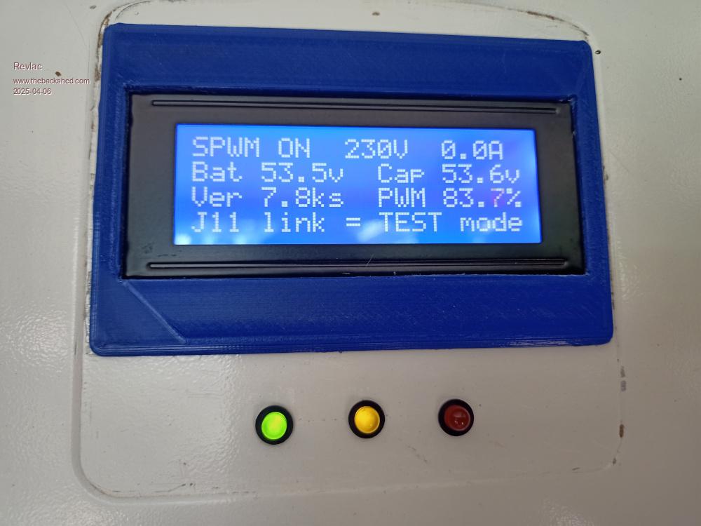

Yes the nano on the LCD got corrupted, rapid flashing/Flickering of the LCD when powered down, how bad or fast depended on the regulator type, I put the 5v rail monitor (found the MC34164P-5G seems to work) on the reset pin 5v and GND on the PCB and the LCD still flickers but the nano is no longer affected.
This nano is programmed with the LCD Hex code.

  Quote  when selecting menu items it will scroll down the list to where it should, but I couldn't enter the battery calibrations, typing in the new value, it had a flashing courser but no numbers appeared when typed, will probably sort that out later, but no problem I used the increment and decrement a few times and it worked a treat......All Good.
Make sure "Local echo" is selected in the Terminal Setup application, you want the Terminal Program to show the keystrokes that you type.

Obviously the supervisory IC will pull the Nano +5 volt down sharply and avoid the problem of corruption mentioned above, so does removing the Diode and Reset Capacitor on the Nano, on both the Controller Nano and the LCD Nano.
I have four low cost Nano boards already modded and programmed to swap at any time, I'm still using the code development Nano in the Inverter, God only knows how many times that has been programmed and experimented on - it's still perfect.

Ok PuTTy Local echo and Local line ending was on auto,    Changed Both to Forced ON, looks like that will do the job, works on the other computer will try it later, still have to calibrate the Amperage as I hadn't done it yet, I run the Hot water system for a few hours today and could see it was out a bit.

I don't use the rail monitors as the Nano boards are modded, so USB +5v and reset line are disconnected from the Nano micro.
If you leave USB reset connected to the Nano micro, be very careful if plugging anything into the USB port on a Running Inverter - you will instantly reset the inverter.

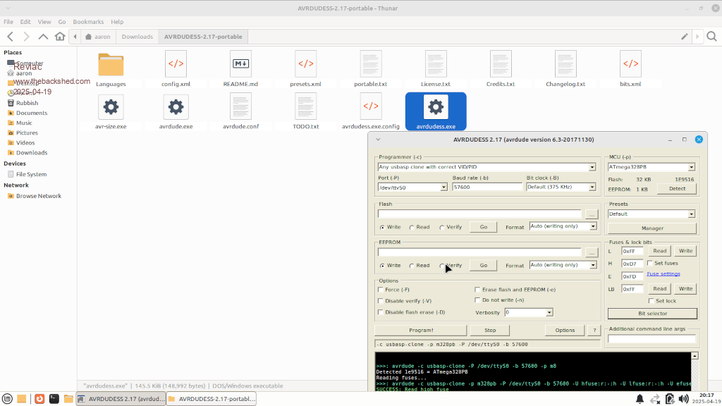

FOR those who want to use Linux Mint and AVRDUDESS to program the Nano.
I think mab1 might be interested?
I did get some info from here https://github.com/ZakKemble/AVRDUDESS
Tried a few things but didn't quite get it working yet.
The package that KeepIS posted earlier had a portable version.
Not sure how I got it working or it was working before and I only just noticed.
Screenshot, looks like it will work.
Also the version of Mint I used did not have the CH340 driver package installed, talk about that solution later if needed.

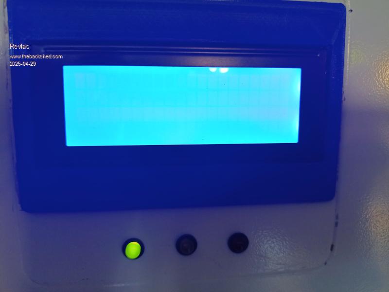

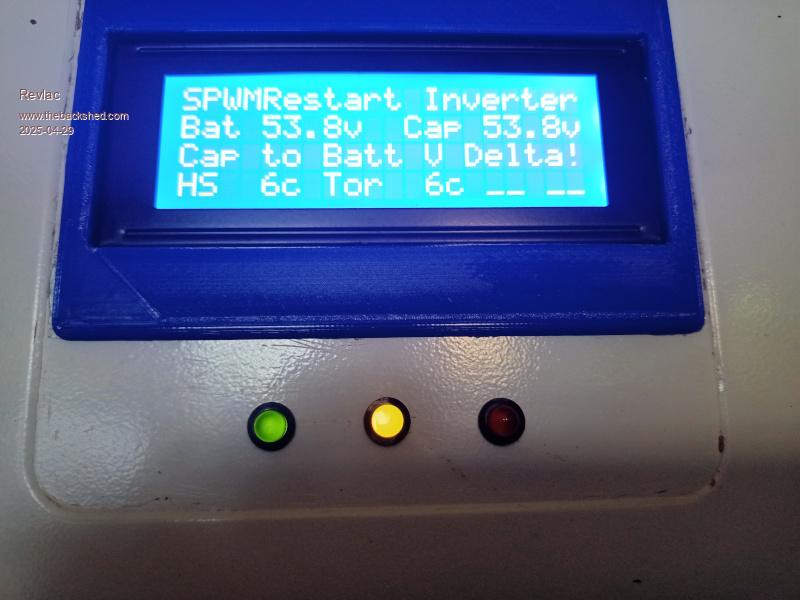

Well it was interesting this morning, Inverter output stopped somewhere between 1:00AM and 8:00AM, absolutely nothing running at all,  used some power last night but battery capacity would have been over 90%.
So I restarted the Inverter and it fired up until about the time the output relay turned on (give or take a few seconds) and noticed the LCD go blank, cant tell exactly when it went blank before taking a photo, the rest of the Inverter was running ok and output voltage was all good.
Restarted again thinking I will get a short video of it, but no its working perfectly now.
I still haven't upgraded the main Nano from 7.8Ks to the latest HEX code yet, I have one done and put it somewhere.

Are you running the latest version ?
I had that situation out of the blue a few days ago, that's the reason for VER 8.1.
I make sure it's a Delta error before stopping SPWM and requesting a restart.
EDIT: Does the LCD have a boot loader? does it have the USB Reset Cap removed?
BTW Mine also happened in the middle of the night with virtually no load, after 8 months of almost 24-7 run time.
I know how it could happen on that one trip point, the fact that it happened once after all this time is a testament to the great stability of the ADC inputs and the little Nano in general, along with the quality of the controller PCB design

Now running VER 8.1, on a different Nano, seems to make a slightly different transformer hum starting up, will run tomorrow as I had to put up with some noisy machinery today.
The battery and capacitor values have been within .1volt all the time and remain strong under load.
The LCD Nano has no bootloader, but the USB Reset cap might still be in place, don't know which cap it is on this nano.......(see photo)
