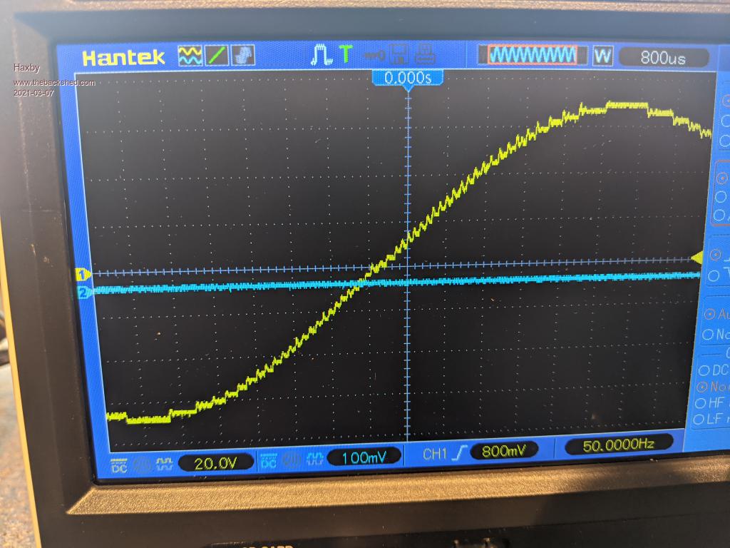

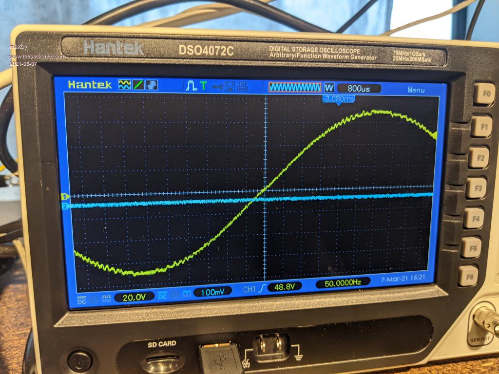

Another small matter is the little ripples in the output sine wave.
Any tricks to get rid of them? Again not an issue, just thought I'd ask.
This is after a filter.
Posted: 07:44am
07 Mar 2021
To me, that looks like capacitive coupling between the primaries and secondaries, plus a bit of ringing. More filtering perhaps?
Try putting a very few uF directly across the 230v output.
Posted: 08:13am
07 Mar 2021
Haxby
This is 2uf. Looks good to me!
Posted: 10:11am
07 Mar 2021
That will be fine.

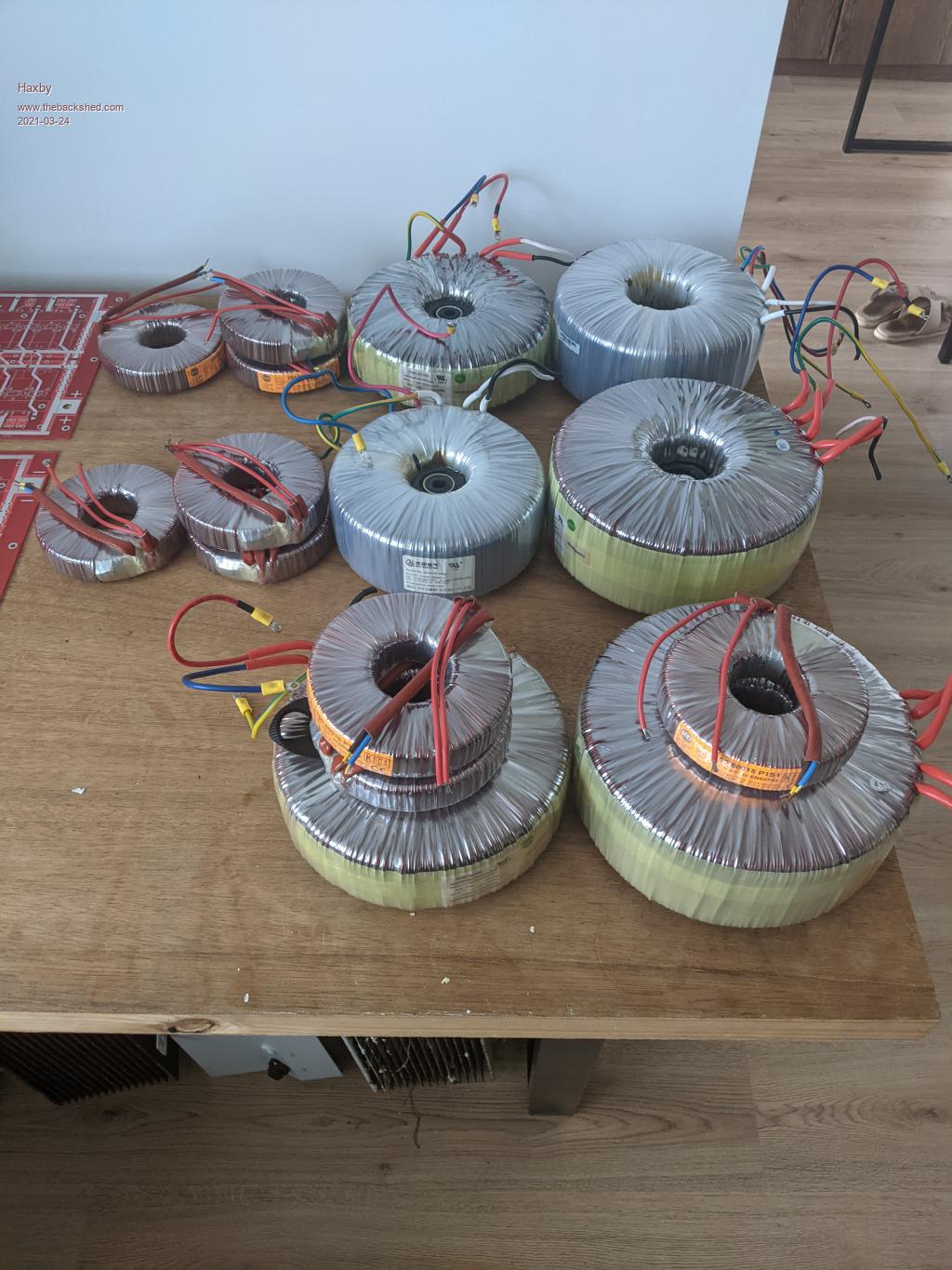

Stacking toroidal transformers on top of each other:
I'm working on the 3 phase inverter and thinking about whether there is any issue in stacking them vertically in very close proximity to each other. See pic where phase 3 (bottom row) is stacked.
Other than heat dissipation, will there be any magnetic fields influencing neighbouring transformers?
