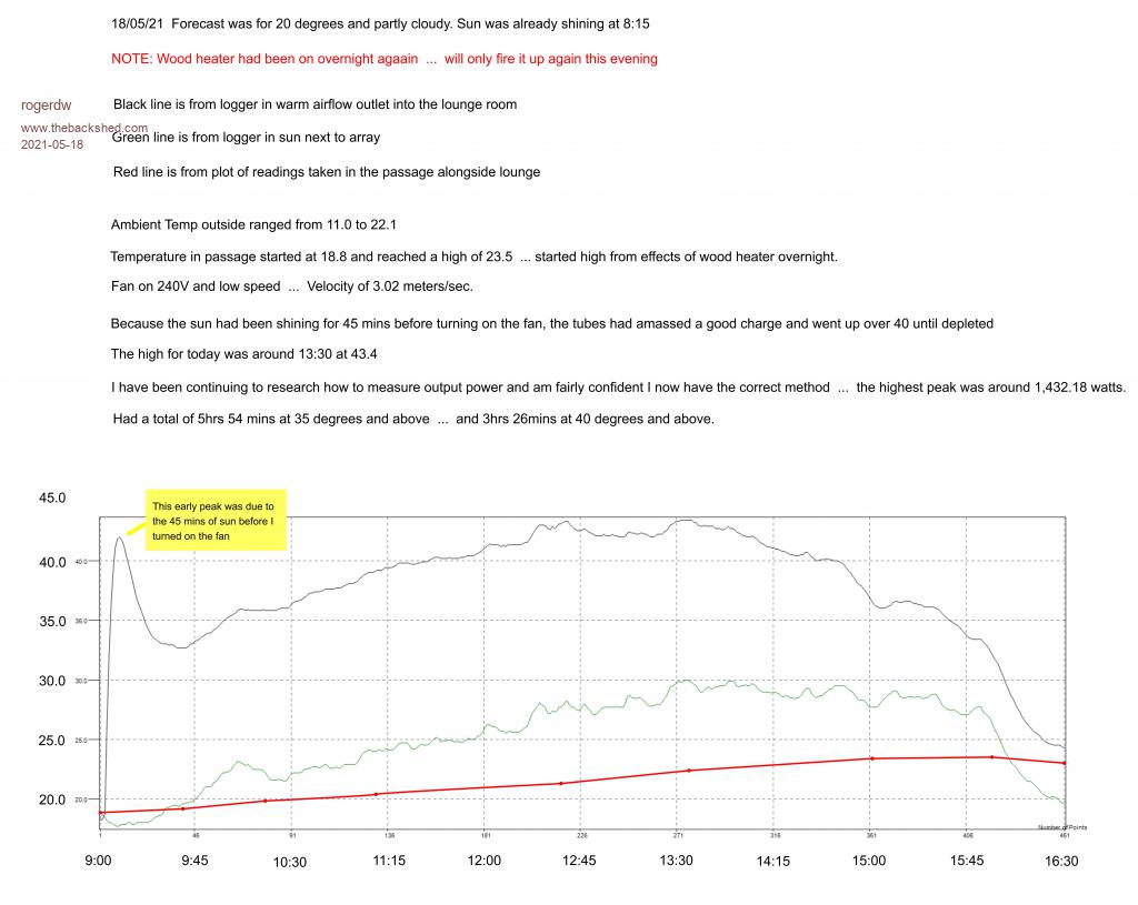

I didn't worry about an update yesterday, though I did keep the data.
Today was awesome, so wanted to share the results.
Forecast was for fog in the morning, then partly cloudy with a top of 20.
I noticed the sun out at 8:15, but didn't want to change the routine and logger charts, so hung off until 9am to turn them on.
If the tubes see much sun while the fan is off  ...  they seem to build up a lot of stored energy  ...  and once the fan comes on, we get a huge inrush of heat until it is depleted. That is clear in the chart below.
Rest of the details are in the image below

Great stuff Roger.
Its going to work a lot better with more tubes too.

Yes, they are really handy in showing info you might otherwise miss.
eg today I had a fantastic output from the device and for so much longer than previously  ...  yet when I went to compare the previous highest output temp, expecting new highs  ...  today wasn't as high as a couple days ago  ...  yet temps outside were higher and ran longer than the other day.
I would really love to have an irradiance meter logging the sun to compare that as well  ...  coz it's not just temperature that warms up these tubes.

Thanks Tony, I'm getting more confident that this is all worthwhile.
In my head I worked out how to put up a system three times the size with 54 tubes  ...  and if I can get triple todays output on good days  ...  I'll be looking for ways to throttle it back.
The next three days are forecast for the same as today but 1-2 degrees warmer  ...  so looking forward to seeing high outputs continue.
In thinking about summer and having to cover the tubes to stop them getting ridiculously hot for no reason  ...  I wondered if I could use the hot air through a heat exchanger and use it to heat the pool. Though that would be a little tricky with the exchanger on the roof  ...  I'd still have to run the pump to get the water up there  ...  which I do already with the existing solar heater.
Pity I didn't start with a water heating system and forego the air heater  ...  though I suspect I wouldn't have started if that were the case. Still feels a bit tricky.
