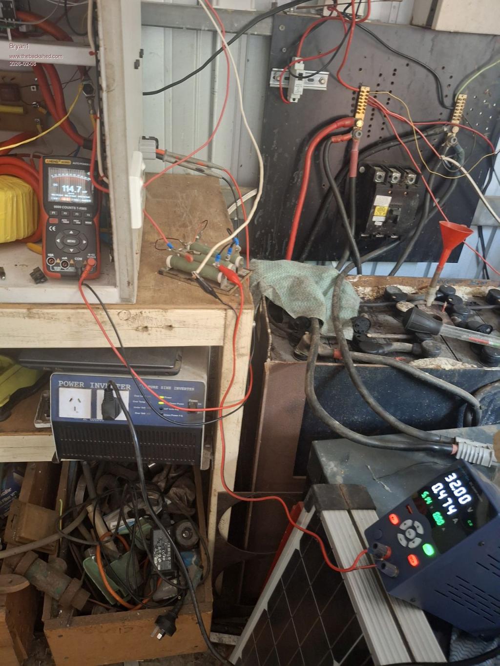

Posted: 06:42am
08 Feb 2026
Bryan1
Ok they do say a picture is a 1,000 words
Now the fets aren't heating up at all but the resistor bank is around 75C
The DMM is connected to the Anderson connector and the input power is coming from the back pads on the under side of the board.
Now just turned it off and decided to put the DMM on resistance and sure enough I do have a short so got some investigations to do to find out where it is.
Now I do wonder if it is the fets as no isolation was done and the fets just went straight onto the heatsinks.
O'well all a learning curve and it does pay to crawl before walking
Edited 2026-02-08 17:00 by Bryan1
Posted: 07:05am
08 Feb 2026
32V / 0.474A = 57.5Ω
57.5 * 3 = 172.5Ω per resistor, so they are not the problem.
Posted: 07:19am
08 Feb 2026
Bryan1
I did do a continuity test between the fet legs and the Anderson connector and both fet legs show the short so more investigation tomorrow when I take the board out.
Posted: 07:33am
08 Feb 2026
If you can disconnect the capacitor bank you can test that and the inverter individually.
Might save dismantling the inverter if the fault is on the cap. board.
Edit.
Ignore above. when I scrolled to the top I see the caps. are on the inverter board.
Edited 2026-02-08 17:36 by phil99
Posted: 07:39am
08 Feb 2026
Bryan1
Phill there are 6 off 10,000uf 63 volt caps on the board between the heatsinks so no way of taking them off unless each are desoldered.
Tomorrow I will take the heatsink off and see if that is the issue and have a real good look to see if there is anything causing the short.
Posted: 09:11am
08 Feb 2026
KeepIS
  Quote  now I do wonder if it is the fets as no isolation was done and the fets just went straight onto the heatsinks.
From memory, if the two short "split heat sinks" mounted on one side of the board are isolated, IE no phyical/electrical connection between the heat sinks, then you can mount the FETS directly to the Heatsinks.
This should be fairly easy to check and diagnose.
