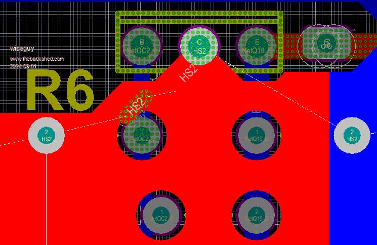

And now for a giant serve of humble pie. I had a niggling thought could I have made a mistake, no don't be silly! I made a mistake once it was a Tuesday - I thought it would rain but it only sprinkled .
I decided to re-check the files that I sent to JLPCB and did a design rule check on them and was instantly rewarded with an error!! Crap it was me all along this time.
I used a ground-plane to connect some points that were previously joined with a track.
Then I deleted the track but a small segment obviously did not delete and caused the short. I have a rule to always run a DRC check no matter how small the change I make. Somehow I either did this but the track segment was moved when looking around/checking and I did not notice it or I forgot to do the DRC check. Here is a picture where you can see the offending track segment.
Sorry - there will be no replacements coming you will have to do the surgery
At least I found it and owned up and apologised to them before they investigated it.
Edited 2024-09-01 12:10 by wiseguy
Posted: 02:28am
01 Sep 2024
Bryan1
I checked mine just now and yes R6 was shorted so gave it a scrap but still shorted, measured the hole and found a 1.2mm drill bit so put that thru and with another light scrape problem fixed and the underside track to Q20 is still valid.
Regards Bryan

Posted: 04:17am
01 Sep 2024
KeepIS
I guess as a last resort, it should be easy to just drill out the through hole and solder R6 between HS2 and base of Q20 or 6,7 of OC2 or some variation.
Just a minor hiccup really
Posted: 05:55am
01 Sep 2024
  Quote   it should be easy to just drill out the through hole
You don't need to drill all the way through, just that copper layer as you would do with stripboard tracks.
A 1/8" drill (or perhaps a little bigger in this case) held in a Bluepoint connector and twist by hand. No risk of going too far then.

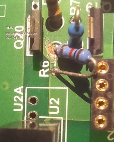

Posted: 07:42am
01 Sep 2024
mab1
not a problem. I used a soldering iron to raise R6 a mm without actually removing it, then bent it to one side. Tried my usual track cutting tool (end tooth on a junior hacksaw blade) but the pin through its end blocked that (Q20 too close), so just used the tip of a needle file.
Not pretty, but once R6 is back in position who's going to see it?

Posted: 01:03am
06 Sep 2024
KeepIS
FYI Found a quick neat method to remove the short on R6 on the top of the PCB that works for me.
It took all of 3 seconds, I just used a small drill bit held between my fingers to remove the top through solder pad, it also removes the copper that projected into and shorted the top pad.
IMHO it does not compromise the solder connection on the bottom of the PCB, and from my perspective the board is now 100% perfect.
Anyone who has worked with Veroboard would be familiar this, twisting a small drill bit between you fingers to neatly cut the copper tracks.
R6 solders in perfectly of course and no more short, the mod is virtually invisible, no scrape marks or slip marks.
I've just started building two more power boards and was going to use two V1 boards, but I suddenly thought of this, tried it, and it was so simple and neat that I will be using this V2 board and one V1 board.
EDIT: Reading back phil99 mentioned something similar, his mention of Bluepoint connector threw me and it didn't register..

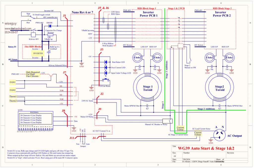

I am still busy building up my inverter and now I have got to the wiring up stage, it is the right time to properly draw up the overall schematic.
So below is the schematic showing the first and second stage wiring overview. The division between a single stage inverter and the added parts for the second stage has been highlighted with the green dividing line between the two stages.  Gee it looks simple enough to also add a third stage
In building up my 2 stage inverter, I have decided to start with the simplest implementation for it. I will not be providing for all the separate input DC peak hold & DC & AC overcurrent trips for each of the stage1 & stage2 that KeepIS has done.  Time will tell if these are needed (I am hoping not).
Maybe I might add just the one input DC current sensor for the main input current peak hold & over current trip circuitry already provided for on the stage 2 switching PCB.
Not sure of the picture resolution so I have a PDF below it for best quality.
12KW 2Stage NanoR7 Auto Start.pdf
Edited 2024-09-07 14:25 by wiseguy
Posted: 07:13am
07 Sep 2024
KeepIS
Diagram looks nice, sure looks simple to add the 2nd or a 3rd stage
I agree that some of the extra monitoring may not be needed, and of course in time I'll at least get a good idea.
I muse apologize for not testing the 2Stage circuit yet, I know it's going to work though.
Instead, I spent yesterday afternoon and today building two new Power boards with all ferrite beads and the included late suggested changes, I just finished them now.
I feel that a second AC over current sensor with a burden resistor and adjustment pot fed into the Ext input might still be a good idea though, otherwise the AC over-current value from the main AC feed will remain the same for both 1 or 2 stages powering the load.
I guess it depends on how you are planning to set the one AC over-current value.
Maybe limited to what a single stage could safely handle and trip at, and just use the second stage to share the load and keep things cool at higher power levels?
_
Posted: 08:52am
07 Sep 2024
wiseguy
  KeepIS said  Diagram looks nice, sure looks simple to add the 2nd or a 3rd stage
Yes I do agree, I was wondering if I could use the spare wire on the 8 way opto cable to  feed back a signal from the second stage controller to reduce the sensitivity of the latch input using a small signal FET etc and thereby effectively doubling the current trip point, without upsetting the output current readback calibration.  Still throwing around ideas but I am just wanting to get it running  at this stage and tidy up the loose ends later.
I will probably end up hacking that current sense circuitry corner from a new PCB and mount it on a spacer, not too unlike like what you did for the peak meter lol (I did notice).
Edited 2024-09-07 18:53 by wiseguy
