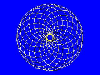

javavi
SinePoly
MODE 2
Dim integer xp(255),yp(255)
Dim integer s(255),c(255)
r0=63:a0=0:b0=0
di=217:db=1:da=1
For i=0 To 255
s(i)=Int(r0*Sin(i*Pi/128))
c(i)=Int(r0*Cos(i*Pi/128))
Next
si=220
Inc di:Inc si,-di
If di=220 Then di=0
If di=0 Then
 db=(db+1)And 255:si=(si+1)And 65535:Inc di,2
 Do : fc=Int(Rnd*16):bc=Int(Rnd*16): Loop While fc=bc
EndIf
a0=(a0+2)And 255:b0=(b0+2)And 255
a=a0:b=b0
For i=0 To 255
 x=(si*c(a)+c(b)*di):y=(si*s(a)+S(b)*di)
 a=(a+da)And 255:b=(b+db)And 255
 xp(i)=160+x\128:yp(i)=120+y\128
Next
CLS Map(bc):Color Map(fc)
Polygon 256,xp(),yp()
Pause 20
Loop While Inkey$=""

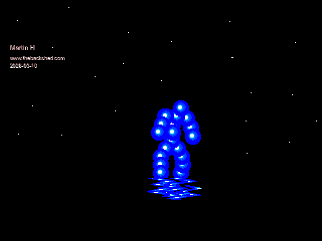

A small old demo that I wrote about 35 years ago in GFA Basic on the Atari ST, converted here for PICOMITE VGA/HDMI.
' Vectorball by Martin H. 1991-2026
Dim x1(20),y1(20),y(20),coor%(20,4)
FRAMEBUFFER create
FRAMEBUFFER layer create
init
FRAMEBUFFER write f
co%=0
For f=0 To 359 Step 10
CLS
 p=f+4
 p1=f+8
 p2=f+160
 For n=1 To 20
   x1(n)=160+coor%(n,2)*Sin(((f+coor%(n,3))/180)*Pi)
   y1(n)=(coor%(n,2))*Cos((f+coor%(n,3))/180*Pi)
 Next n
 For w=25 To -25 Step -1
   For n=1 To 20
     If Int(y1(n))=w Then
     Sprite write 1,x1(n) , 100+coor%(n,1)
    EndIf
   Next n
 Next w
schatten
 Inc co%
FRAMEBUFFER write n
Sprite scroll -1,0
FRAMEBUFFER write f
' page copy 1,0
FRAMEBUFFER copy f,l
Next f
Sub schatten
'water reflection (kind of)
 For fx=0 To 23
   l0=7*Sin(((fx+co%)/3.5)*Pi)
 Blit 130,164-fx*3,130+l0,177+fx,64,1
 Next fx
End Sub
Sub init
CLS
For l= 1 To 70
Pixel Rnd*320,Rnd*180,RGB(white)
Next l
 Restore coords
 For f=1 To 20
   For n=1 To 3
     Read coor%(f,n)
   Next n
 Next f
 Restore BLL
 Open "ball.spr" For output As #1
 For f=1 To 17
 Read a$:Print #1,a$
 Next
 Close #1
Sprite load "ball.spr"
End Sub

Data "0111111991111110"
Data "0111111111111110"
Data "0011111111111100"
Data "0001111111111000"
Data "0000011111100000"
Back then, I had to cache all the frames, but today, on the Pico, it runs in real time.
Have Fun
Martin

I got
[39] Blit 130,164-fx*3,130+l0,177+fx,64,1
Error : Not enough Heap memory

Posted: 04:44pm
10 Mar 2026
Martin H.
Sure, the program uses all 3 screens, but the difference between our systems doesn't seem that big.
  Quote  PicoMiteHDMI MMBasic USB RP2350A Edition V6.02.01RC1
OPTION SERIAL CONSOLE COM1,GP0,GP1
OPTION FLASH SIZE 4194304
OPTION COLOURCODE ON
OPTION KEYBOARD US
OPTION RESOLUTION 640x480 @ 252000KHz
OPTION DISPLAY 30, 53
OPTION HDMI PINS  1, 3, 7, 5
OPTION MODBUFF ENABLE  192
OPTION PLATFORM OLIMEX USB
  Quote  Program:
  2K ( 0%) Program (108 lines)
182K (100%) Free
Saved Variables:
 16K (100%) Free
RAM:
  3K ( 1%) 16 Variables
  0K ( 0%) General
227K (99%) Free
I can only guess, since it doesn't cause any problems for me.
Make sure that you are in Mode 2
in mode 1 I get the same message
so simply add a MODE 2 at the start of the Programm
Edited 2026-03-11 03:27 by Martin H.

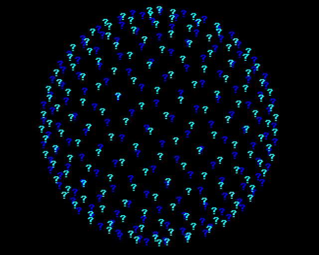

Posted: 05:23pm
17 Mar 2026
javavi
The Sphere of the Question
MODE 2
CX=MM.HRES\2
CY=MM.VRES\2
N=314:F=1
FRAMEBUFFER CREATE
FRAMEBUFFER WRITE F
CLS
For P=0 To N
 Y=1-2*P/N
 R=Sqr(1-Y*Y)
 T=F*P
 X=R*Cos(T)
 Z=R*Sin(T)
 If Z<0 Then Color RGB(Blue) Else Color RGB(Cyan)
 Print @(CX+X*CY,CY+Y*CY) "?";
Next
FRAMEBUFFER COPY F,N,B
Pause 50
Inc F,0.001
Posted: 09:05pm
18 Mar 2026
Looks nice! Thanks.
