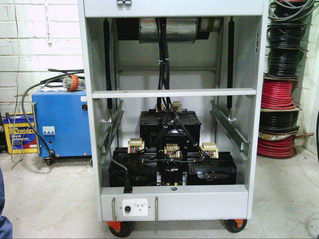

There should not be any external fields worth worrying about, and stacking them pyramid fashion makes perfect sense.
Some kind of soft spacer may be a good idea to prevent bruising of any high spots on the windings.
These usually come with a "mounting kit" that includes some flat rubber washers, round steel end flanges, and a bloody great bolt.
My own preferred method would be to mount the toroids pyramid fashion onto a heavy (6mm?) steel plate secured with some all thread right up through the middle, and fit four castors.
It can then all be moved around fairly easily.
That is basically what I did, my outer cover being a resurrected two drawer filing cabinet turned around backwards, so its fully open at the rear.
Another successful method to house very heavy transformers would be to buy an old antique buzz box stick welder, and throw away the guts. That leaves a very robust one foot cube metal box, with ventilation louvers, two wheels and a handle.
See the blue box in the picture.  That is now a 5Kw three phase dc rectifier with three stacked toroids inside.

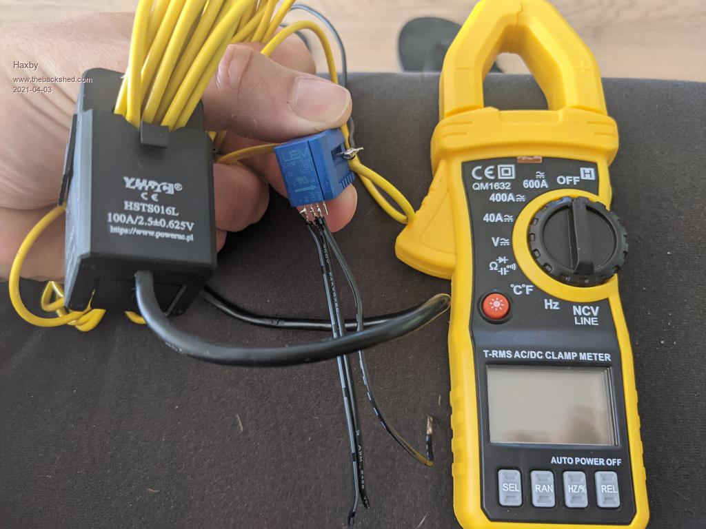

I bought a clamp meter but unfortunately it doesn't have a max-hold feature. Not sure if I would trust it to be responsive enough anyway. I also bought a HSTS016L hall effect clamp rated at 100A, but the analog output seems very noisy as displayed on my oscilloscope. It has a +-600mv output referenced to its 2.5v reference pin. I connected that ref voltage and the analog output to my oscilloscope and then used the math function to subtract the ref voltage from the analog out voltage. The noise is pretty bad. Unworkable really. I've been powering it from the oscilloscope USB output. Maybe it needs a smoother power supply. I'll keep experimenting tomorrow.
Finally I tried the 15A rated LEM sensors that I de-soldered from the DC side of an Aerosharp board, but I can't get that going at all.
These LEM current sensors have 4 wires.
Ground, 5V, output, and reference.
Give it 5V on 5V pin, with the supply going to ground pin.
Now measure the output relative to the reference pin.
The reference pin is internally pulled to 2.5V.
And the output is driven relative to that.
So put the DSO ground clip on "reference" pin and the DSO signal on the output.
From the photo above the pinout is
from left to right
5V, ground, output, reference.
The output will not make much sense if you measure it with respect to ground.
It will always be something like 2.5V
This is by design.
These devices are nice, they allow isolated current measurement with 5V supply.
I can't quite tell from the photo but it might be a CSR 15 which means it gives
an output of 2.5V with a bipolar output adding or subtracting from the "reference" 2.5V with a gain of 41.7mV/Amp
It does not go rail to rail, i.e. output goes down to ground or up to 5V.
There is a limit.
If it's the CSR 15, then it can measure +/- 51 Amps or
+/- 2.127V relative to the "reference" pin, which is 2.5V
So the output would go from 0.37V up to 4.63V for the -51 Amps to +51 Amps
If the part is a CSR 6, then the measure range is smaller but with better resolution.
It has 104.2mV / Amp gain but same deal for output.
It's all relative to the "reference" pin.

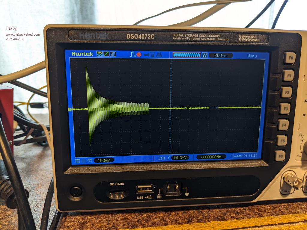

Ok a 100A to 20ma current transformer was delivered to me today.
I set it up on a cut extension cord with a 10 ohm resistor across DSO probe, parallel with the CT output. Just a single loop of active wire went through the centre of the CT.
So v=IR
200mv=10ohm x 20mA
So 100A full scale should be 200mV on the oscilloscope. Right?

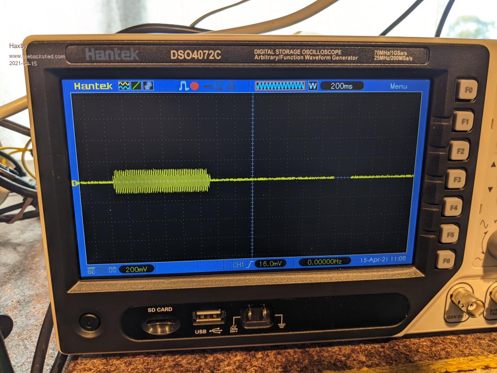

Well that's not at all what I get.
First a 2000W cheap heater:
My clamp meter shows 8.6A which is close enough to 2000w so I trust it's accurate.
The DSO shows around 120mv peak, so around 80mV RMS.
Why the huge discrepancy?

Here is the 2000w AEG brand belt drive 50L air compressor starting up. Looks like around 50A peak:

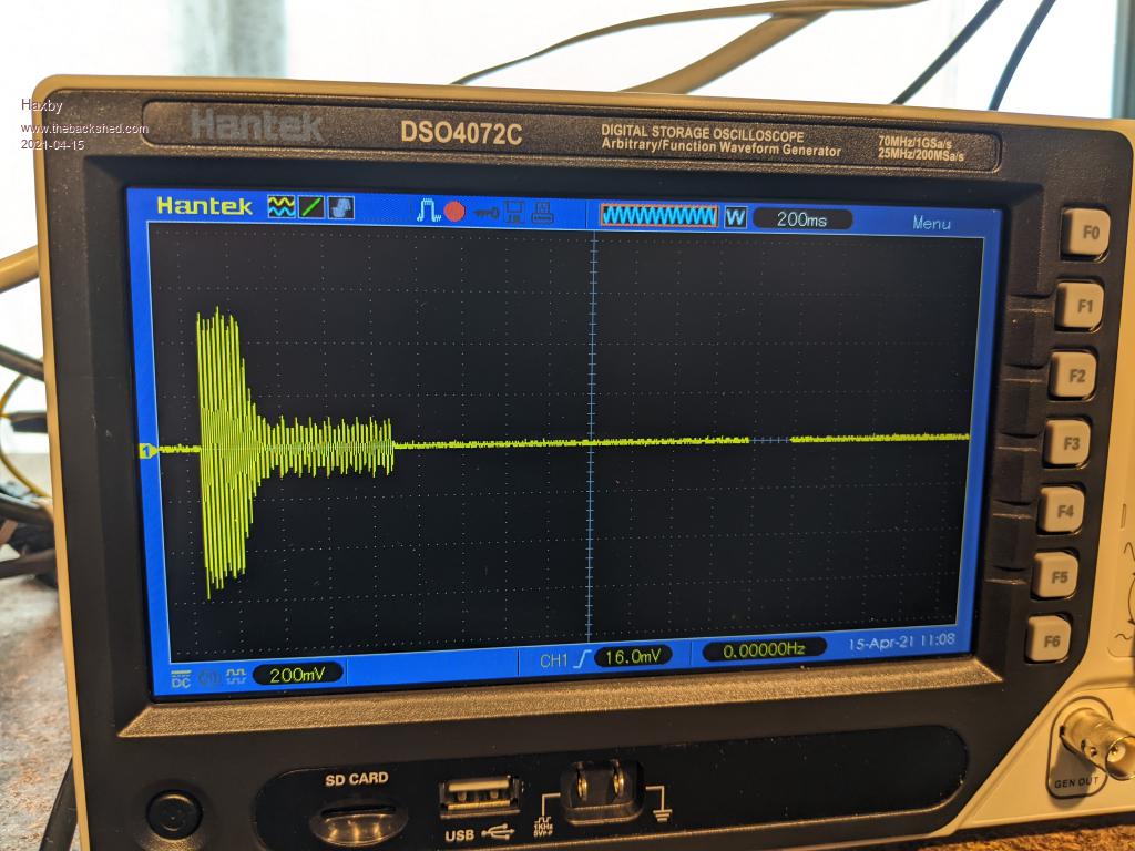

And here is a miter saw spinning up from standstill. Woah, 70A!
Edited 2021-04-15 15:00 by Haxby

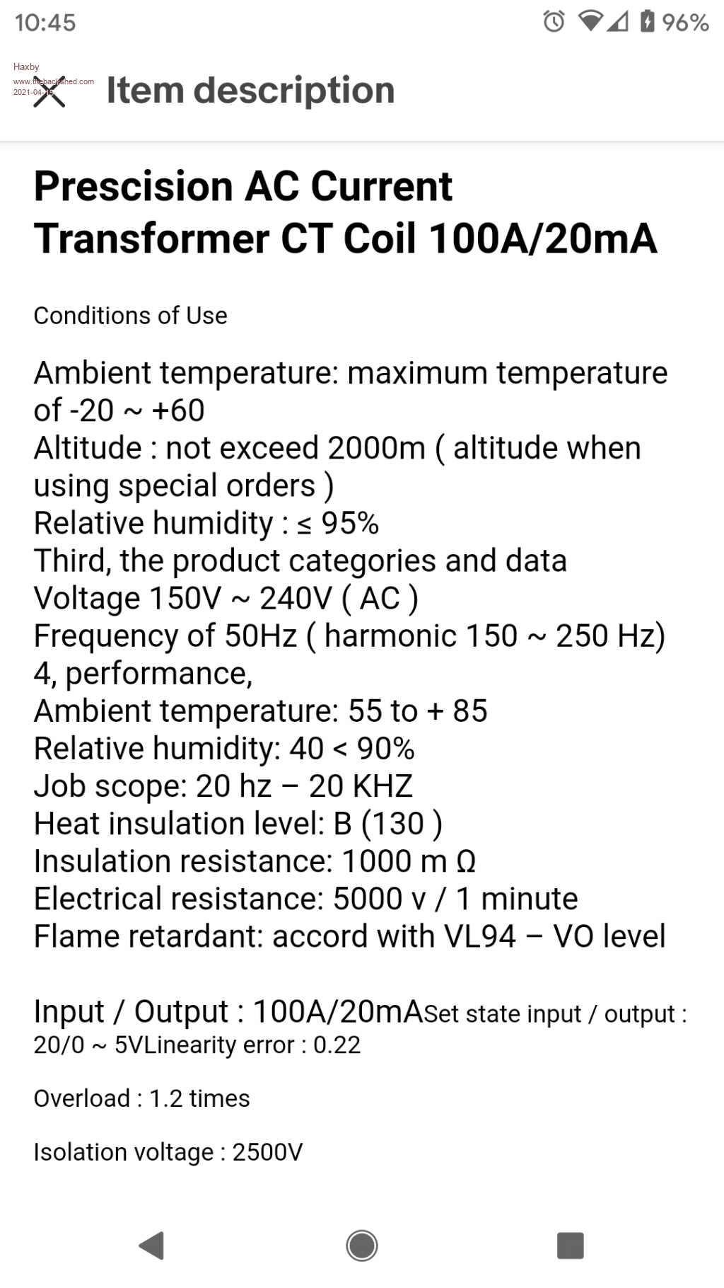

Here is the spec sheet of the CT.

That second picture looks like my refrigerator starting up.
I am seeing 19 amp peak inrush for a 127 watt compressor which does run at half an amp rms after about one second running.

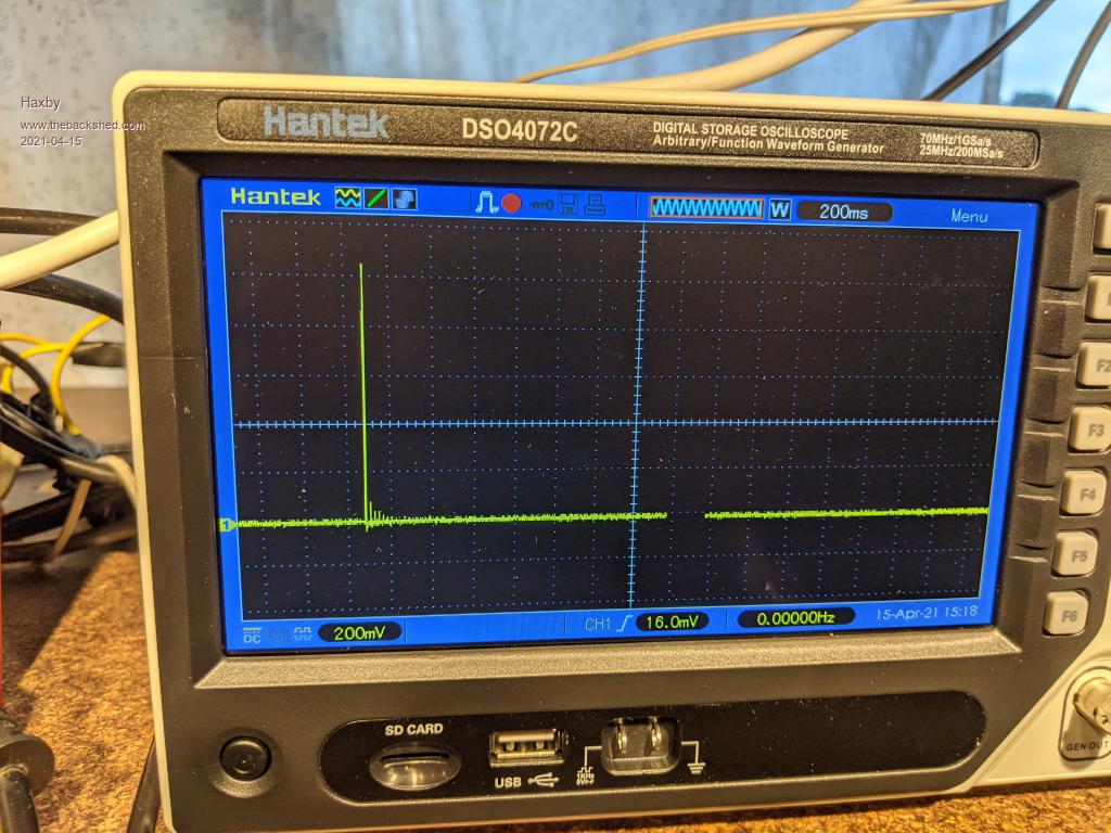

Here is my pesky isolation transformer. It's the one that trips my RCBO sometimes. It needs a soft starter. It draws just over 100A for a very short time.
Posted: 07:37am
15 Apr 2021
Murphy's friend
I just used a relay with suitable N/O contacts that were bridged by a 33R/10W resistor. This was in series with the mains input.
The transformer had a low voltage secondary, rectified & with a capacitor on DC side that powered the relay coil.
The transformer would start via the resistor until the relay pulled in and shorted it out.
