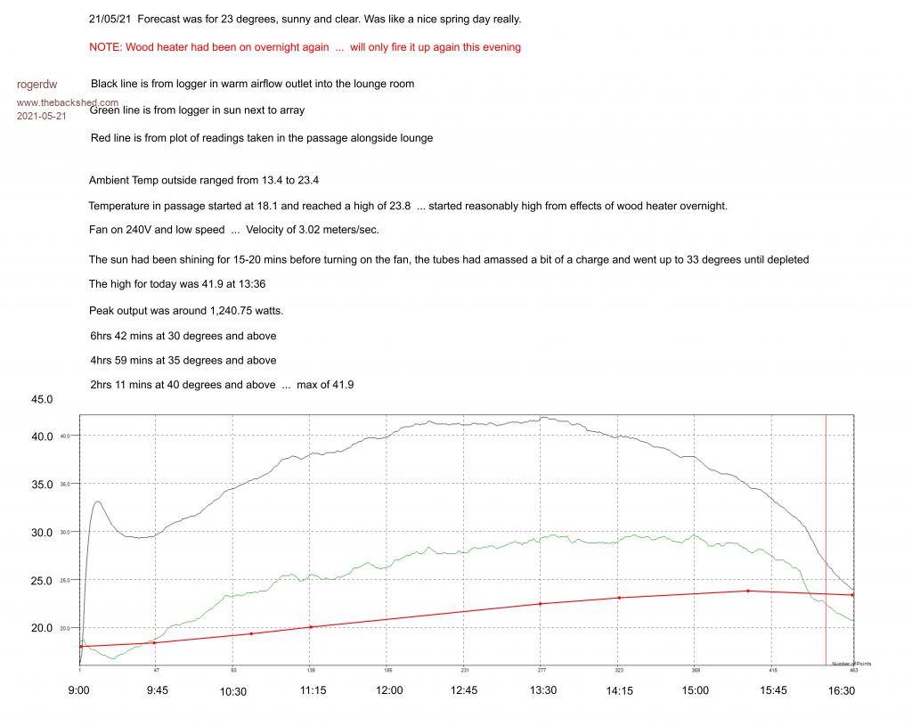

In the mean time, todays results were pretty impressive. Not a record for maximum peak output  ...  but a lot of hours of heat just pumping into the house. Even saw my wife with her jumper off.
Peak output reached 1,240.75 watts
6hrs 42 mins at 30 degrees and above
4hrs 59 mins at 35 degrees and above
2hrs 11 mins at 40 degrees and above  ...  and a max of 41.9 degrees

That is a very encouraging result, considering its still a scaled down version.
It would be interesting to try driving a dc powered air blower direct from a solar panel.

Once the whole mess has reached a stable operating point the heat coming out will pretty much always equal the solar heat going in. And there is not a whole lot that can be done to change that.
And that is quite likely exactly how it does work.
I know that if there's not a lot of sun, the O/P temp drops  ...  and if I reduce the airspeed, the temp will increase  ...  or at least drop slower.
I also know that if the fan is off and the sun is shining  ...  the tubes definitely store heat. Many of my charts show this, in that I have mainly been firing it up at 9am just for consistancy, even though often there is no decent heat gain until 10:30  ...
...  but some days when there's been sunshine before  ...  when the fan is turned on, there's a massive amount of heat pouring out for a while until it is depleted.
That can be a real trap for testing  ...  because it's only after constant airflow for some time that an equilibrium is reached  ...  and from then on the output is in relationship to the current sun level.
Mmmm  ...  and that is exactly what you said above.
  Warpspeed said  That is a very encouraging result, considering its still a scaled down version.
Yes, certainly encouraging, though we're unlikely to get lots of days like this  ...  except for tomorrow maybe  ...  one degree hotter and sunny.
One thing that I noticed on todays chart is that between 13:30 and 15:00 the temp in the sun stayed virtually level  ...  yet the output went on a steady decline from 41.9 - 37.8
I can see a dc blower doing the job. It probably still needs some smarts to decide when it should be allowed to run and when to cut out etc  ...  but the speed could simply be left to the output of a well matched solar panel.
I should be able to log the output power of a panel when my new multimeter gets here, so that will give us a lot more idea.

Your heat input definitely seems to track measured solar pretty well.
A solar panel powered air blower should at least adjust the airflow up and down in the right directions, and start and stop appropriately. I have never seen this done before, but my gut intuition is that it will be dead simple and work very well.
Sometimes the simplest solutions are the best.

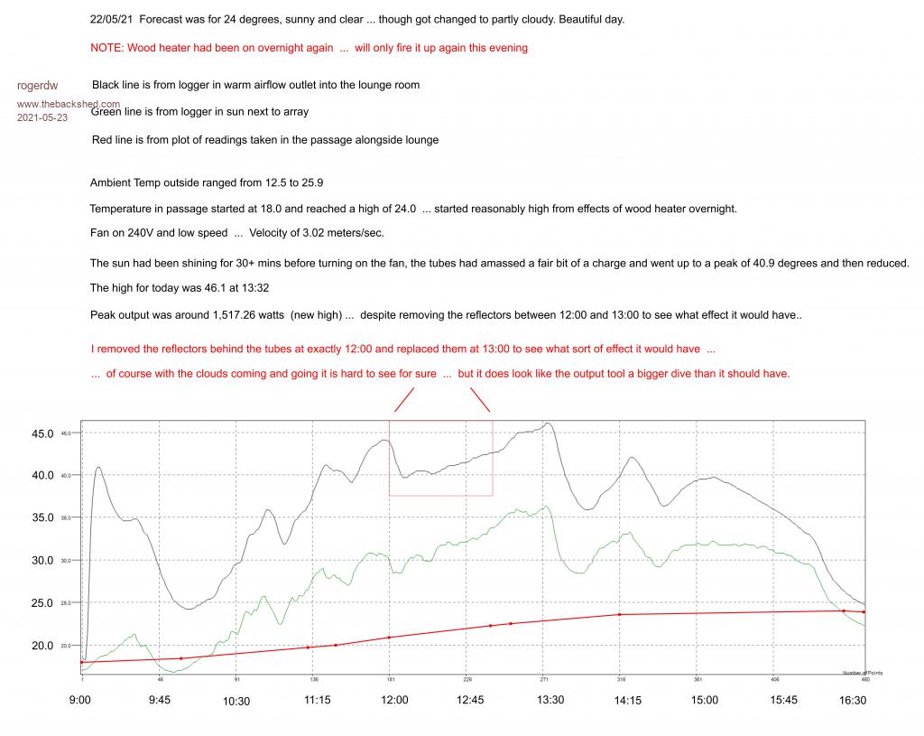

Todays results were interesting. Because of the forecast being similar to yesterday plus a degree hotter I was expecting big things.
In fact we had a high of 46.1 from the outlet and a record instantaneous power output of 1,517.26 watts
Because I was hoping for a very smooth output over the day like yesterday  ...  I decided to remove the reflectors from behind the tubes at midday, when they should be at their most effective  ...
...  and replace them at 13:00.
I was hoping to see a big drop in output temperature  ...  and we did  ...  but the outside temp in the sun also dropped at the same time due to cloud cover  ...  so is hard to say exactly just how beneficial the reflectors are.
Maybe someone else can interpret the chart to offer some insight.

  Quote  I was hoping to see a big drop in output temperature  ...  and we did  ...  but the outside temp in the sun also dropped at the same time due to cloud cover  ...  so is hard to say exactly just how beneficial the reflectors are.
You probably need to run the test multiple times and when the conditions are more stable to get an averaged meaningful Result.
Posted: 10:24pm
22 May 2021
Agree, its up and down all over the place, difficult to see anything definite.

rogerdw
You're right. Just my lazy self was hoping to get the answer in one easy test.
If today looks a bit more even, I'll perhaps try it again. Forecast calls for 'high cloud' and sunny. Just no cloud for an hour over lunch would do it.

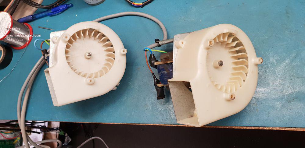

I've got a few other experiments in mind. I cleaned and wired up a couple of identical fans that I saved from wrecked microwaves years ago.
240V and 35W  ...  and with a roughly 9.5 meters/sec airflow velocity. I'll work out the cubic meters/min when I do the tests.
