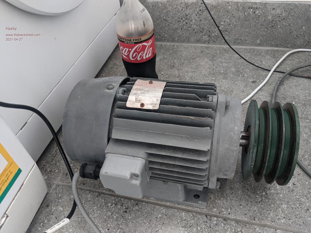

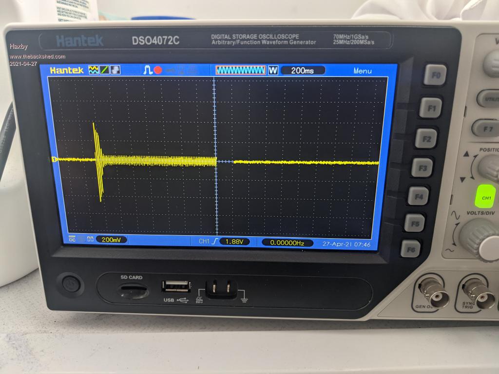

To complete my startup current "research", I bought a 2200w 3 phase motor with a decent flywheel attached. One day I'll use it with a VFD for a car turntable project I'm contemplating.
It really jumps when turned on. No VFD or anything. I expected the startup current to be very high, but it's not too bad at 45 amps or so (per phase):

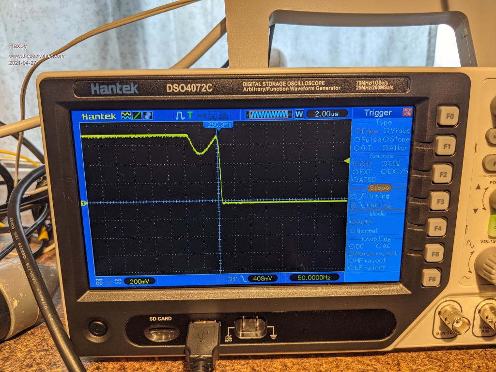

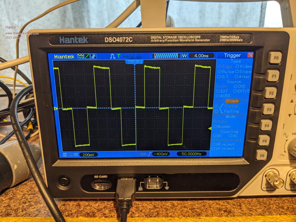

Here is my large inverter square wave output, measured with transformer connected and a 70w load. Measured through a HV probe:
But zooming in, there is a dip in the falling edge of the square wave:
Is there any problem with it looking like this?
I think it might be the reason my transformer is buzzing.
The dip doesn't occur in the rising edge.
Maybe I should decrease the size of the dead time capacitor? I think the dip occurs when the inverter output is floating. Which is around 2-3 uS.

Maybe a clue:
The dip and the buzzing noise start to occur after the DC input voltage goes over 200v. The DC voltage was about 350v when the photos were taken above.

  Haxby said  Paging Warp:
You rang ?
That glitch is only a few uS, and its probably due to dead time, and unsymmetrical because of residual flux in the core. Nothing to worry about.
You will probably see a few weird things until you get all four inverters running properly together.

It could well be Phil, I really do not know the answer to that.
You used commercial transformers which will operate at a higher flux density than is really ideal for an inverter, and that may have something to do with it as well.
I used commercial toroids in one of my earlier Warpverters, but I am pretty deaf and would probably not have noticed the difference anyway.
If its really a problem, you could package all your toroids into a pyramid shape, and sink it in a bucket of automatic transmission fluid. That should shut it up, and also increase the overall power rating by a LOT.
Its a bit messy though, although once the whole thing is proven, the transformers should last a lifetime without any need for maintenance or repair.

Ok I'll decrease the dead time and see what happens. I should be able to halve it without any adverse effects.

Ok I changed the 10nf dead time cap to a 4.7nf cap.
Dead time decreased and the square wave looks much much better but there is no change to the buzzing.
I fear that the buzzing will wear out the enamel insulation after some time. As Roger noted, these aerosharp transformers haven't been wound with much care at the factory.

As it made no difference it may be safer to go back to 10nF.
A very few additional microseconds of dead time in a 10mS waveform is negligible, almost nothing.
But if you set the dead time a whisker too short and start getting shoot through, that would be ultra bad.
Its probably not the windings that are making the noise, but the actual core material itself.
Magnetostriction causes the crystals in the metal to change shape. Its kind of like the piezoelectric effect.
If you have ever run the choke saturation tester, and wind up the wick, the core can really whine or growl at you surprisingly loudly.
