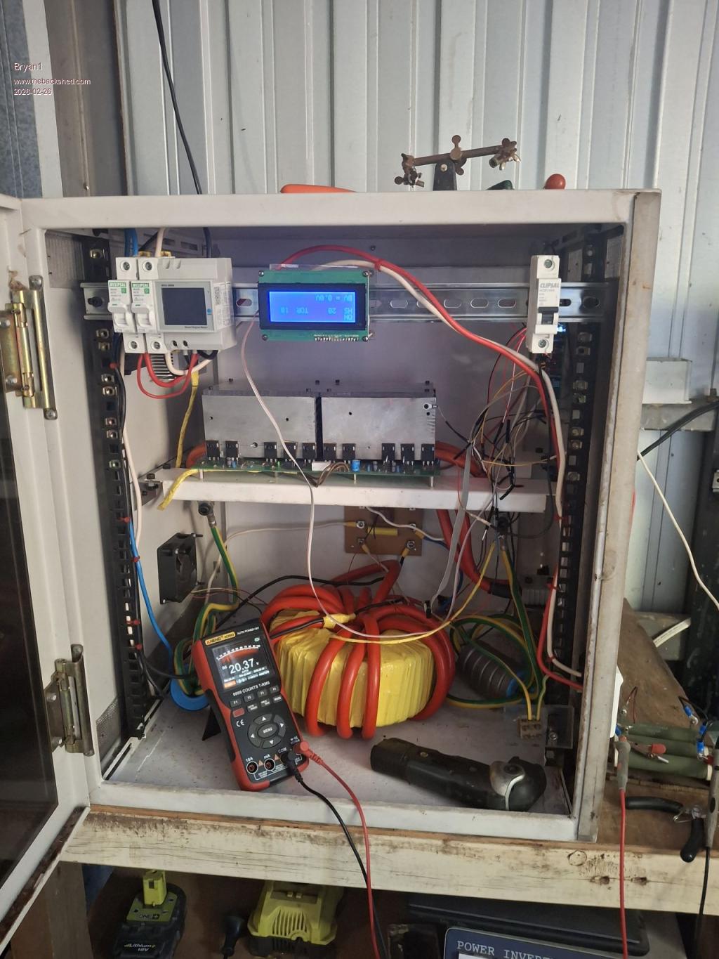

Well as I finally got the nano programmed I put it back on the board and made some jumper wires so I could check with my scope.
Well on the first test no switching just low voltage static and tried the other tests and it does look like the IR2184 fet driver chips are toast. So got onto digikey and order half a dozen of them and to get upto free shipping got a decent set of side cutters
Decided to probe the board again and found the electrolytic caps are goners too so I will replace all of them too. I unsoldered the 4.7uf cap which was right next to that Vbat rail and just got a dot showing when I tested the cap with my DMM.
The 5.1 volt zener and other diodes all test true so looks like they survived.

Posted: 06:51am
26 Feb 2026
Bryan1
OK got it all setup with the ribbon cable connected and the DMM stayed on milli volts so turned it off straight away and took the ribbon cable off.
So yes the lcd is upside down   and tomorrow the power board is coming out to find where the problem is on that.
It good to see the LCD and brain board working so thats just the power board to sort out now.

Posted: 10:36pm
26 Feb 2026
Bryan1
Ok another day to try and sort this out
So the 240 volt AC side does show a dead short and as we can see in the photo above with the output from toroid the white wire go straight onto the AC board where the black wire goes thru the hole of that energy meter then onto the other side of the AC board. Which naturally would show a dead short as a single wire is used.
Checking my first inverter build the AC board is the same yet when connected it does startup ?
So looks like I need a hard lesson on the output side of this inverter as I am sure it is the problem
Regards Bryan
Posted: 11:41pm
26 Feb 2026
The 240V winding of the TX will have a very low resistance. Is that what you are measuring?
Disconnect the 240V winding then separately measure it and the rest of the 240V circuit.
