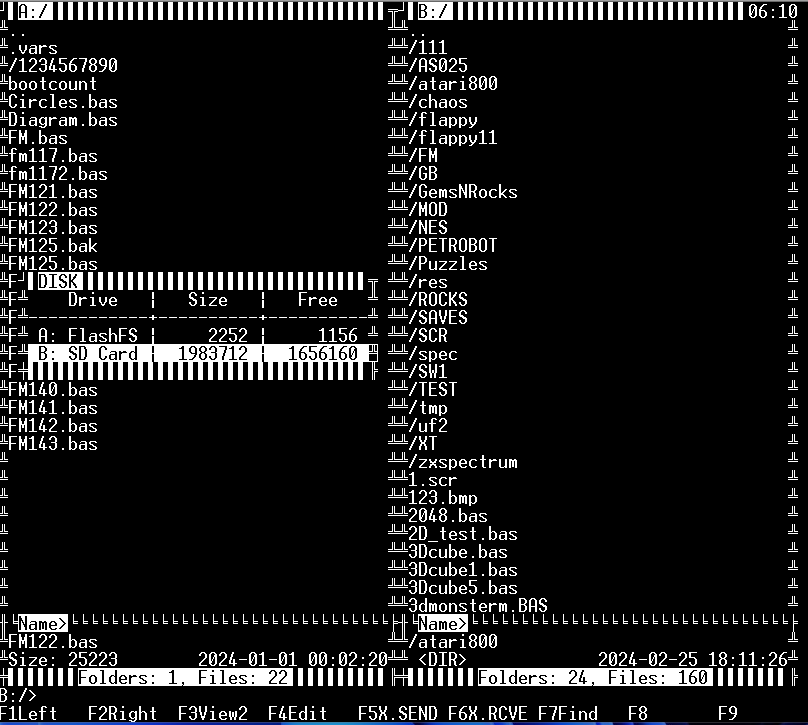

I have now completely abandoned the use of tiles in the working version, and the cursor works both on the local monitor and in the terminal. But if I replaced the "Terminal" font with a font with the encoding like PicoMite, then it would look just as correct in the terminal, only not colored.
Now, due to the mismatch of encodings on the terminal, it looks like this:
Vadim

  thwill said  In Linux Putty you could try changing "Window->Translation->Remote character set" to CP852 as that code-page (amongst others) contains the line drawing characters.
My 2 cent: if you use a font which makes re-configuring/changing the default necessary, that will be not helpful for many. The first impression with a default setup for putty or terraterm will be disturbing like the screen..
If characters > 127 are used is really a point, which could be made configurable like Twofingers did. Please stop hardcoding :))

Useful fonts that use the line drawing characters are
Courier New - which comes with Windows
Lucida Console - later Windows and
Ubuntu Mono - which is readily available.
Posted: 07:22am
01 Apr 2025
Or put a font with line drawing characters into the Library?
Posted: 07:28am
01 Apr 2025
Font 1 has line drawing - CHR$() codes below

I should have been clear. I was suggesting fonts to use in your PC terminal program to match the line drawing in pico font 1
