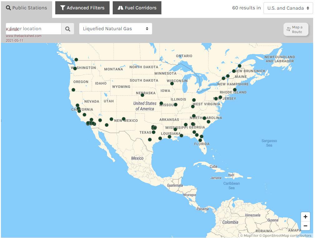

Well, we're in NA. There are not many LNG stations around, but they do exist.
"Natural gas costs significantly less than gasoline or diesel per gallon. For example, the average pump price at utility compressed natural gas stations was $2.37 per gallon in February, whereas the average cost of gasoline in California was $3.24 per gallon, and the average cost of diesel was $3.73 per gallon, according to the Energy Information Administration."
https://afdc.energy.gov/stations/#/find/nearest?fuel=LNG

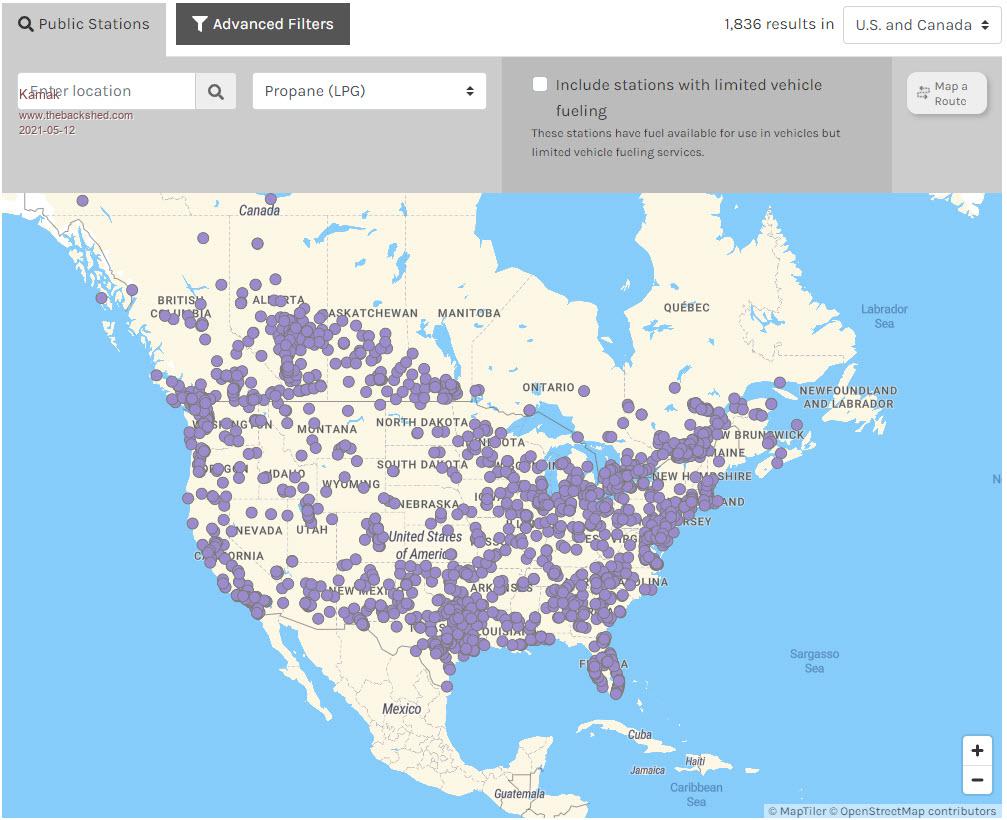

In NA, those filling stations are liquid natural gas, not LPG (propane). Propane is sold in a lot more retail stations. I'm pretty sure those LNG stations are for commercial fleets. LNG is real high-pressure Liquid Natural Gas and is not liquid propane LPG or butane. The LNG tanks in vehicles here are high compression liquified natural gas tanks LNG.
Taxis in North America still do or did a lot of fleets on LNG, LPG, and now electric.
This is the LPG Propane map of NA. Much more, obviously.
https://afdc.energy.gov/fuels/natural_gas_locations.html#/find/nearest?fuel=LPG

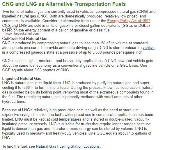

On second look, you're probably right about the inference that "most" vehicles use CNG as opposed to LNG, as this additional information states that, for the most part, the LNG here in NA is for medium to large trucks going long distances. Taxis must be using CNG. Not to say we couldn't get our hands on LNG for I.C.E. generators.
Cheaper: Fuelling up with LNG costs about 40 percent less than diesel.
https://www.tranbc.ca/2012/07/17/cast-of-b-c-players-fuelling-natural-gas-trucks/
