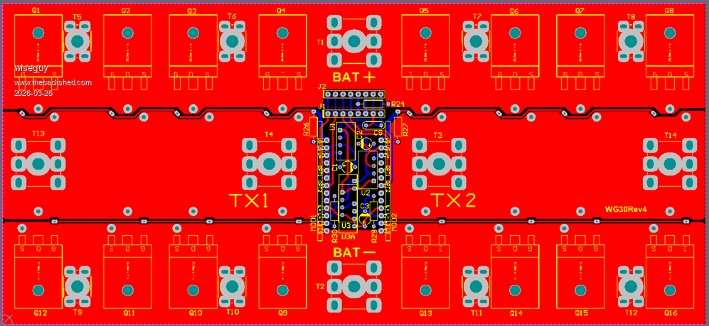

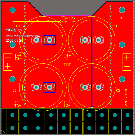

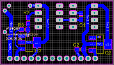

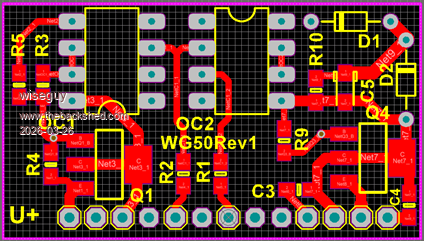

In the background I have been mulling over the current WG inverter design. Despite being on holidays travelling, sightseeing etc things of a technical nature are never far from my mind.
The main gripe was having to do a 3D leg bend on the upper Mosfet drain legs to accommodate a ferrite "bead".  During the design I thought only the lower FETs were affected but after testing the new PCB board it helped to have the beads on the upper FET drains too.
A solution to this issue needed a slab of uninterrupted design time for me to engineer a solution.  In my next post I will present some pictures of the changes that I have incorporated into the new power PCB design.
The board dimensions have changed (shrunk) from 18 x 36cm to 18 x 33.6cm.
The previous real estate used for the opto couplers and through hole parts has shrunk and instead there are 2 rows of pins for a small vertical sub board for gate drive on each side central to the power PCB.
The sub board has the 2 optos (DIP or Gull wing), gate drive buffer transistors x 4 (SMD) and ~ 13 other 0805 SMD parts, 2 of these PCBs are required. I have tried to avoid SMD parts in the past but these small modules are relatively easy to assemble even with tired eyes and the buffer transistors are only available in SMD now anyway, at least they are the larger SOT223 packages and not SOT 23's !
The small DC/DC converters are mounted central to the power PCB, between the two vertical module PCBs. Note the modules are intended to be soldered, using sockets here by all means do so but at your own risk - I don't recommend it!
The choke heavy duty connectors can either be soldered near the centre of the power PCB or to the outer edges. The Capacitor PCB are able to be rotated 180 degrees to suit either location. Note the new Cap boards no longer have a rectangular notch out for the choke connectors but a wedge shape leaving more current carrying copper on the PCB. The old Cap boards can be re-used but if reordering boards the new ones are recommended.
I have altered the Upper Mosfet leg bends required to simple 90 degree bends. The PCB Drain hole allows up to a 6mm "bead" to be used with no issues. The resulting lead bend changes means the gate trace now meanders a bit and is no longer a straight line. The gate trace looks a bit narrow, but it now has a second parallel trace on the bottom layer.
The result is that the high current paths for all the FETs travel from ~15 to ~20 mm less PCB trace distance to the high current connectors too.
The only catch here is that I have no plans to order any PCB's for myself at this stage. I am content to use the boards I currently have. The small gate drive modules have been tried and tested on my 12V inverter design and are therefore proven. The Power & Cap PCBs have not been tested but I am confident they will work first time as all previous boards did too (except for a small trace glitch on Rev3.... easily fixed).
Apart from a simpler FET lead bending regime, drilling the FET holes for screw mounting to the heatsink are very regular spacings, ie 22mm, 30mm and 48mm. If you use two aluminium bars as I do, easy! However if you mount the PCB straight to a heatsink face the two rows of holes are spaced apart by 86.6mm so in my case S.E.P.
I am just offering a second choice that simplifies the assembly a bit for any bulk orders that may be currently under consideration.

The power PCB:
Cap PCB:
Half Bridge Module, front & back
sorry for the slightly different sizes for front and back designs....
Edited 2026-03-26 14:18 by wiseguy

I really do like this final refined board layout
