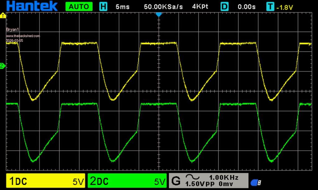

  Bryan1 said  Ok with this wet weather got the noise of my genset going to charge the shed battery.
Anyway powered up the controller board and measured 17.8 volts on the 18V zener, now when the ohm meter is used the Vbat + and VBat - are shorted out. Doing an ohm check on a few fets shows the gate is isolated and the source and drain pins are a dead short, so would this mean the fets are gone?
Anyway setup the scope and got a pic of the L01 and L02 first test
Regards Bryan
Your scope H setting should be in the milliseconds and not nanoseconds so that you can display at least 3 cycles of 50Hz.

Bryan1
Any finally noticed that cable on the avrdude was a 10 pin one   just long enough to reach the power board so gave it a test.
So the BV is working and showing the same voltage as my old fluke scope meter and I tried first @ 24 volts and 200mA where the BV stopped at 11.1 volts so turned off the PSU and adjust the current to 400mA. When turned it back on the current went to 207mA. Now upping the voltage to 27 volts didn't change the BV voltage.
Now I did another test with my fluke scope meter and moved the Vbat voltage to 28 volts which did see the AC voltage to a whole 3 volts where the fluke was a clean sinewave and 49hz.
So first signs of life
Silly me did have the 10 pin backwards   so I am wondering those new fet drivers may have quietly let out the magic smoke.

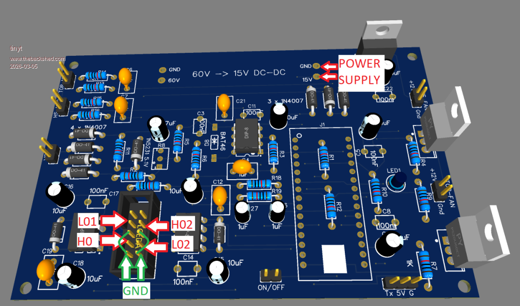

tinyt
  Bryan1 said  Keepis the DMM measuring the voltage is on the resistor bank output, now when the nano is turned off via the on/off switch both the DMM and BV on the lcd show 24 volts now as I turn the on/off switch on the voltage quickly drops to 11.4 volts. Now the green led on the power board stays on and the led on the nano doesn't flicker or anything like that.
It does seem to me the TIP 41 and 42 chips may need replacing as when that spark happened earlier on may of been the kiler.
You should make sure that both power board and nano board are working properly prior to connecting them together with the 10-pin ribbon cable. Otherwise you will keep damaging components.
As in my earlier post, you can check the controller board by powering it with 15 volts, and scoping the output signals. I don't have the controller board you are using, but my estimate is it should draw no more than 50 mA.
To avoid possible shorts during testing, I would also spend some time to make a test ribbon cable with a connector at one end and bare wires at the other end for the following pin numbers:
3: L01 test point
4: H02 test point
5: VS1 connected to pin 9(gnd) (can be used as 'scope probe ground)
7: H01 test point
8: VS2 connected to pin 10(gnd) (can be used as 'scope probe ground)
9: GND connected to pin 5 (can be used as 'scope probe ground)
10: GND connected to pin 8 (can be used as 'scope probe ground)
During testing, avoid the test point wires from touching any other wires. Otherwise, you can damage the IR2184's. Been there countless times.
Here is graphic picture of the board, courtesy of poida,  with notes for reference.
With the scope probes connected, apply the 15 volts power and turn on the on/off switch, and set the 'scope to capture the signal waveforms.

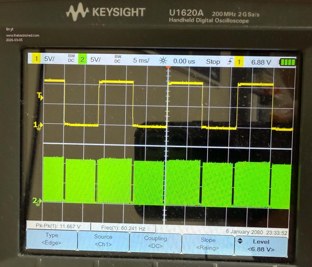

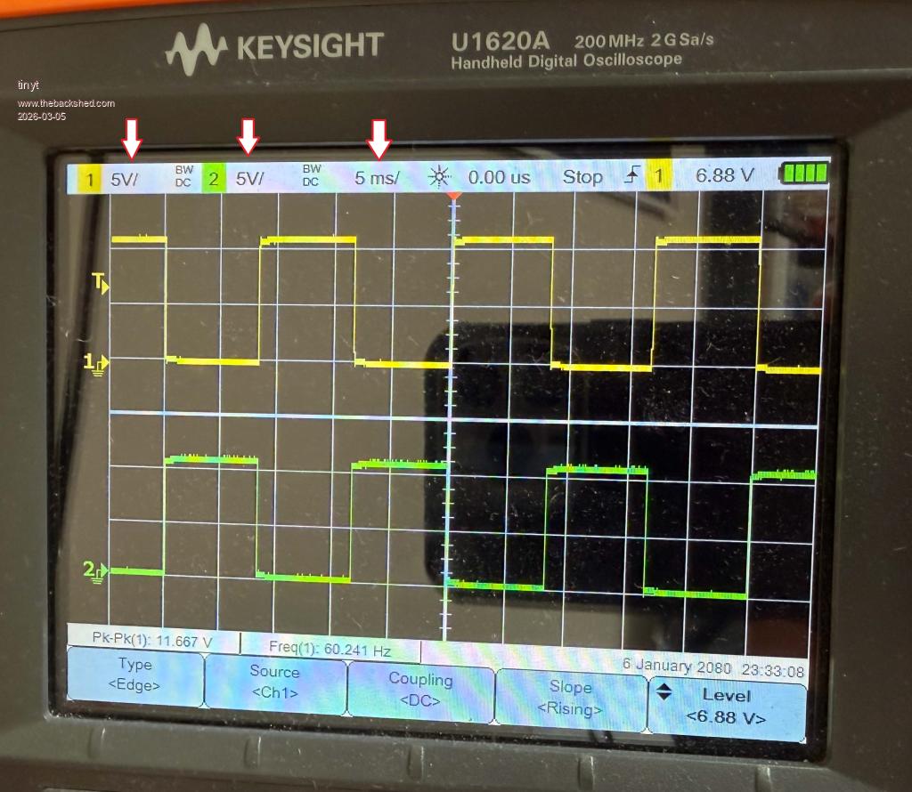

Also, here are some scope screen captures of the test points for reference. Note the settings pointed to by the 3 red arrows.
This is for L01(Yellow) and H01(Green)
This is for L01(Yellow) and L02(Green)
This is for L01(Yellow) and H02(Green)

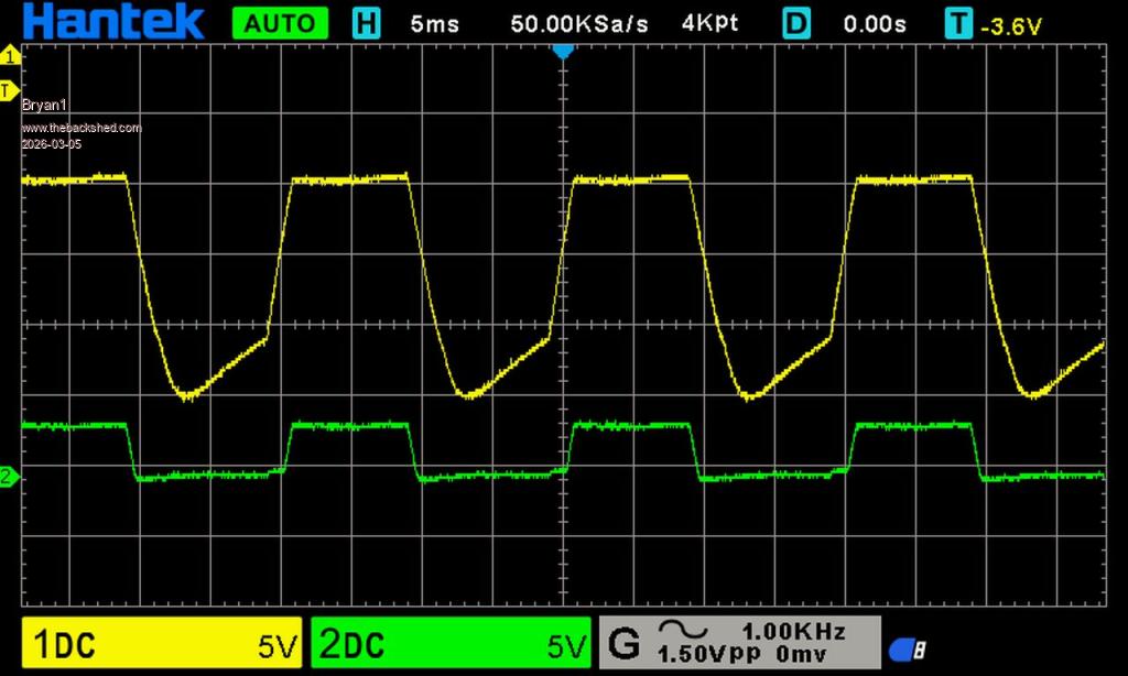

Ok made up a ribbon cable and labelled each wire for identification and setup ch1 to LO1 and the ground for the probe to VS1
H02 and I left the ground off VS2
The next test was
L01 and L02 and left VS1 and VS2 connected to the probe ground
Now when I introduce the Gnd wire to the scope Gnd the wave form goes flat so me thinks something isn't right there.

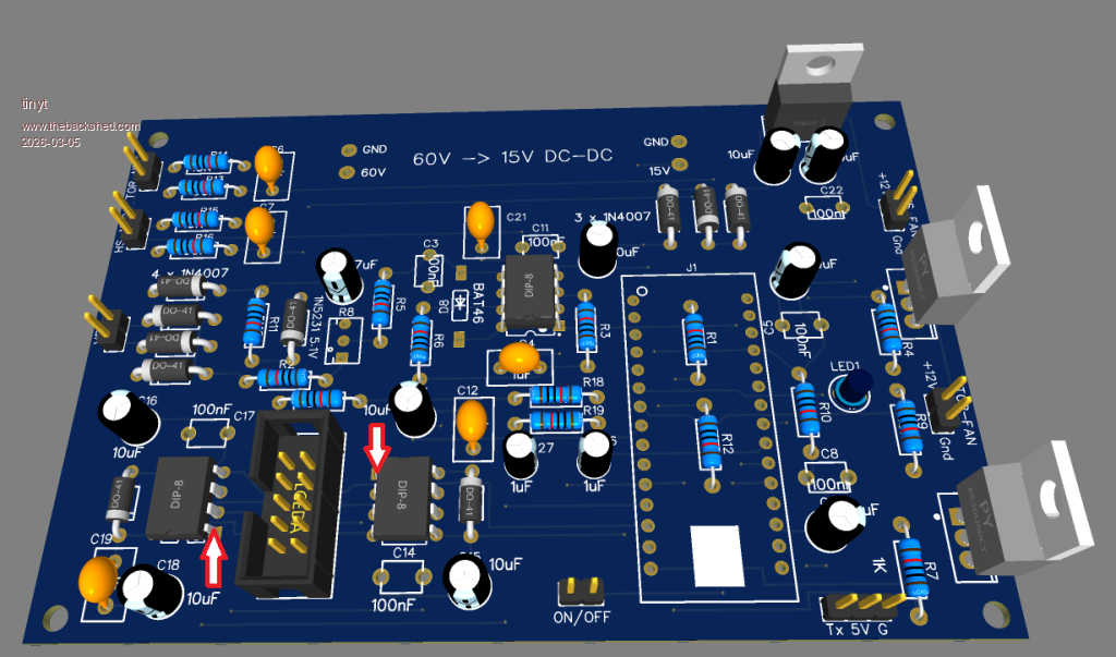

Still on the controller board powered and on switch to on:
Use only the ch1 probe and touch its tip to pin 1 of U1 '2184, capture the scope screen and post.
Then touch ch1 probe tip to pin1 of U2 '2184, capture the scope screen and post.
See below where the red arrows are pointing for reference.
Edit: Careful, do not touch probe tip to multiple pins on the '2184.
Edit2: I have to study updated previous post.

Well it is amazing what happens when one turns on the control board
CH1 L01 Gnd VS1
CH2 L02 Gnd VS2
My setup for these tests
Now for that pin test
