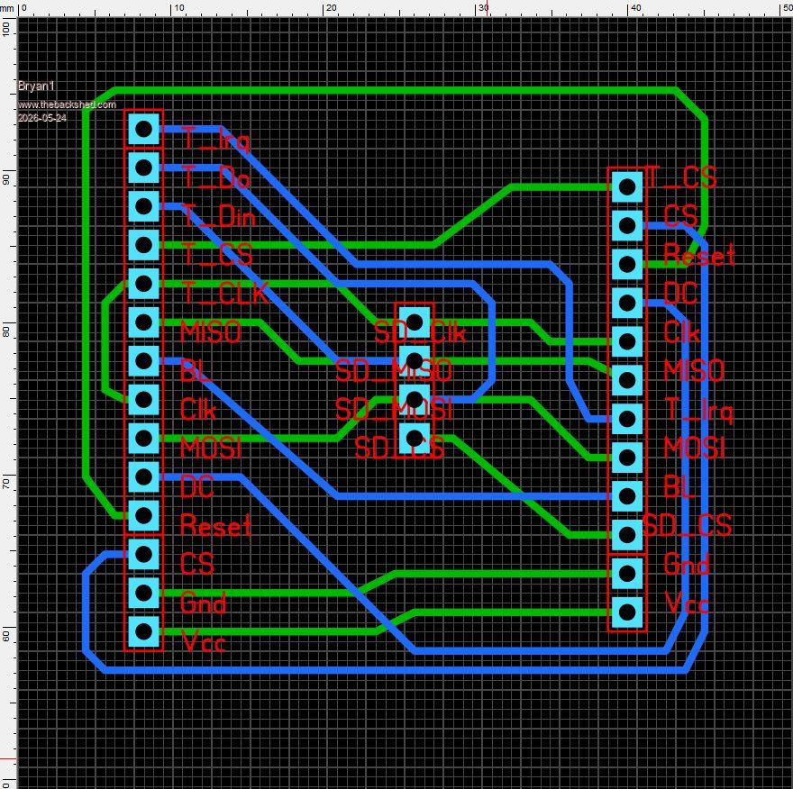

Just had a play in sprint layout and designed up the LCD Board   Got it fitting on a 50x50mm pcb so the cost maybe even cheaper
Anyway the connector on the left is for the LCD, the one in the centre for the SD_Card and the one on the right is the PCB connector so hopefully I got all the connections right and as usual the experts will find something wrong

I want to get that LCD board off to JLCPCB by tomorrow so they can be here a few days after the pico 2 stepper boards are here.
