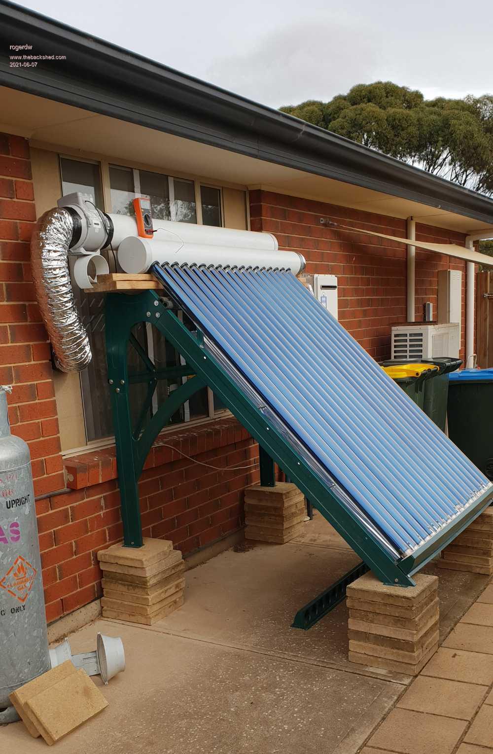

I did a few different things today.
After Klaus's comments, I put a datalogger up in the ceiling to see what temperatures are like up there.
Then I dragged out another panel to hook up in parallel because I couldn't get the fan to start this morning  ...  just too much cloud.
Even with two the fan wouldn't run.
I wanted to see if the tubes had built up heat so I used an AC fan on the outlet to suck air through  ...  and that was enough to jump start the DC fan.
There wasn't sufficient heat in the tubes anyway  ... more cold air again  ...  so I shut it down.
I also fed a thermistor temp sensor mid way down into a tube to see exactly what temperatures were in there. Should have done that ages ago.
Mid morning it was only 35 degrees.
The fan was switched off so it wouldn't blow cold air and when I came back at 12:30 it was at 57.
I switched on the fan and it ran (7.3V on two panels)  ...  and finally nice warm air inside.
After 3 mins the tube temp was down to 47  ...  and a few more again, 44.
At the time the outlet temp was 25.2.
I disconnected one panel and the motor stopped  ...  so I reconnected it.
Later I was working and heard an unusual and loud racket outside, so went out to investigate. Thought it was a truck breaking down out the front or something.
First thing I noticed was it was nice and bright out there  ...  but I couldn't hear anything until it started up again.
I raced up to the heater and realised straight away that the fan was the problem.
Seems the sun had come out and really powered up the poor fan. The noise was the shaft tearing out the hub of the fan and the fan bouncing around inside the housing melting the tips of the blades!!!
Scrub one fan blade. It has nothing to hold it on the shaft anymore. Bit sad really after all the work of putting it together  ...  still serve me right for leaving it unattended. Live and learn.
So it's back on an AC fan again.
Maybe I'll have to build my own box for the standard Commodore motor and fan after all.

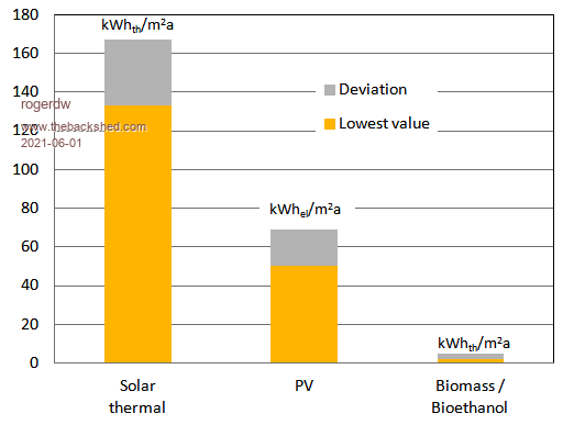

Something I never understood until recently was that  ...
...  The annual energy yield per square metre is much higher for solar thermal collectors than for solar photovoltaic.
Compared to PV, solar thermal collectors produce, on average, three times as many kilowatt-hours.
Source ...

Quite right with your last comment Roger, solar heat energy is much easier to recover than electrical energy is through solar photovoltaic cells.
Its just a matter of collecting solar radiated energy via absorption and then move it along to where its required by convection.
Davo, just a reminder, even the best commercial solar panels on the market today are just around the 25% efficiency mark. So your solar panel sq meter energy calculations above are way off the mark.

  Murphy's friend said  Quite right with your last comment Roger, solar heat energy is much easier to recover than electrical energy is through solar photovoltaic cells.
I was surprised when I first read it and didn't really take any notice  ...  but after my experiences so far, when I read it again it jumped out at me.
In the back of my mind I kinda thought the reason we don't read about solar air heaters is because they are a bit lame and don't really work very well  ...  but there are plenty of people aound singing their praises when you do look hard enough.

About the only thing I've done here apart from taking a few readings still  ...  is to have raised the whole array by placing a heap of pavers under each leg.
Has got it more into the sun and is definitely making a difference.
Under very similar conditions, on Sat morning at 9:30 the temperature inside the tubes before I turned on the fan was 41 degrees.
This morning at 9:00, the temp was 93 degrees.
Makes a big difference having only a couple inches of shade rather than a couple feet.

Don't know if you have shown the whole setup like that or I missed it or more likely my fast declining cognitive abilities have once again allowed me to enjoy something new for a second ( or 5th) time.
That looks a REALLY good setup mate.  I think the stacks of pavers in some way add to it.  Look at that clever Spring  mounting design for the fan. Provides spacing, reduces vibration and noise and made from on hand waste materials. Brilliant!
That's a busy wall you have going there. My south wall is a bit the same and Mrs wants to move the water heater there as well to make the back west wall totally clear. I suggested that when we first got here and was Poo poo'ed.

  Quote  Don't know if you have shown the whole setup like that or I missed it or more likely my fast declining cognitive abilities have once again allowed me to enjoy something new for a second ( or 5th) time.
I think most of the photos have been from the front so haven't shown the whole assembly  ...  so you're not losing it. I should have thought to post a shot like that earlier. I got five of those stands with my tubes, or variations of it.
I'm really proud of my motor suspension device  ...  thinking of patenting it. My duct tape is a bit old and in the sun it slowly slides off, so the closest thing I had within reach was that offcut of pvc. Has worked a treat, so I've left it there.
