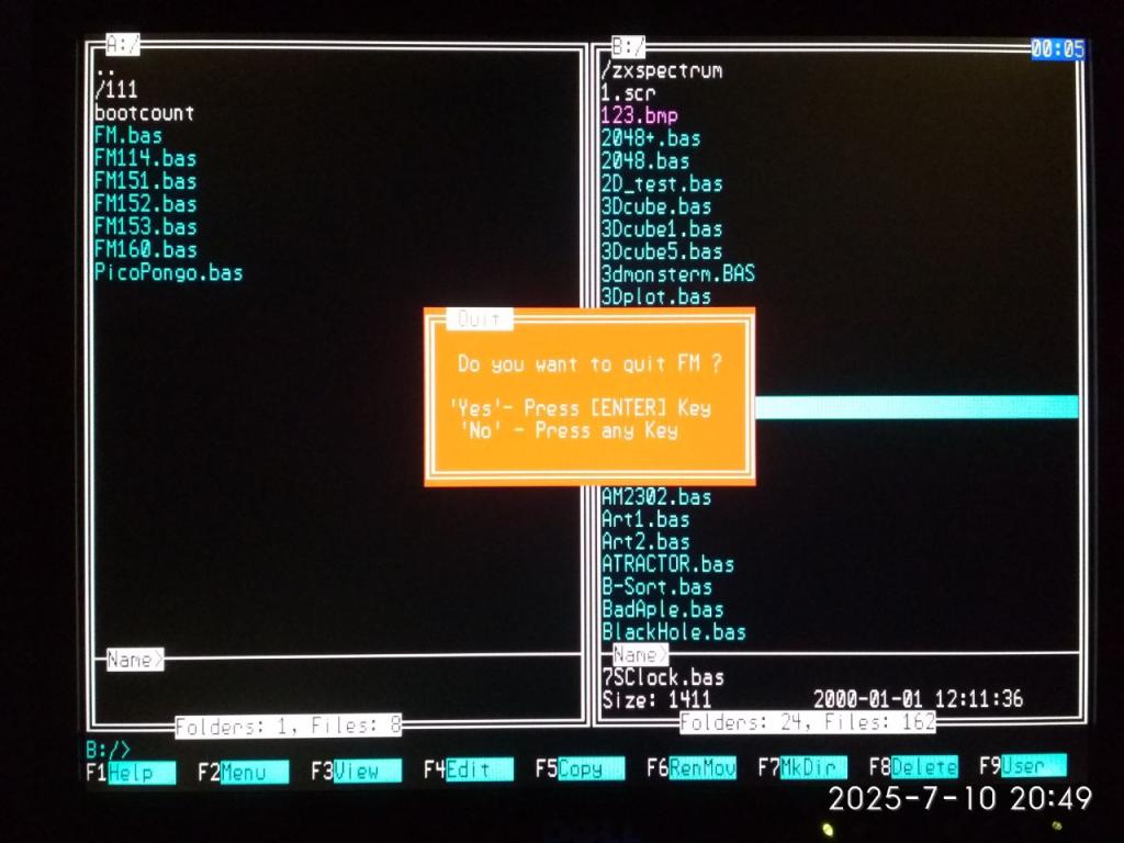

File Manager v1.6 VGA/HDMI
Increased size of the used file list +1 file (without the final empty line)
Warning indicator of file list size overflow
Added another example of the subprogram built-in F2[Menu]
Screen resolution adaptive interface FM
(Works on various screen resolutions MODE 1)
640x480  720x400  800x600  848x480
FM160.zip

Posted: 08:29pm
10 Jul 2025
Amnesie
Hi javavi,
I hoped that you will support widescreen resolutions one day, this is great news! I instantly downloaded it, now I'm testing it
Edit: I tested it and can't find any problems! Good job! THis piece of software is so helpful and intuitive; a real must have!
