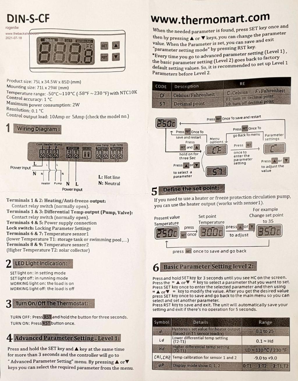

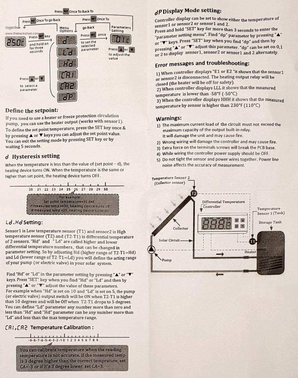

Thanks for the tips on keeping the helmet in the light. I've had it in the house for the last few days and then I decided to check it all out again and err  ...  ummm  ...  discovered that the batteries were flat  ...  2 x 2032 coin batteries.
After replacing them, it worked ok. It was the first thing I checked when I had trouble with it years ago and yet it had always been slow at blocking that first flash.
I must have gone through the sequence of adjusting the three seperate settings dozens of times thinking I had them set wrong somehow.
Anyway, I'll keep it out in the light from now on.

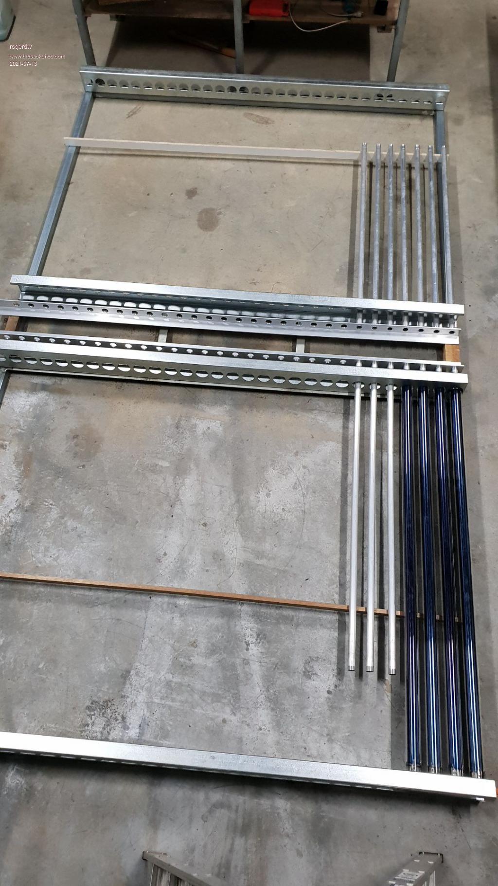

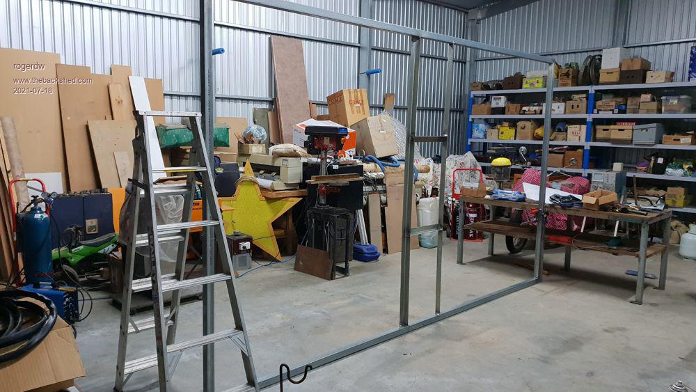

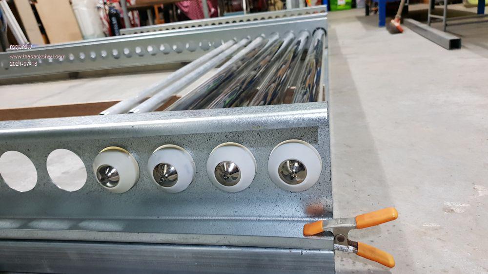

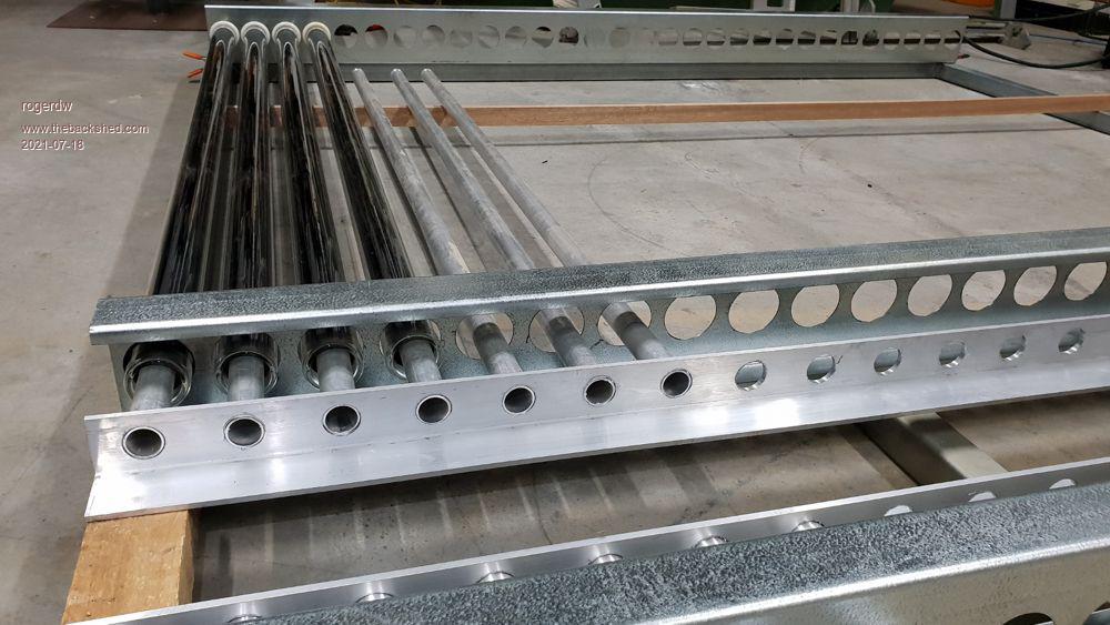

I finished welding up the base frame  ...  it's pretty big  ...  and if I stand on my tippy toes I can just touch the top  ...  though not as heavy as I first thought it was going to be.
I reckon I should be able to drag it up on the roof if I lay a protective mat over the gutter first  ...  and have someone down below to help lift.
I tried a dry assembly to see if everything fits where it's supposed to and thankfully no surprises so far.
Will drill all the assembly holes and weld a few captive nuts in place so it can be reassembled easily on the roof  ...  then start chasing the sheet metal that I'll need.
I still haven't sorted out my aluminium welding or brazing  ...  and have spent a few hours experimenting with propane and the supposed low temp rods  ..  as well as with the TIG again.
Couldn't work out why my results were so bad, until I realised that when I swapped over from the MIG, I hadn't transferred the gas hose over to the TIG inlet!!!
I actually could manage some reasonably controlled welds with the TIG  ...  but of course I ran out of proper filler wire. Once I get some more, I might have another go.
Here's some photos to show the progress.

That is a truly amazing piece of fabrication work there Roger.
Did your Chinese differential temperature controller ever arrive ?
Posted: 01:24am
18 Jul 2021
Davo99
Wow!
That puts things in Perspective as to the size of this setup.... and your Shed! Mancave jealousy there for sure!
I agree with Tony, that's a great and substantial bit of Fabricobbling and very professional looking as well. Wish I had some Skills and was clever.
Looks like it's going to kick out a lot more heat than the calculations suggest.

Thanks Tony, it's certainly turned out big  ...  and I am happy with the way it's going, apart from being all too slow.

  Davo99 said  Wow!
Haha, thanks Dave. I do keep thinking I may have overdone it a tad  ...  but if I'm gunna build something, it has to have a good chance of performing well.
  Quote   and your Shed! Mancave jealousy there for sure!
Thank you. Very pleased to have found this place with sheds already attached  ...  big house but even bigger sheds  ...  and wife loves the place.
I need to learn to throw stuff away though, or sell it  ...  would give me twice as much room to work in.
  Quote  I agree with Tony, that's a great and substantial bit of Fabricobbling and very professional looking as well. Wish I had some Skills and was clever.
Thanks mate, I've been a bit surprised myself at how it's turning out  ...  very happy. And don't cut yourself short, I've seen enough of your youtube videos to know you have some pretty decent skills yourself  ...  between coming up with ideas and then proving or disproving them  ...  and then improving on the good ones.
My biggest problem, as we've discussed before  ...  is I have to have every little detail worked out in my head before I lift a spanner  ...  otherwise I won't risk starting a project. Means I do a lot of thinking and very little of anything else.

  Quote  I was up the back yesterday looking at that Gal channel. The stuff I have is the same profile and looks similar Gauge but the holes are much larger and further apart so I doubt would have been any help. Probably more a frustration of the near miss.
I did wonder how close it might be, but was bound to be something that would make it unsuitable. Luckily I shouldn't have to do that part again  ...  and I can't see myself making another one in a hurry.
It certainly didn't need to be that heavy a gauge  ...  but I couldn't find anything lighter weight to substitute.
The other thing is the aluminium tubing  ...  mine has 2mm thick walls, where .5 or 1mm would be plenty stong enough  ...  but finding something cheap there has been difficult.

  rogerdw said
The controller turned up during the week, but I really haven't been able to work out yet how to make use of it. Have to decypher the instructions somehow.
I believe that controller will make a VERY big difference to your results.
Posted: 11:32am
18 Jul 2021
rogerdw
Yes it should, if I can ever work out how to apply it. It seems to work backwards for what I need.
What I would like to do is have it off until one sensor (inside the tubes) reaches say 40 degrees  ...  then turn on the fan.
As long as the second sensor can reach (quickly) and then stay above say 25 degrees  ...  then the fan can stay on  ...  but as soon as it drops below that  ...  the fan should go off.
I'm feeling a bit thick  ...  does it look like this can do that, or do I need to add some extra logic?
