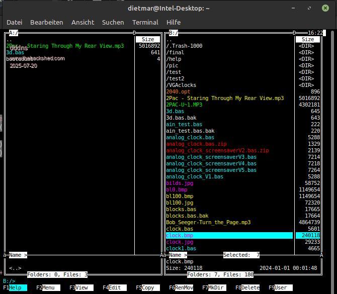

  dddns said  quick&dirty just commented out and defined colours by hand real quick, it runs on a RP2040 and a 7inch LCD ..very nice!
It works in full extent! It works perfect with FONT 1 and 4, all other fonts work as well only the frame is missing. Colours and inverted text work fine as in HDMI. My resolution is 800x480. Your new scaling is solid!
The processing speed is at least as fast as on HDMI and 2350. Very usable!
It looks very nice on a LCD! Pictures are shown in true colour :)
Edited 2025-07-17 20:00 by dddns

Hello Javavi,
I'm sure, you remember the wonderful set of subroutines replacing print@ provided by @matherp here
I _only_ replaced all COLOR commands by calling this subroutine:
Sub setcolour f%, b% ' set the colour of both the screen and the console
Local integer fr=f%>>16,br=b%>>16,fg=(f%>>8) And &HFF,bg=(b%>>8) And &HFF,fb=f% And &HFF,bb=b% And &HFF
Option console serial
Print Chr$(27)+"[38;2;"+Str$(fr)+";"+Str$(fg)+";"+Str$(fb)+"m";
Print Chr$(27)+"[48;2;"+Str$(br)+";"+Str$(bg)+";"+Str$(bb)+"m";
Option console both
Colour f%,b%
End Sub
It was not more than find&replace and took 15min..:
So I can say, that it runs for me on every platform ..very very nice!
