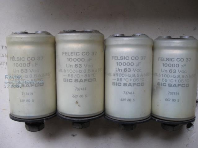

Just thought if they were long enough i might be able to use the copper backing off the busted, mosfets stick them on the cap legs as a mounting pad and bolt the caps underneath the power board.

These capacitors where taken from an old power supply, They worked well in the other inverter despite the 63v rating.
Haven't found much info on them apart from being long life cap's, there is some 75v and 80v caps somewhere in the shed, not screw types though.
Looks like I will have to buy some 80v or 100v cheep ones eventually as they seem to be working okay for other's.

There was some banter on here somewhere about caps a while ago. From what I remember to test them is to put your battery voltage on them and see how much current the draw over after 24 hours or so.

Connected all 4 caps to the batteries and the current is 0.63ma at 54v, looks ok.
will see if its any different tonight.

Checked the caps at lunchtime and the reading was 23ma WTF?
Turns out that was because there was an inverter running the HWS at that time.
All shut down in the afternoon and the reading was .03ma at the caps.
Perhaps that's better.
Anyway that will do me for a start.

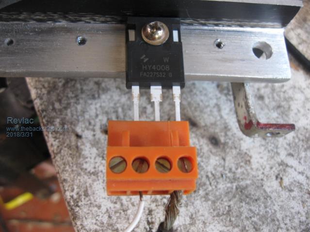

Tested 10 HY4008W fets when a had a chance.
Tested with 12v and a variable resistor (set to 6.5amp) that I used for testing solar panels.
Results:
3 at 20.6mV/6.5 = 3.1 milliohms Rds
7 at 20.8mV/6.5 = 3.2 milliohms
Wound it up to 10A and the result was about the same?
Expected lower reading than that, Something is a little off?. I suspect my ammeter is bad.
However It still shows which ones are different.

Aaron it is hard to get an accurate measurement, what is more important is consistency in the measurements you have taken. Taking measurements with really good contact as close as possible to the body of the MOSFET will give the best reading, the resistance of the legs is enough to give a an error.
If all the MOSFETs read very close to the same value is what matters most. If any give a different reading then don't use them in the inverter. So far I have not had one HY4008 with a bad reading from the supplier I use. 3.1 to 3.2 is well and truly close enough so no problem with those you tested.

Ok that confirms what I'm looking at, consistent reading's.
The little ammeter was out a bit, now I understand the results that the amp drawn must be the same for each fet tested.
Found a pluggable terminal block/screw terminal socket, and the fets legs just plug in nicely for testing.
Just after taking this photo I started testing more fets but got a bit distracted by some of the wildlife.
Come back 10 minuets later only to find I had left the power on the test rig and the resistor heated up next to the ammeter and melted the Arse out of it, little meter is now in the bin, Hindsight should use a momentary on switch.
Nothing wrong with the fet that was connected, never even warmed up, good idea to test them on a decent heat sink.

I fix the terminal block and just hold the MOSFET in it with a bit of pressure. When you take it out no current flows, only takes a second to get a reading.

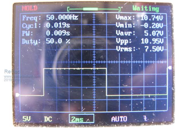

Revlac

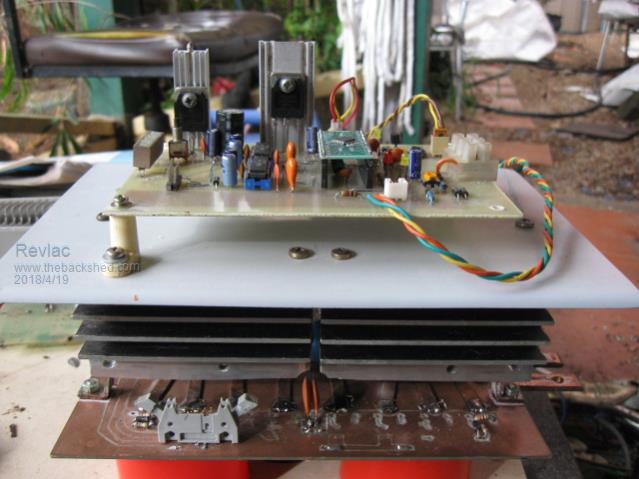

OK a little more progress, decided to mount the heat sinks to a piece of fiberglass and then mount the control board on top, it was just easer to assemble, less pissfarting around than trying to do it the other way with this heat sink layout.
This will leave room at either end to mount a fan and looks a little more neat.....IMO.
Still need to make an IDC cable and test it again.
Had a bit of a look at this AN-1045b found it interesting and somewhat relevant, someone may find something useful in it or some other ideas, makes me wounder if we could play with the dead time a little bit depending on the design and layout being used, the default setting has been working for some, but may be a factor (Make it or Break it)..?

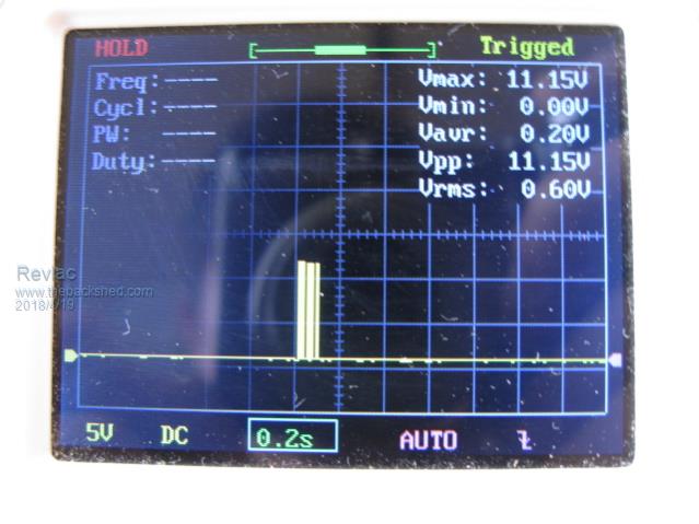

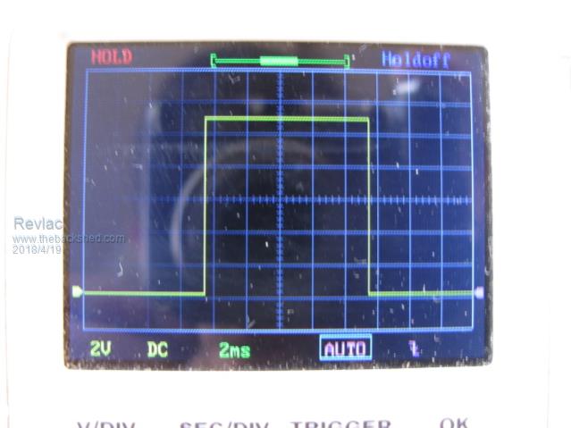

Did a bit of a test to check the signal out put of the IR2110 at TP 5 the 50Hz square and its looking good.
Adjusted the voltage on the OSC and its strait no spikes, will have to see if it stays that way when tested at the gates of the fets.
I also notice the drive voltage is too low, 13v zener is a bit off so will try 18v zener.
A little quirk I didn't notice before, as I run this test without the power board connected it will run for a few seconds then stop blink 3 times then 4 blinks and cycles, nothing unusual about that, however when I turn it off during this off cycle it will just start the next cycle with a few pulses before it is really off, at first I noticed the led blink when it was supposed to be off, then checked it with the OSC and saw it in action.
Don't know yet if that happens on any of the other outputs yet.

Must be nice to be able to see what you are doing now Aaron with a CRO.
I found increased dead helped when I had other issues but when everything was working right the shortest dead time setting of the 8010 gave the best result.

Aaron, ive noticed that to. The eg8010 will even start the next cycle before shutting down, doesn't seem to matter though. .Edited by noneyabussiness 2018-04-21

Gary I would be poking around in the dark without one of these things, sometimes things just work when put together, until something happens and then......well you know the story.
@ noneyabussiness
I checked all the SPWMOUT 1-4 and they all have a vary short output signal (Counted 5 Pulses on the 50Hz side), perhaps its just the first part of the soft start, but if that doesn't cause any trouble then it doesn't matter.
Cheers Aaron

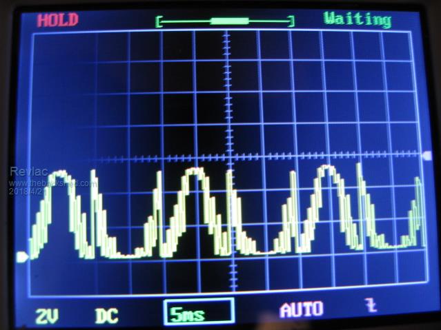

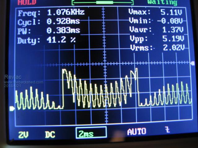

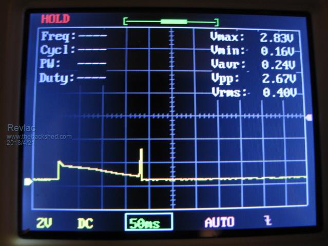

Posted: 09:19am
21 Apr 2018
Revlac
OK this test is (SPWMEN3)At the IR2110 input using the (RC Filter) 5.1K resistor and 0.1uf cap at the end of the probe as per the EGS002 data sheet.
Without the RC Filter it will look a bit hairy.
3 seconds isn't much time for a snapshot but this is the best I could do, Be better too if this dopey held the camera still.
Not sure if I'v done this properly but It seems OK to me.
I think this is the soft start part of the cycle.
And this is a bit further along
This is the reset button pressed and realest, It dose not appear on the on the IR2110 out put that i could see.
Don't take too much notice of the number's in the picture.
Cheers Aaron

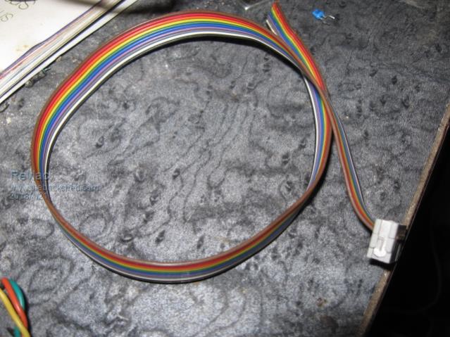

Revlac
This in an old cable I had planed on using and crimping a new end on.
Unfortunately I seem to have pore choice of words.
I'm going back to my cave now.
