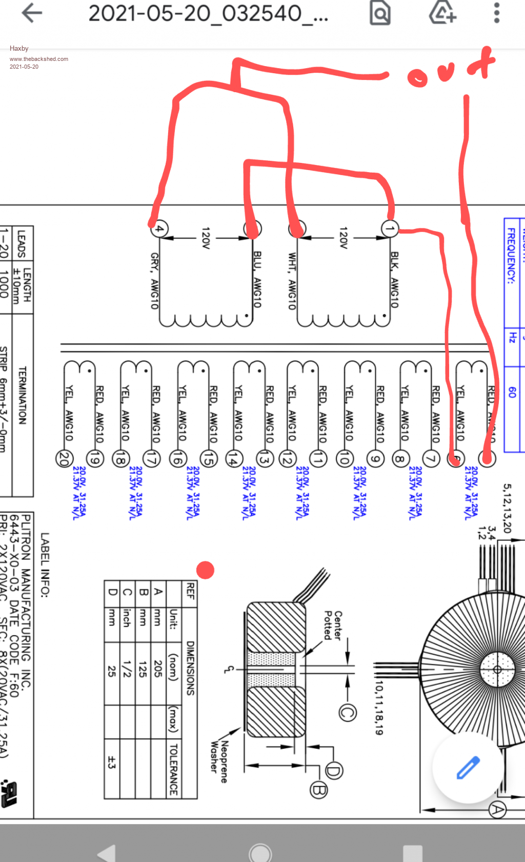

It may still be possible to make that 5Kva toroid work, by placing one of the 20v primary windings in series with the secondary.
So you then have 20v primary, and 120v + 20v = 140v secondary.
If we did that, to reach 120v across the combined secondary, only requires 17.1 volts across the primary. Peak primary voltage would then be 24.2 volts, still a bit higher than ideal but it might just be workable.
Secondary max power would be 31.25 amps x 120v = 3750 watts
Primary max power 31.25 amps x 7 windings x 17.1v = 3740 watts
So nothing is over stressed at the above power levels.
This would also reduce idling power significatly.

Ooh, that sounds like I wouldn't even have to wind my own primary. Did I understand that correctly?
I can get 2 of these for $100.
Why does this work?

  flyingfishfinger said  Ooh, that sounds like I wouldn't even have to wind my own primary. Did I understand that correctly?
Why does this work?
R
You are not driving the transformer as hard as it was designed for. Less flux density. Less volts per turn. That equals less idle power.
You won't have to wind your own primary (for a 24v system).
The trade-off is a lower power output of 3740 watts, instead of the rated 5kw. Pretty good trade-off if you ask me.

Yup, Phil has nailed it.
Idling power will be less because you will only be driving the 20v primary to 17v not 20v.  Lower flux density = lower idling current.
I think its at least worth a try, and if you need to, its always possible to rewind the primary.

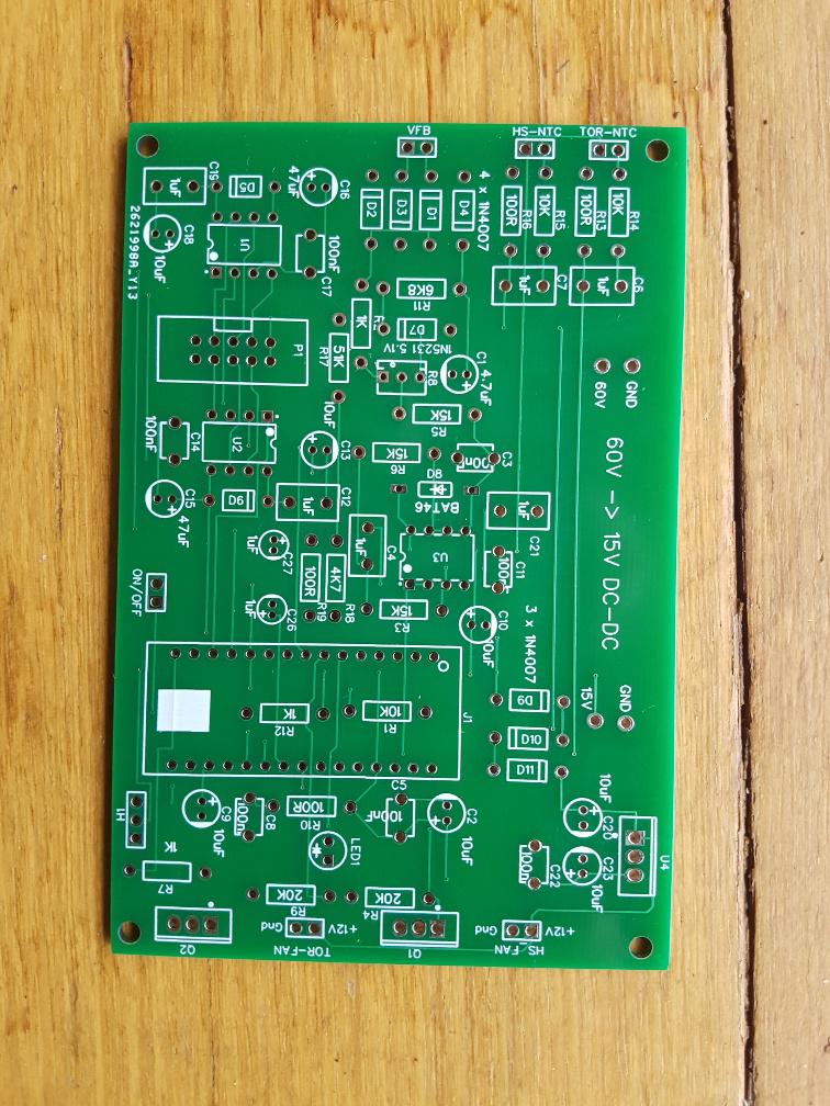

the picoverter boards have arrived.
You of course have your name on 2 of them.
In the mean time, obtain a couple of
these 80V ->15V modules since you will need one for the picoverter.
Or use something else you have handy that makes 15V at 1 Amp. It's not important
what you use. just need 15V, ground referenced to the battery -ve.
