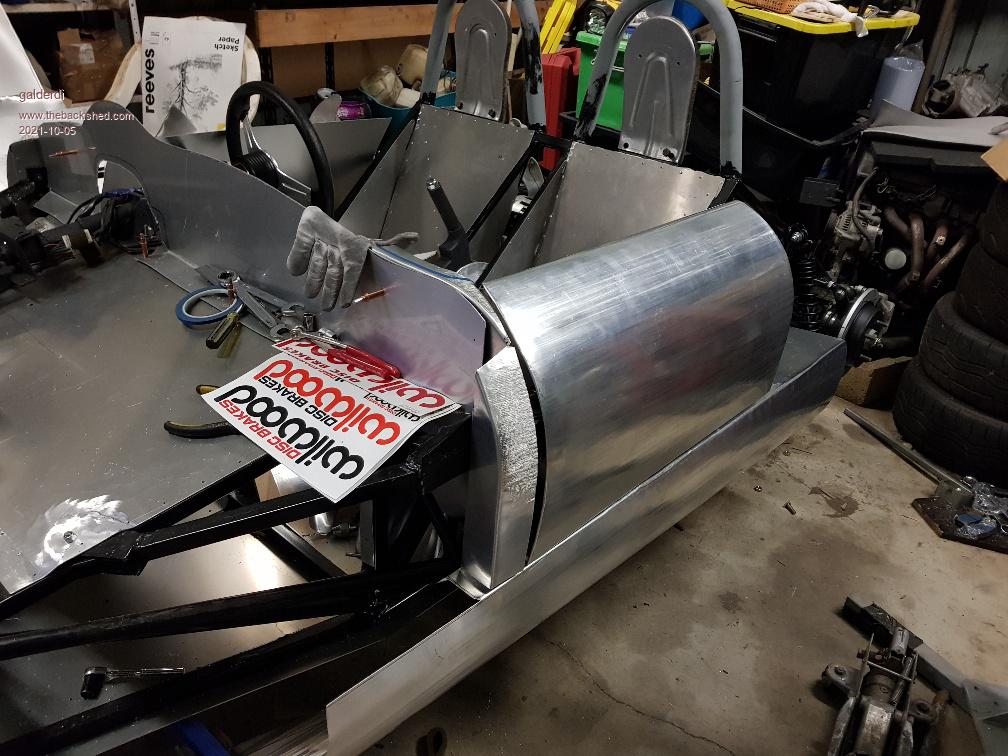

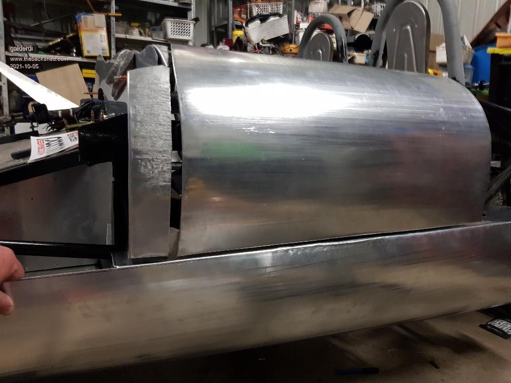

Thanks for the encouragement. This type of ability is certainly hard to find. Too many people would rather take the easy option. I can kind of understand it from a paint shop's point of view. They need to make money and the most cost effective way is often to replace a panel rather than repair it.
My work is far from perfect. Certainly not even good enough to leave as raw aluminium. But as a beginner I am fairly happy. I am learning quickly.

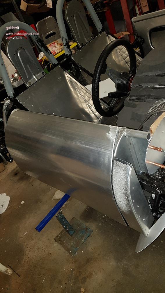

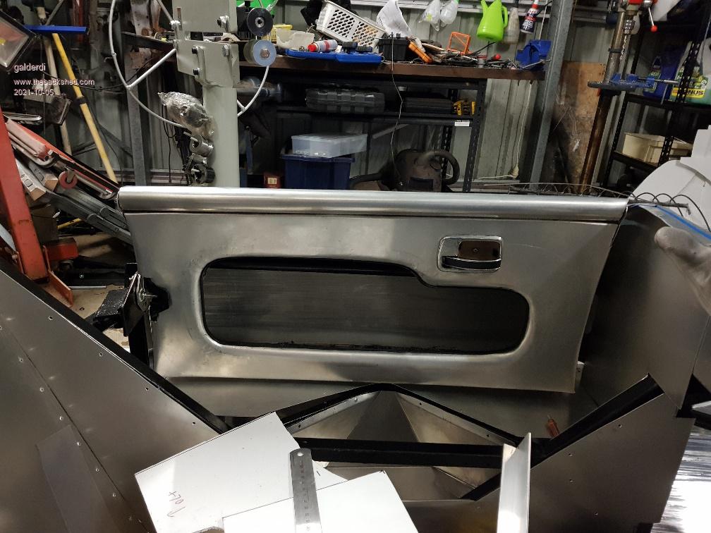

Here is my latest photos. The passenger door is almost complete. I just need to add a small weld at each end of the tube on top. The driver door is now progressing also. The inner panel is formed and attached to the door frame. I need to form the right sill so I can assess and adjust the lower door gap before creating the skin.
I have also started a practice attempt at the dash.

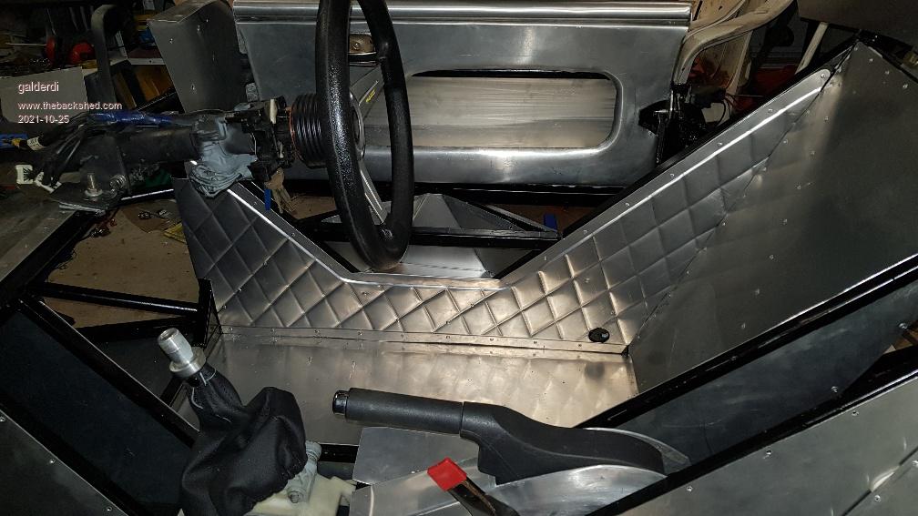

galderdi
I tried my hand at quilting on the weekend

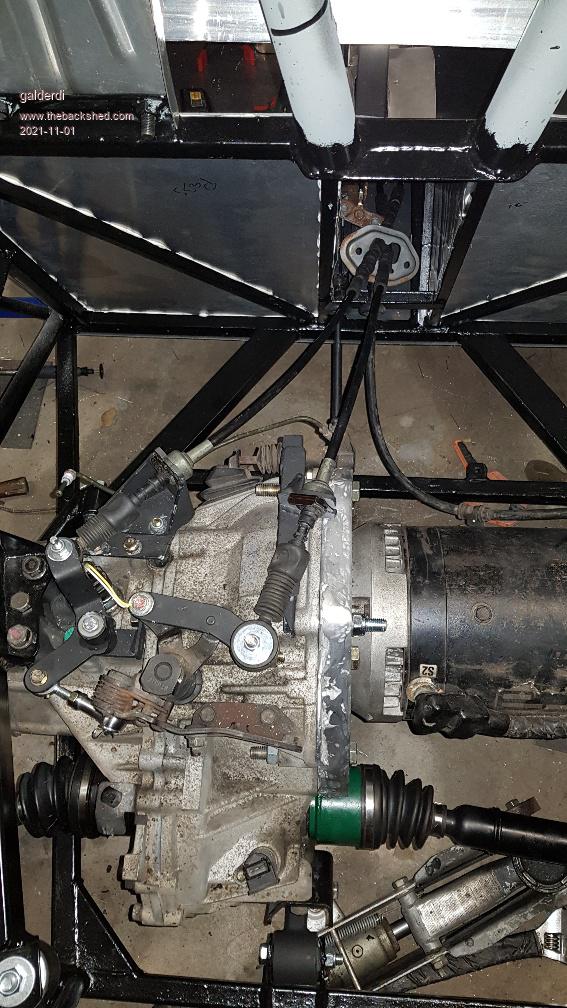

Another productive weekend. I modified the hardware for the shift linkages to allow for the 30mm required. One of the cables was long enough because the small silver linkage had enough adjustment to compensate. But the bracket for the sheath needed to be moved 30mm toward the front. The other sheath bracket also had to be moved 30mm closer to the front and I made a new pivot bracket with less angle to move the cable connection 30mm further forward.
I also made some progress on the panels. I permanently attached the structural panel above the footwell. Then I adjusted the dash and door jam panels to suit their new position allowing for more padding to satisfy the registration rules. I also started playing with moulding some polycarbonate to act as clear screen to protect my gauges as the original screen was too deep and had too much angle to suit my purpose.

Looks great, I did not realise that you are making an all wheel drive vehicle.
That will make it a great little car to drive.
Is that a subaru gearbox you are using?
Pete
Posted: 01:56am
01 Nov 2021
galderdi
  Godoh said  Looks great, I did not realise that you are making an all wheel drive vehicle.
Pete
Sorry Pete, it's not AWD.
I was originally planning AWD but my engineer steered me away from that plan. He was going to insist on synchronisation methods and extra testing. It would have been a nightmare and would have become a totally different car. In other words twice as heavy.
At least this way it will be a very light and nimble little car.
The photo might have confused matters as it is a front wheel drive motor mounted in front of the rear wheels. The rear wheels are at the end of the drive shafts in the photo. The gearbox is from a Hyundai Getz.

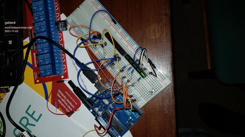

Last night I started a trial run using an Arduino to run a series of temp sensors. The sensors are a safety feature. If the batteries get to a certain temp I need to ease off on the accelerator. The sensors I am using can be run in series and provide a digital signal. I purchased 2 sensors for the trial run but my hope is to use 45 to have a sensor for each set of battery cells. I need to prove that 45 will work in series and drive some form of visual output. I successfully got 1 sensor working but couldn't get the second one working. I thought I either had the wiring or programming wrong. But then I swapped the sensors over and still couldn't get the second one working. So I am fairly sure it is a faulty sensor. I plan to purchase a couple more sensors and some other items to continue the trial tonight. I need to decide on the best way to display the result.
I think displaying the individual temps for 45 sensors would be way too difficult and would also be an eye sore in the car. I was thinking of 2 x 7 segment displays to provide the highest temp rounded to the nearest digit. But even that would be an eye sore. My current thinking is to have a single bar of 10 LEDs with 7 green and 3 red. Each LED would represent 10 degrees. Before driving it should sit at 2-3 LEDs. Normal driving might see 3-4 LEDs. If it gets to 5-6 it's time to back off. Any higher than that would be cause for concern and time to stpp driving entirely. The LED bar is only 61mm long and 5mm high so I think it will be the neatest solution.
I also need to modify the code so that it drives another LED to warn if any of the sensors go off line.
As a side note the motor controller also has a temp sensor for the motor and can drive the standard temp gauge in the cluster.

I made some good progress on the temp sensors last night. With a replacement sensor I managed to get the test working. I went to a different store and opted for 5 green LEDS and 5 red LEDs but the principle is still the same. I worked out how to get the logic to recognise the highest temp from any sensor. Then I worked out how to drive the LEDS to reflect the highest temp. For the purpose of the test I had it calibrated to trigger 0 LEDs less than 29.5 degrees, 1 LED between 29.5 and 30 and 2 LEDs above 30. This allowed me easier control to raise or lower the temp for the tests.
So that proves the theory. I have ordered all the sensors. Once they arrive I will need to perform another test to prove the system can handle 45 in series. Then I just need to alter the code to calibrate for 10 degree increments and replace this temporary circuit with the permanent one........I love arduino

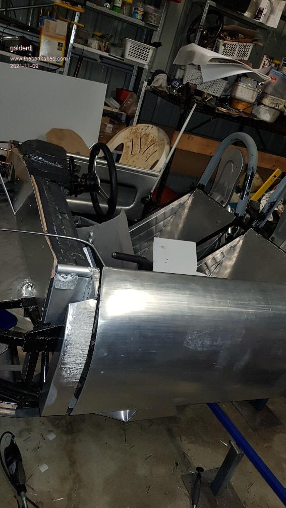

The other challenge I am facing in the bonnet area is allowance for the impact of bead rolling. I plan to use the bead roller for both the inner panels and the bonnet itself. For the inner panels I need to create some steps for the bonnet recess. For the bonnet it will have a frame around the outside to provide some strength. The frame will have a bead rolled in around the perimeter to stiffen the structure. The challenge comes from the bead roller altering the contour of the panel. There won't be much ability to bend it back after the process. So I need to add additional shape before I bead roll. Then the bead roll will bring it back to where it needs to be. I will need to do a test run to understand how much allowance is required.
My head is spinning.

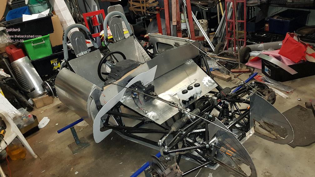

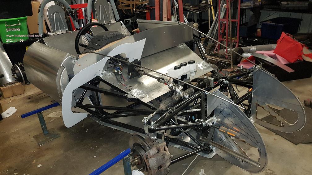

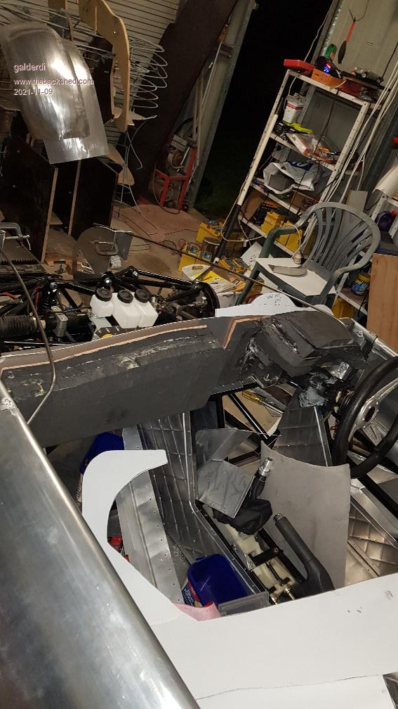

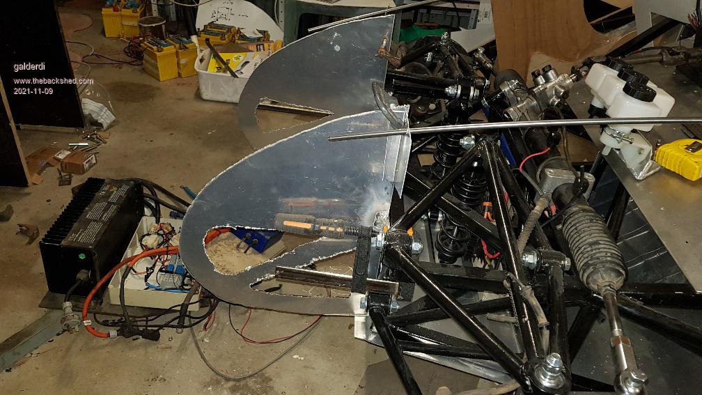

I made a little more progress over the weekend but nothing was really photo worthy. I did a little more work on the front door jams with some trimming and grinding. But more is required. It was enough to enable me to mount the driver door in place and checked the alignment and gap. I am fairly happy with those results. I need to do the same check on the passenger side.
I redid a fair amount of work on my practice dash to allow for the revised position. The passenger side is coming together but the driver side needs a heap of thought and work.
I started work on the nose support structure. This is basically some aluminium framework extending in front of the chassis to support the nose panels. It will also provide the mount point for the bonnet hinge. This structure is important at this point because I plan to start work on the panels around bonnet area and I need points of reference to ensure the heights are correct. I have created a couple of steel bars which match the contour of the bonnet. I will use these bars to span the gap between the nose structure and the top of the dash. This will give me the height and the outline of the bonnet. Then I can build the panels that will extend up from the chassis to these bars. The top edge of these panels will support the front guards and will incorporate a recess into which the bonnet will seat. These panels will also become the lining around the usable space under the bonnet. I am still finalising where all the components will go. But I am hoping I can keep them confined to the driver side leaving the passenger side free for some limited luggage.

galderdi
Here are some photos to show the latest progress. Don't mind the rough edges. None of this is finished. But it lines me up for some key panels.

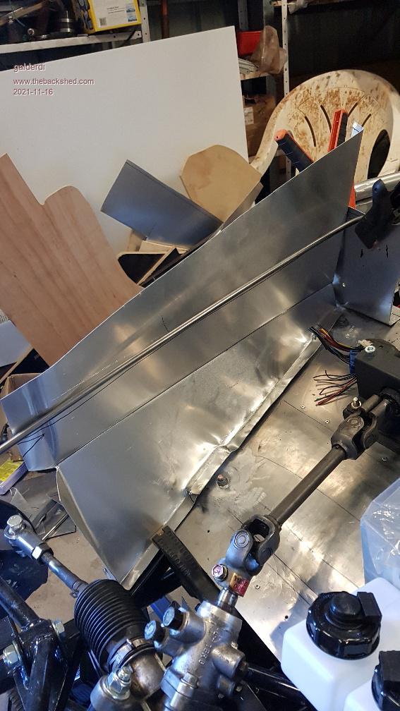

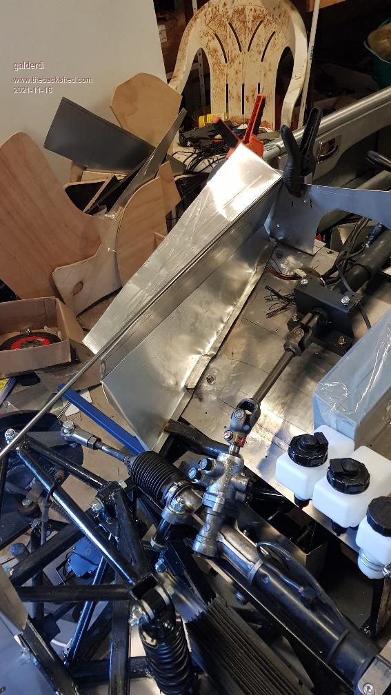

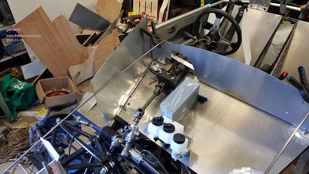

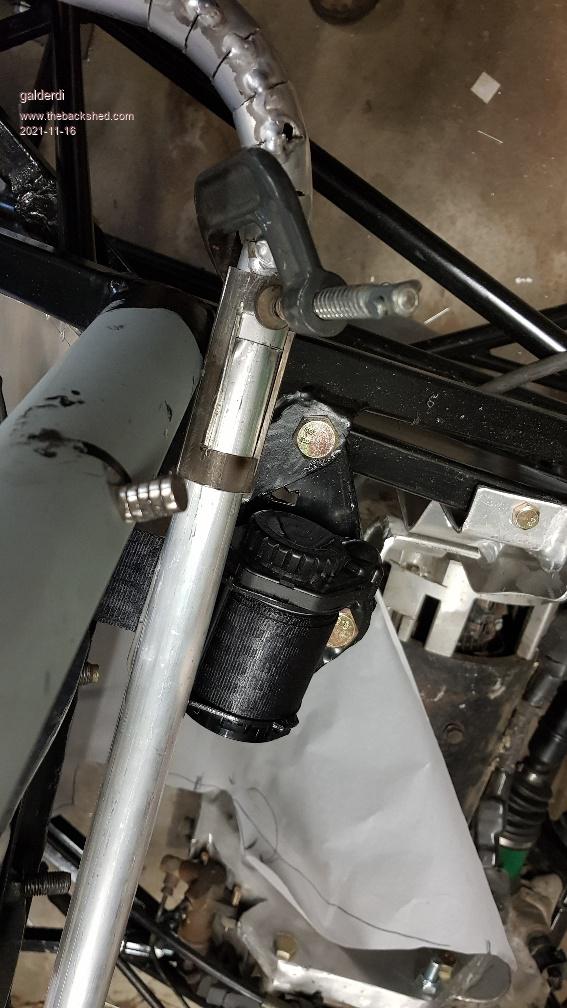

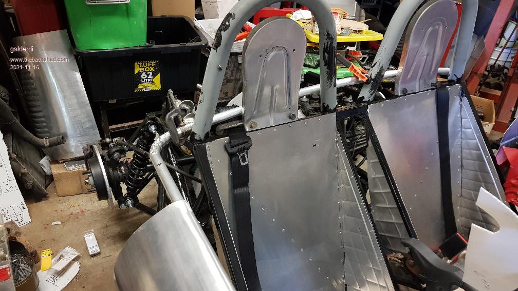

I solved a couple of key challenges over the weekend.
The first one was how to secure the tube bends accurately so I can weld them and end up with them in the correct position and angle. I came up with these little brackets which are made from a steel tube one size larger than the aluminium tube. I split it in two parts and cut a window in each side so I can weld through it while it is clamped in place.
The second challenge was the inner panels under the bonnet. I made a guide so I know where the edge of the bonnet needs to be. But the edge of the bonnet does not line up with the edge of the chassis. I thought about twisting the panel or putting some shape into it to get it to twist. But I think the accuracy would have suffered. The edge needs to be straight on the vertical plane but follow the bonnet curve on the horizontal plane. What I came up with is a bend part way down the panel. I am happy with the result. It gives me the ability to adjust the top edge of the panel to line up fairly accurately with the intended bonnet line.
