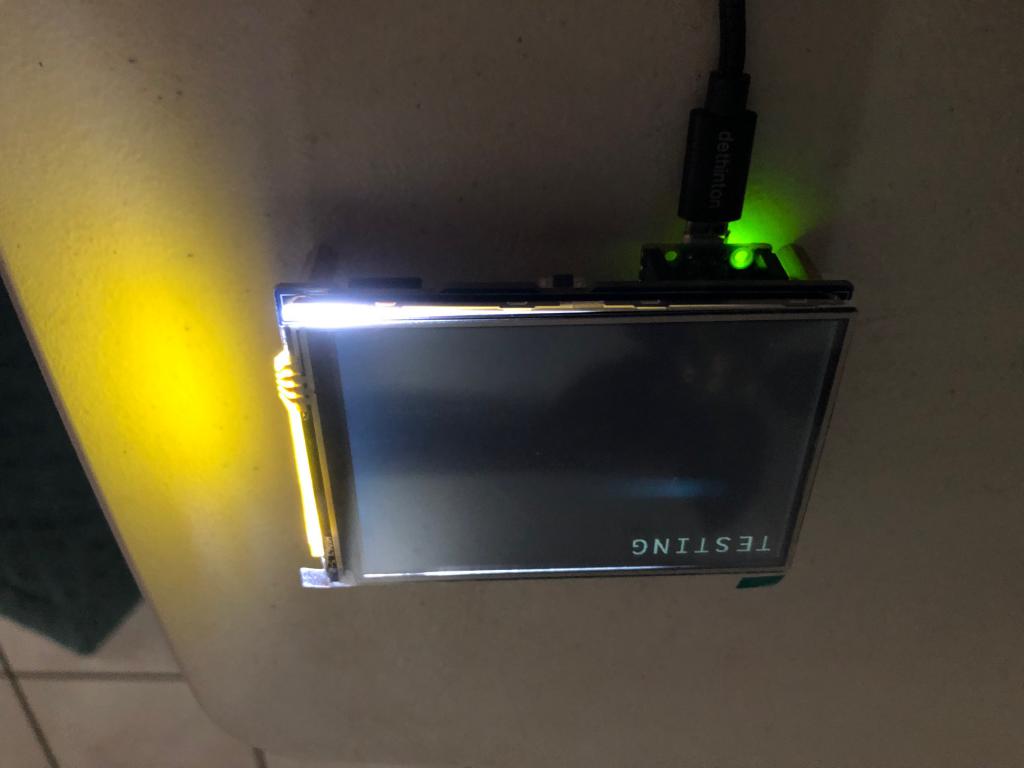

Posted: 10:05am
17 Oct 2021
cdeagle
Peter,
In order to turn off the grey-to-white display of the 9488, I have to set BACKLIGHT 5.
Then I cannot see any graphics on the display. If I leave BACKLIGHT 100, the display seems to work, at least simple text and GUI TEST LCDPANEL. Of course it's hard to read.
Here's a photo of the display with BACKLIGHT 10 and GUI TEST LCDPANEL running.
David
Posted: 10:17am
17 Oct 2021
Just to confirm, the new ILI9488W driver is working but the backlight is overpowering?
Try this version (last try possible without a display)
PicoMite.zip
Edited 2021-10-17 20:20 by matherp

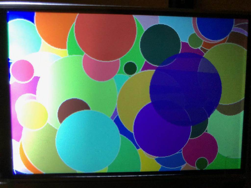

Posted: 12:58pm
17 Oct 2021
cdeagle
Peter,
ILI9488W driver is working. Latest uf2 has reduced the display backlight almost completely. Still some on the right side of the display. Photo attached.
David
Posted: 01:02pm
17 Oct 2021
This is now using the initialisation specified by Waveshare in their demo code so nothing more I can do. The rest of the light bleed is presumably just down to the way the display is made. I'll post this version as a new beta.

Posted: 08:26pm
17 Oct 2021
It doesn't appear to be a very even backlight at all. Changing the brightness will be a compromise at best - it's the way the display is assembled. Either that or there's a bank of LEDs down the dark side that isn't working.
