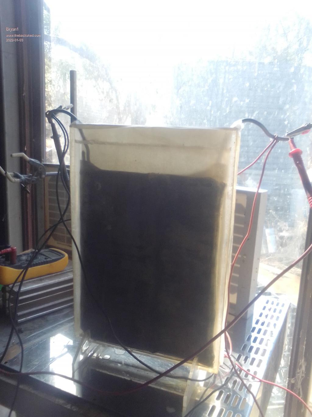

           While playing round today I got some of my lead sheet out and flattened it all out then thought a bout that perspex tank I made years ago for etching then looked at one of the sheets and thought what the hell.
Folded it in in 1/2 and cut it then as I have a heap of lead 1/4" round just wrapped that around for a stiffener and brought one end out for the terminal. Made 2 of them and for a seperator I just cut some of that big roll I have for motor rewind insulation.
Made up a saturated solution of Aluminum sulphate and slowly added that in, then connected 2 of my 5 watt solar panels I have in parallel and hooked up my cheap multimeter to the terminals.
0.6 volts came up straight away and by the time I spat the dummy with my phone for the camera not working the voltage was 2.5 volts.
So the plates are approx 180mm wide and 270mm high and with my tank measuring 200x300mm they made for a nice fit.
I have left the solar panels connected and I'll check the voltage tomorrow night and for a bit of fun I may of just made a battery
Cheers Bryan

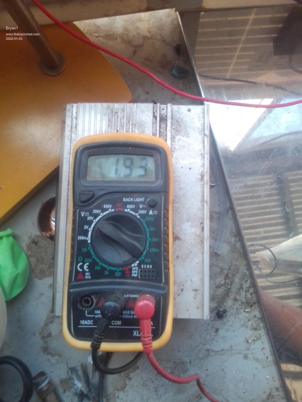

           YAY a factory reset of my cheap phone did the trick so below is a pic of today's effort of fun
Now I took one of leads from the solar off and left it a bit for the voltage to stabilize
So for just over 2 hours of charging it's holding voltage so that is a good sign and it will be interesting thru the week to what actual voltage it gets to.

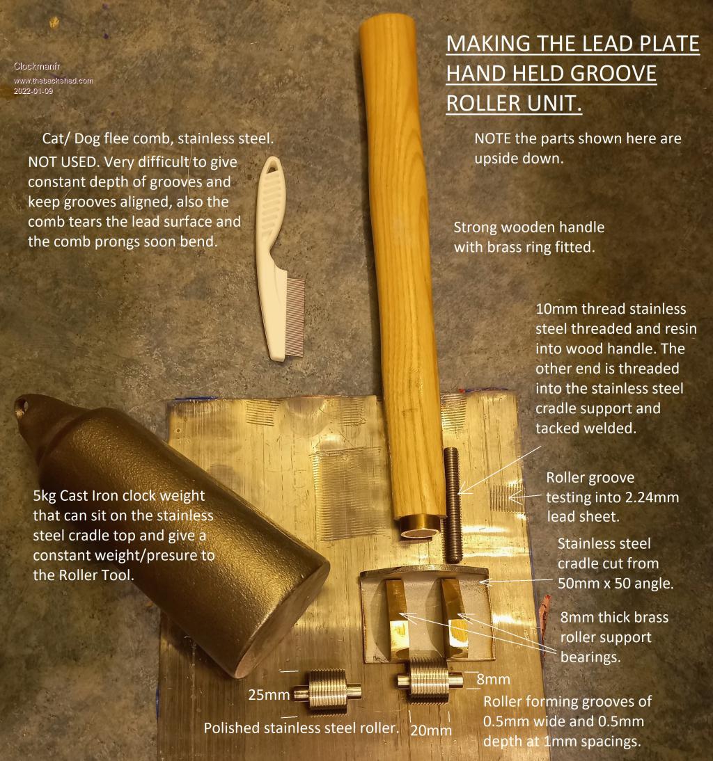

The PLANTE battery cell i am trying to produce has fine pressed grooves in the surface of all plates. This then allows the first 0.6mm of the plate surface to form into the correct Lead oxide. Basically the surface becomes spongey as the lead is transformed with the charge and discharge and swap the positive and negative plates around. This is normally about 30 to 40 times. Then the final charge will set the battery to what is positive and negative.
The grooves are the modern twist to the PLANTE battery and the charge and discharge regime are also a modern twist. But the grooves need to be within parameters. I have some test results that show the sizes i have as suitable to get the lead oxide to form correctly, and also hold the lead oxide in position.

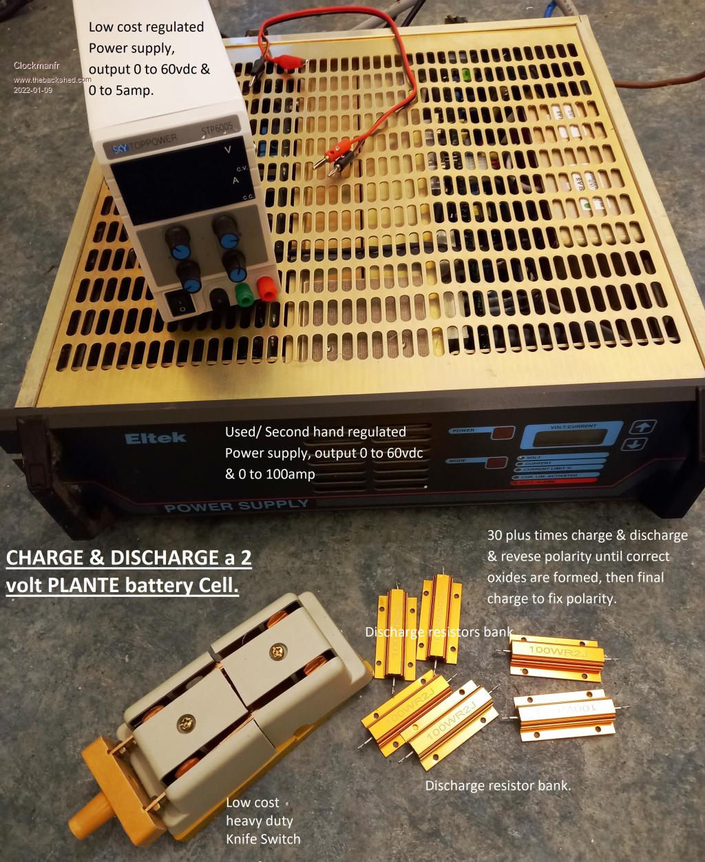

To form the correct oxide on both plates you need to fully discharge the cell, then reverse your cell connections and recharge. then discharge and reverse your connections and re-charge, about 30 times, then do a full charge on what you want to be the positive and negative plates.
The battery cell will improve its ah.
However there are strict discharge rates and re-charge rates to get a real good oxide to form and stay formed.

Okay so we need to form the correct oxides to form on the correct plates. So to form we  charge at 20% to 23% voltage of the 2.3 volt cell and at 10% to 13% of the rated Amp hour capacity of that cell.

Discharge rates for PLANTE battery plate oxide forming.
Each of the 30 times minumum charge and discharge should be the same rates to form the correct Ozide. And remember the polirity should be revesed on each charge.
On the 31st charge you will then make the positive palates positive from then on.
Discharge should be about 10% of the battery capacity in voltage and amperage.
