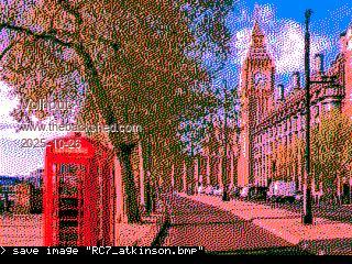

Posted: 03:05pm
02 Jan 2023
Martin H.
  homa said   _
I Think I've found the(by now) best solution.
Here is an Online Ditherer, where you can save (copy and Past) a Custom Color Palette and it dithers in many different ways:
https://ditherit.com/

Here the london png with Atkinson dithering looks like this

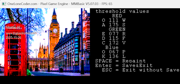

Working on the illustration for Colossal Cave Adventures has resulted in significant changes to my MMB 4 Windows tool.
The program now determines the color thresholds itself.
First, the statistical mean for each color (RGB) is calculated for 8x8 pixel blocks, then the median of this list is determined from all the values.
These values are used as the threshold values.
These values can be changed later using buttons.

sub ui
Font 2
px=w+6
do
Print@(px,0);"           threshold values"
Print@(px,20);"      RED       GREEN        Blue"
Print@(px,40);"    Q ";make$(LR);" W    E ";make$(LG);
PRINT " R      O ";make$(LB);" P"
Print@(px,60);"    A ";make$(UR);" S    D ";make$(MG);
PRINT " F      K ";make$(UB);" L"
Print@(px,80);"               C ";make$(UG);" V"
Print@(px,100);
Print@(PX,120);" SPACE = Repaint"
Print@(PX,140);" Enter = Save&Exit"
Print@(PX,160);"   ESC = Exit without Save"

sub Prescan
FOR y = 0 TO h - 8 STEP 8
 FOR x = 0 TO w - 8 STEP 8
   sumR = 0 : sumG = 0 : sumB = 0
   FOR dy = 0 TO 7
     FOR dx = 0 TO 7
       n = Pixel(x + dx, y + dy) AND &HFFFFFF
       r = n AND &HFF

LR=listR(BL%/3)      'Lower threshold Red
UR=listR(2*(BL%/3))  'Upper threshold
LG=listG(BL%/4)'Lower threshold Green
MG=ListG(2*(BL%/4)) 'Mid threshold
UG=ListG(3*(BL%/4)) 'Upper threshold
LB=listB(BL%/3)      'Lower threshold Blue
UB=listB(2*(BL%/3))  'Upper threshold
end sub
Maybe I'll give Atkinson a try after all.
 Martin

Atkinson Dithering
During the mid-1980’s, dithering became increasingly popular as computer hardware advanced to support more powerful video drivers and displays. One of the best dithering algorithms from this era was developed by Bill Atkinson, a Apple employee who worked on everything from MacPaint (which he wrote from scratch for the original Macintosh) to HyperCard and QuickDraw.
Atkinson’s formula is a bit different from others, because it only propagates a fraction of the error instead of the full amount. This technique is sometimes offered by modern graphics applications as a “reduced color bleed” option. By only propagating part of the error, speckling is reduced, but contiguous dark or bright sections of an image may become washed out.
https://tannerhelland.com/2012/12/28/dithering-eleven-algorithms-source-code.html
FN$="testapple"
' Atkinson Dithering v 0.94 - Korrigierte Randbehandlung
' Converts PNG Source Files to RGB121 BMP
' by Martin H. 2025 (with the help of the AI assistant)
Mode 1
' Read PNG header to determine image size
dim integer w, h
open FN$ + ".png" for input as #1
s$ = INPUT$(24, #1)
' Read width
w=ASC(MID$(s$,17,1))*16777216
inc w,(ASC(MID$(s$,18,1))*65536)
inc w,(ASC(MID$(s$,19,1))*256)
inc w,ASC(MID$(s$,20,1))
' Read height
h=ASC(MID$(s$,21,1))*16777216
inc h,(ASC(MID$(s$,22,1))*65536)
inc h,(ASC(MID$(s$,23,1))*256)
inc h,ASC(MID$(s$,24,1))
close #1
dim integer BL%=(h*w)/64
Dim integer listR(BL%),listG(BL%),listB(BL%)
cls
' Load source image
load png FN$+".png"
' Atkinson ring buffer (starts at index 0, goes up to W+3 for safety)
Dim integer RLine(W+3,3),BLine(W+3,3),GLine(W+3,3)
' START SCAN
for Ypos=0 to H-1
for Xpos=0 to W-1
n=Pixel(Xpos,Ypos)AND &HFFFFFF
R=(N AND 255):G=((N >> 8)AND 255):B=((N >> 16) AND 255)
' 1.GREEN (2 bits: 0, 85, 170, 255)
GV = G + GLine(Xpos, 1)
' Clipping (Zwischenwert)
if GV > 255 then GV = 255
if GV < 0 then GV = 0
' Quantization to 4 values (step size 85)
Index = INT(GV / 85 + 0.5)
' Palettenwert berechnen
CG = Index * 85
' Since the index is at most 3 (3*85 = 255), no additional clipping is necessary,
' but for robustness we leave it in:
if CG > 255 then CG = 255
GE = GV - CG ' Error is calculated from GV (intermediate value) - CG (pallet value)      GE = GV - CG ' Fehler wird aus GV (Zwischenwert) - CG (Palettenwert) berechnet
' 2.  RED (1 bit: 0 or 255)
RV=R+RLine(Xpos,1)
CR=0
if RV>128 then
RE=RV-255:CR=255 ' Error is negative, palette value is 255
else
RE=RV:CR=0 ' Error is positive, pallet value is 0
end if
' 3. BLUE (1 bit: 0 or 255)
BV=B+BLine(Xpos,1)
CB=0
if BV>128 then
BE=BV-255:CB=255
else
BE=BV:CB=0
end if
'Plot output pixel
Pixel Xpos,Ypos+h,RGB(CR,CG,CB)
' Prepare errors for distribution (1/8 share for all channels)
RE_EIGHT = RE/8
BE_EIGHT = BE/8
GE_EIGHT = GE/8
' ERROR DISTRIBUTION (Atkinson 1/8 kernel)
' 1. CURRENT LINE (Y) / RLine(F,1)
if Xpos < W-1 then ' (X+1, Y)
inc GLine(Xpos+1,1),GE_EIGHT:inc BLine(Xpos+1,1),BE_EIGHT:inc RLine(Xpos+1,1),RE_EIGHT
end if
if Xpos < W-2 then ' (X+2, Y)
inc GLine(Xpos+2,1),GE_EIGHT:inc BLine(Xpos+2,1),BE_EIGHT:inc RLine(Xpos+2,1),RE_EIGHT
end if
' 2. NEXT LINE (Y+1) / RLine(F,2)
if Ypos < H-1 then ' Only distribute if there is a next line
if Xpos > 0 then ' (X-1, Y+1) - Randprüfung für Index 0
inc GLine(Xpos-1,2),GE_EIGHT:inc BLine(Xpos-1,2),BE_EIGHT:inc RLine(Xpos-1,2),RE_EIGHT
end if
' (X, Y+1)
inc GLine(Xpos,2),GE_EIGHT:inc BLine(Xpos,2),BE_EIGHT:inc RLine(Xpos,2),RE_EIGHT
if Xpos < W-1 then ' (X+1, Y+1)
inc GLine(Xpos+1,2),GE_EIGHT:inc BLine(Xpos+1,2),BE_EIGHT:inc RLine(Xpos+1,2),RE_EIGHT
end if
' 3. NEXT LINE (Y+2) / RLine(F,3)
if Ypos < H-2 then ' Only distribute if there is a line after the next one
' (X, Y+2)
inc GLine(Xpos,3),GE_EIGHT:inc BLine(Xpos,3),BE_EIGHT:inc RLine(Xpos,3),RE_EIGHT
end if
end if
Next
' Next line, scrolling the ring buffer
for f=0 to W+3
RLine(F,1)=RLine(F,2):RLine(F,2)=RLine(F,3):RLine(F,3)=0
BLine(F,1)=BLine(F,2):BLine(F,2)=BLine(F,3):BLine(F,3)=0

Martin H.
in case anyone's interested
Further improved version, green is now also dithered in 7 steps
g≤LG    Fixed color 0    Level 1: Black
LG<g≤LG_MID    Dither between 0 and G1    Level 2: Very dark green
LG_MID<g≤MG    Fixed color G1    Level 3: Dark green
MG<g≤MG_MID Dither between G1 and G2    Level 4: Medium green-dark
MG_MID<g≤UG    Fixed color G2    Level 5: Medium green
UG<g≤UG_MID    Dither between G2 and G3    Level 6: Light green
g>UG_MID    Fixed color G3    Level 7: Full green
'MMB4W Modes etc. Loads a source PNG and translatet it to 121 RGB BMP
' V2.1
'Enter Source Filename here
FN$="london"
Mode 1
dim w, h as integer
s$ = INPUT$(24, #1) 'Get first 24 bytes (until end of IHDR header)
' Width from bytes 17-20
w = ASC(MID$(s$,17,1))*16777216 + ASC(MID$(s$,18,1))*65536 + ASC(MID$(s$,19,1))*256 + ASC(MID$(s$,20,1))
'Height from bytes 21–24
h = ASC(MID$(s$,21,1))*16777216 + ASC(MID$(s$,22,1))*65536 + ASC(MID$(s$,23,1))*256 + ASC(MID$(s$,24,1))
close #1
BL%=(h*w)/64
Dim integer listG(BL%)
Dim integer listB(BL%)
cls
load png FN$+".png"
Prescan
Scan
ui
save image FN$+".bmp",0,0,w,h
end

sub ui
Font 2
px=w+6
do
Print@(px,0);  " threshold values"
Print@(px,16); "      RED"
Print@(px,32); "   Q ";make$(LR);" W"
Print@(px,48); "   A ";make$(UR);" S"
Print@(px,64); "     GREEN"
Print@(px,80); "   E ";make$(LG);" R "
Print@(px,96); "   D ";make$(MG);" F"
Print@(px,112);"   C ";make$(UG);" V"
Print@(px,128); "    Blue"
PRINT@(px,144);"   O ";make$(LB);" P"
Print@(px,160);"   K ";make$(UB);" L"
Print@(PX,176);" SPACE = Repaint"
Print@(PX,192);" Enter = Save&Exit"
Print@(PX,208);"   ESC = Exit without Save"
do :k$=inkey$:Loop while k$=""
k$=Ucase$(k$)
select case k$
case "Q"
if LR>0 then inc LR, -1
case "W"
if LR<UR then inc LR
case "E"
if LG>0 then inc LG, -1
case "R"
if LG<MG then inc LG
case "O"
if LB>0 then inc LB, -1
case "P"
if LB<UB then inc LB
case "A"
if UR>LR then inc UR, -1
case "S"
if UR<255 then inc UR
 case "K"
if UB>LB then inc UB, -1
case "L"
if UB<255 then inc UB
  case "C"
if UG>MG then inc UG, -1
case "V"
if UG<255 then inc UG
    case "D"
if MG>LG then inc MG, -1
case "F"
if MG<UG then inc MG
case " "
load png FN$+".png"
 Scan
case chr$(13) ,chr$(10)
 Exit SUB
case chr$(27)
 End
end select
loop
end sub

@Martin,
I have a problem when transfering the pictures back to the PC when saved with PicoMiteVGA (colors/brightness change, maybe similar to your above darker picture).
But I will try to put them here anyway. However you should try it yourself on 6.01.00RC7
LOAD DITHERED "london.bmp",,,2
london_bmp.zip
The result (again, try on picomite + monitor, it looks much better that this).
Atkinson gives better result on smaller screens than Floyd. On a larger screen Floyd may be better.
Edited 2025-10-26 20:23 by Volhout

Martin H.
Hi Volhout
  Volhout said  I have a problem when transfering the pictures back to the PC when saved with PicoMiteVGA (colors/brightness change, maybe similar to your above darker picture).
The prescan sub attempts to determine the average value for red, green, and blue. First, it adds the values from 8x8 pixel squares, then sorts the determined values and uses them to determine the threshold values. In other words, it uses the median.
If the result appears too dark, too light, or the wrong color, you can use the keys to adjust the threshold values.TIf i Like to avoid dithering, I set both values directly next to each other, i.e., the upper and lower thresholds to the same value.
However, it always depends on the source material which you work on.
For photos, I would prefer Atkinson, but for other images, such as graphics, I would prefer direct conversion with possible dithering, as with the conversion of PetsciRobots tiles and sprites.
Martin

Hi Martin,
I just mentioned the option, so you could technically provide all graphics for cca in raw (24 bit bmp) format. And let the pico do the dithering. Advantage is that HDMI 2350 platforms can enjoy the graphics in 8bit (mode 3 RGB332) format and VGA users in RGB121 format. Without you having to do all the hard work twice (RGB332) when you feel to it.
How is cca progressing by the way ?
P.S. you would have guessed : I used a different "london" picture. With individual leaves on the trees, so you could see how that works out.
Edited 2025-10-26 21:34 by Volhout
