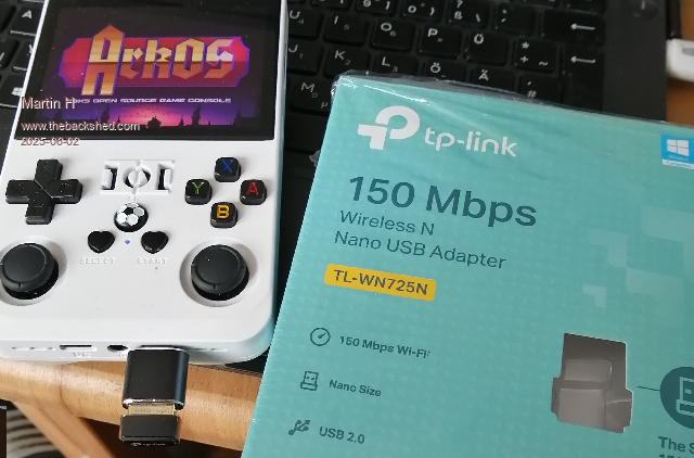

Martin H.
Tom,
I have now found a supported WIFI adapter that is supported by ArK Os.
tp-Link TL-WN725N
SSH access tested and working. I will try again later this week to work through your instructions.
Edited 2025-06-02 23:04 by Martin H.

  Martin H. said  I have now found a supported WIFI adapter that is supported by ArK Os.
tp-Link TL-WN725N
Dare I ask how many WiFi adapters you went through before finding one that worked ? - the only one I had just worked so I have no idea of the extent of the issue.
Is the "adapter" between the WiFi USB-A and the R36S USB-C a specifically OTG adapter or just a "generic" A <-> C adapter ? ... some sources assert that OTG is meaningless wrt USB-C ... but that assertion may only be valid for USB-C <-> USB-C connections.
Edited 2025-06-04 19:50 by thwill
