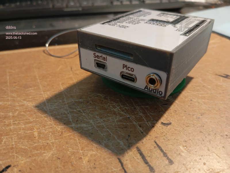

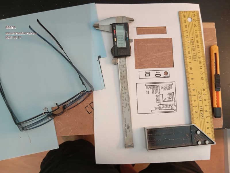

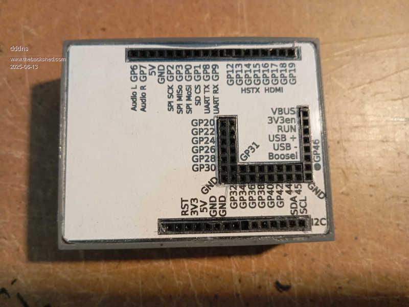

Posted: 12:55pm
13 Jun 2025
dddns
Hello All :)
I've exported the inlay from Freecad as .svg to Inkscape. Now it's easy just to position the labeling around. Only need to setup a linefeed of 2,54mm and just write it down on each row. Then I printed the first drafts on white paper and made sure everything fits.
For the cutting and tho whole process I used nothing but:
And two hours of concentration and patience:
In this very close up it looks so lala, but in reality you don't see much of it:
