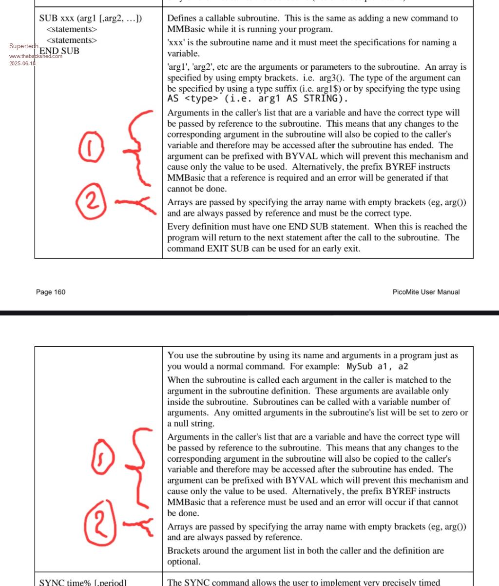

Supertech
Subs, pages 160-161
1. Seems Duplicated paragrapgh.
2. Seems Duplicated but edited.
If duplications removed, TEMPR START would not be split across pages 161-162 as it is difficult to follow read.

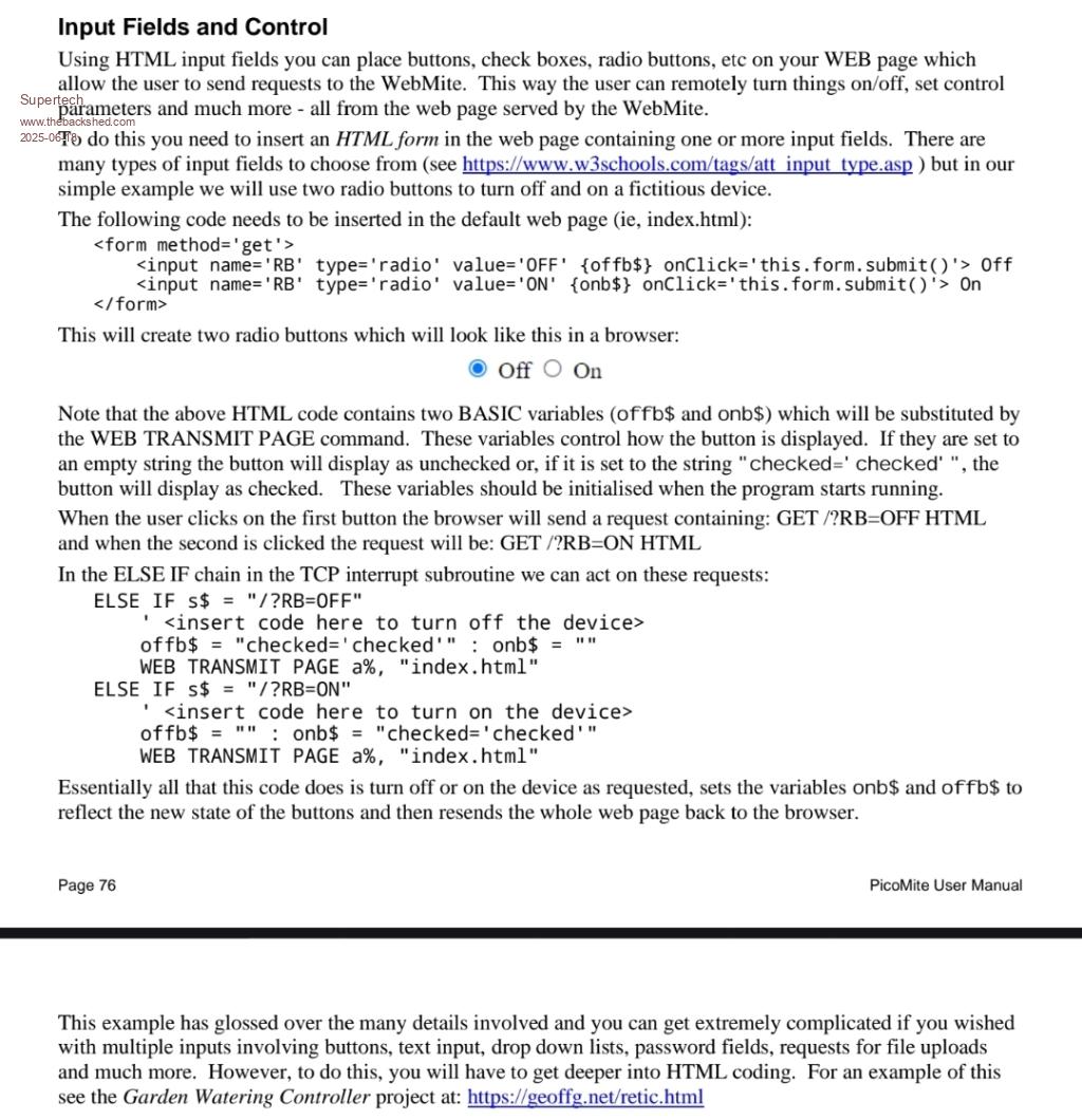

Page 76, as still in all Webmite manuals to date,
THEN this is still missing a couple of them.....hint, hint...
