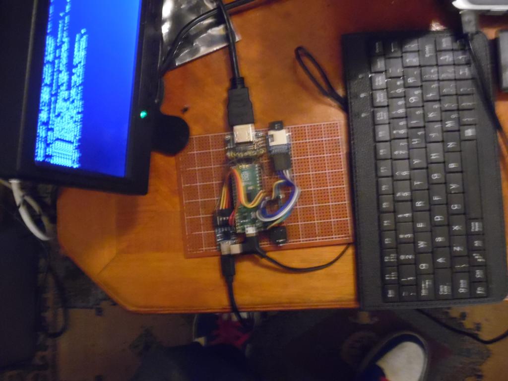

I just tried another board rp2350a usb hdmi edition v6. 01. 00b2
and mmedit-mmcc works fine, so this and an 2350 ili9341 with beta software work but not this latest version.
As it's usb it uses a usb to ttl converter on serial console. I used gp20,gp21 and it worked before this latest version.
I changed the options, added sdcard but tried option serial console com2,gp20,gp21
got Error : Invalid pin
latest version loaded on linux then win 11. hdmi usb 2350a version not right maybe?

Not sure, but console uart was fixed at gp8, gp9 on pico usb , right?
Posted: 06:05pm
27 Mar 2026
  Volhout said  Not sure, but console uart was fixed at gp8, gp9 on pico usb , right?
Volhout[/QUOTtE]
This is interesting as serial usb to ttl worked on gp20,gp21 but this has options set for gp8,gp9.
I swapped the usb ttl gp20 for gp8 and gp21 for gp9 and mmedit works.
option list
PicoMiteHDMI MMBasic USB RP2350A Edition V6.02.01
OPTION FLASH SIZE 4194304
OPTION COLOURCODE ON
OPTION KEYBOARD UK
OPTION RESOLUTION 640x480 @ 252000KHz
OPTION SDCARD GP2, GP6, GP7, GP4
OPTION AUDIO GP0,GP1', ON PWM CHANNEL 0.
happy days but strange and time waste.
when did serial on gp8,gp9 only happen, if it did?

Just tested: PicoMiteHDMI MMbasic USB RP2350A Edition V6.02.01 and PicoMite MMbasic USB RP2350A Edition V6.02.01
By typing OPTION SERIAL CONSOLE GP20,GP21 the console moves to GP20 / GP21 as requested, also works with GP4,GP5 (option serial console disable is also not required)
It is the case that the serial console defaults to GP8,GP9
Good luck
Lyle.

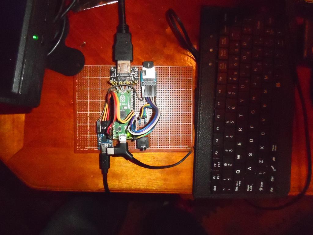

Posted: 03:58pm
28 Mar 2026
Lyle, you had more luck than me. I don't know where the option list came from on latest release. The board was set wired for the usb to serial converter to use com2,gp20,gp21.
mmedits mmcc terminal didn't work.
used the usb keyboard and otion list to show com2 set to gp8,gp9 and setting other pins still gives error : invalid pin.
still it works but as the usb to ttl is mounted on one side of the pico I wanted to use ports on that side. now leads cross over the pico. omg end of the world
looked a bit tidier before. maybe get it back one day to gp20,gp21
Edited 2026-03-29 02:24 by stanleyella
Posted: 08:29pm
28 Mar 2026
Stan, perhaps you have been typing this -  OPTION SERIAL CONSOLE com2,gp20,gp21
Leave out the com2, just type this:-
OPTION SERIAL CONSOLE GP20, GP21
Both Lyle and I have shown this works.

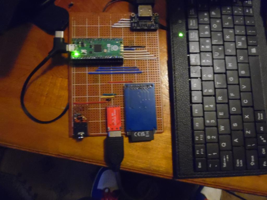

Posted: 09:57pm
28 Mar 2026
@phill99, thanks.
I updated latest mmbasic to another usb hdni 2350 and it used gp8,gp9 . This was no problem this time.happy days. mmedit/mmcc working fine.
sorry no pcb, bread board next :)

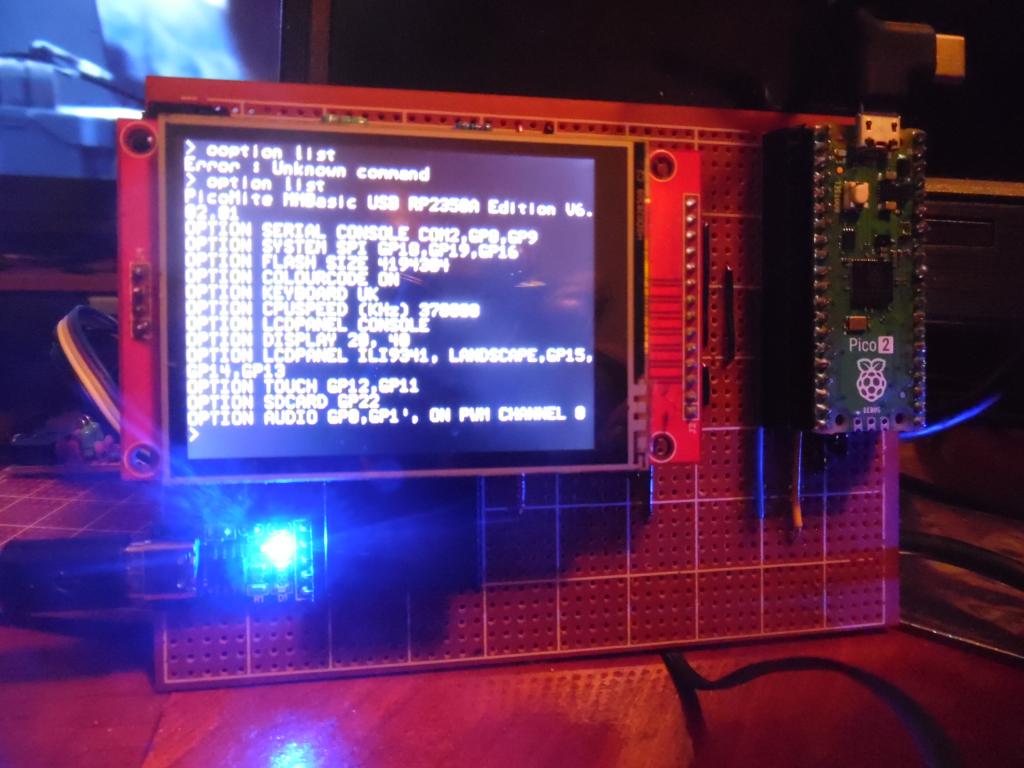

I tried picomite 2350 usb on ili9341 and "eventually, 3rd flash firmware" mmcc let me type the options and it's like before, ie works.
I forgot how I got it working the previous beta, downloaded tera term cos I remembered it. doh
> option list
PicoMite MMBasic USB RP2350A Edition V6.02.01
OPTION KEYBOARD UK
OPTION CPUSPEED (KHz) 378000
OPTION LCDPANEL CONSOLE
OPTION DISPLAY 20, 40
OPTION LCDPANEL ILI9341, LANDSCAPE,GP15,GP14,GP13
OPTION TOUCH GP12,GP1.1
OPTION SDCARD GP22
Posted: 11:37pm

I used mmedits-mmcc connected usb to ttl converter to serial com2,gp8,gp9 and entered each option and didn't lose usb so didn't reconnect.
