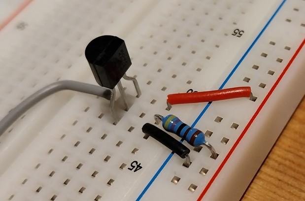

Posted: 02:31pm
25 May 2026
Peter63
Hello, Phil99
Have connected a DS18S20 (Power mode parasitic)
I have about: 25 degrees in the room, but get 69.8125 from the routine.
Do you have any ideas why?
/Peter63

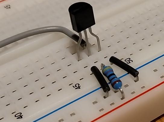

Posted: 03:30pm
25 May 2026
try not using parasitic/phantom power; connect the Vdd pin to 3v3. also, are you sure that resistor you are using is not 470 ohms? the fourth band should be brown, while in your photo it looks closer to black.
rob   :-)
Posted: 05:25pm
25 May 2026
Peter63
I have connected the DS18S20 with external power supply.
But I also had to change a little in the program code to make it work.
Attaching the new version here...

  Quote   are you sure that resistor you are using is not 470 ohms? the fourth band should be brown, while in your photo it looks closer to black.
Jepp, 4.7Kohms
/Peter63
Edited 2026-05-26 03:27 by Peter63

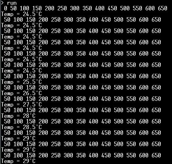

Posted: 06:42am
28 May 2026
A dreary day, so playing indoors. Had a go at condensing the Function.
Using the example data in the datasheet I am reasonably confident this will give 0.5°C resolution correctly with a real DS18S20, but the method for extending the resolution to 1/16° shown in the datasheet looks strange to me and there is no example data given for that.
If you have the time and inclination could you test this?
At the end of the Function there are 7 decoding versions.
1) 1/2 degree resolution - this should work
2) 1/16 degree resolution - using the equation in the data sheet, might work.
3) Same as above for positive temps. but if negative temps are wrong it might be better.
The test is:- does the part after the decimal point increment / decrement smoothly with a slowly changing temperature? If it jumps about I have got it wrong again.
A check below zero would also be good. Something from the freezer touching the sensor perhaps.
4) to 7) If that doesn't work try these.
Function DS18S20test(PinNbr As INTEGER) As FLOAT
' derived from DS18x20 test code by TassyJim
  Local INTEGER  T1,T2,c,d,e,f,T3
  OneWire RESET PinNbr                       ' reset before command
  OneWire WRITE PinNbr, 8, 2, &hCC, &h44     ' start conversion
  Pause 750 'mS = maximum conversion time
  OneWire WRITE PinNbr, 1, 2, &hCC, &hBE      ' command read data
  OneWire READ PinNbr,0,7,T1,T2,c,d,e,f,T3     ' get the data
'  Print "Data Output - T1";T1,"T2";T2,"T3";T3
  DS18S20test = Str2bin(int16,Chr$(T2)+Chr$(T1))/2 '0.5`C resolution - correct with sample data from datasheet
'  one of the next 2 should give 1/16`C resolution acording to datasheet, one may be wrong with negative temps, try both
'   DS18S20test = Str2bin(int16,Chr$(T2)+Chr$(T1))\2 -1/4 + (16 - Str2bin(int8,Chr$(T3)))/16
'   DS18S20test = Str2bin(int16,Chr$(T2)+Chr$(T1))\2 -1/4 + (16 - T3)/16
'   If those don't give smoothly changing fractions for a slowly changing temperature try these
'   DS18S20test = Str2bin(int16,Chr$(T2)+Chr$(T1))\2 -1/16 + (16 - Str2bin(int8,Chr$(T3)))/16
'   DS18S20test = Str2bin(int16,Chr$(T2)+Chr$(T1))/2 -1/16 + (16 - Str2bin(int8,Chr$(T3)))/16
'   DS18S20test = Str2bin(int16,Chr$(T2)+Chr$(T1))\2 -1/16 + (16 - T3)/16
'   DS18S20test = Str2bin(int16,Chr$(T2)+Chr$(T1))/2 -1/16 + (16 - T3)/16
End Function
If none of those are accurate could you get some sample data for me?
After the "OneWire READ PinNbr,0,7,a,b,c,d,e,f,g" line there is a debug Print.
Edited 2026-05-28 16:47 by phil99

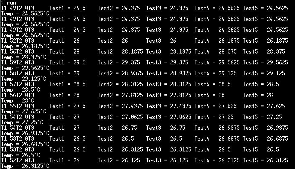

Posted: 01:52pm
28 May 2026
Peter63
I have tested the new version, this is what comes back as a response.
> run
Data Output - T1 48     T2 0    T3 15
6144
Data Output - T1 48     T2 0    T3 14
6144
6144
6144
6144
6144
6144
Data Output - T1 48     T2 0    T3 13
6144
6144
At the time of testing, I have 24 degrees in the room.
/Peter63

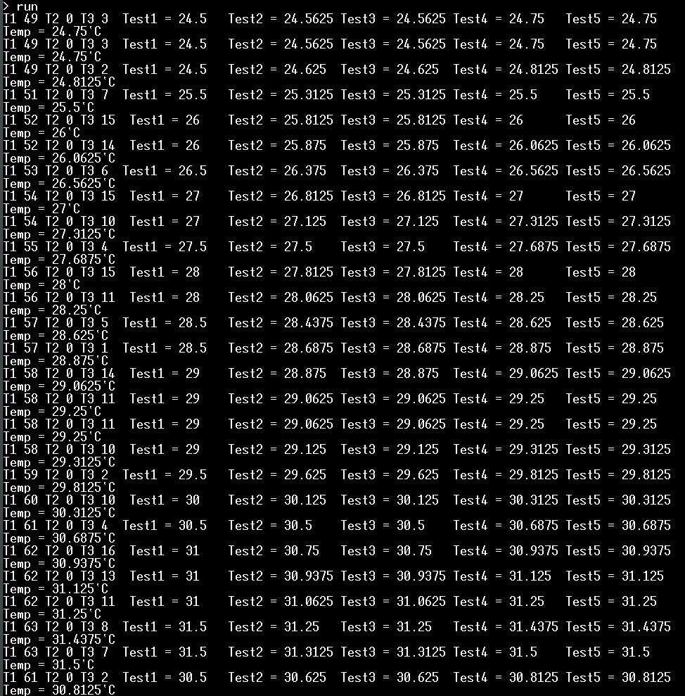

Posted: 02:15pm
28 May 2026
Peter63
Tested all variants:
' --- test loop ---
Print DS18S20test(MM.Info(pinno GP7))
Pause 2000
End
' test1
' test2

29 May 2026
Peter63
Tested the new function, it gave this out:
Then I tested the other program:
And finally I tested the last program:
Seems like it works...
/Peter63

Posted: 01:52pm
29 May 2026
There are a lot of gaps in the test data, a slower rate if increase or decrease would be needed to fill them. Plus the T3 values.
However I think this is the most likely high res. output line for the first program:-
DS18S20 = Str2bin(int16,Chr$(T1)+Chr$(T2))\2 -0.25 + (16 - T3)/16
And this for the second:-
Value = Str2bin(int16,Chr$(T1)+Chr$(T2))\2 -0.25 + (16 - T3)/16
After all that this is as per the datasheet.
I had imagined the high res data would simply add the fractional part to the low res value.
But instead it appears the high res goes from 1/2° below the low res value to 1/2° above the low res value, with T3 going backwards from 20 to 4.
Posted: 03:46pm
29 May 2026
Peter63
here comes a new run with T3 values...
/Peter63
