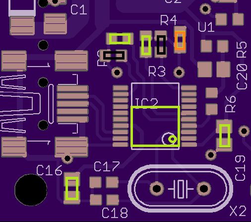

The mcp2221a uses the lower 14 pins of the 20 pin footprint - pin 1 is the same for both. So the 1455 *should* be ok doing the same.
ed-You can see the 14-pin ic placement on the photo, you have to magnify the screen a bit, I'll rustle up a diagram as well.
The serial i/o lines use three resistors as isolation safeguards, two are a
voltage divider to drop the 5v from the serial chip to the pic32 3.3v, the other is just a safeguard for the 3.3v from the pic32 to the serial chip. Two of these have different placements connecting to the 14 pin and 20 pinners as the i/o pins are different.

i/o via the 14 pin uart, eg mcp2221a or pic1455 : this shows the component placements in green.
Use the two green resistor placements instead of the black. The orange
one is the same regardless.
The crystal, etc, are only required for the older mcp2200...time to save some space by chopping that option I think...Edited by chronic 2017-02-10

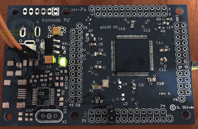

Hi Stuart,
I have build a bare bones sn7x with the board you sent. It works so I have progressed to SMD 0603 and 100 pin chips now. Holding them with a small flat screwdriver is the trick, but still hard to get them straight as you can see.
A couple of things that had me scratching my head.
1. The circuit diagram has R1 and LED1 shown in reverse order to how they are connected on the board. i.e 3.3v --> R1 --> LED1 --> GND on the circuit but

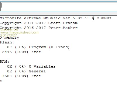

3.3v --> LED1 -->R1 --> GND on the board. This showed up when I was trying to work out which way around to put C2 and C3.
2. I assumed I could just connect the console to pins 57/58 as these went to the MCP2221a which I did not install. On power up it would not talk to me. The MMBasic watchdog on pin 99 appeared to be pulsing indicating it was running. The Extreme manual says the console is on 85/86 for the 100 pin MZ chip so I tried the console on 85/86 and it talked OK.
Can you confirm whether it would work via the MCP2221a if it was installed or does it need to go to the console pins too?
Gerry
Posted: 02:49am
27 Mar 2017
isochronic
Good to see ! Thanks for having a go, and the feedback
1) Reverse order of led/resistor - I think you are right on that, my apologies. I will update the schematic so it makes more sense.
2) The usb-console connection runs via usb-direct. To use that,
there is a 0 ohm "resistor" link (ie wire) (U4) to supply power to the pic ic usb , and also a 1k resistor (U3) connecting the pic to the usb line. Put those in and
you should be able to connect up via the usb-direct (socket on other side of board).
The usb-serial bridge on 57/58 was designed to be an auxiliary serial bridge,
for other software. However I think the Micromite COM3 serial connections should
be able to use it as well (I think there is a basic redirect command to connect via com ports - (??) others would know a lot more here).
*(ed)* There is also some flexibility built in. Above the mcp2221a there are two vias that you could solder the pic RX/TX i/o to, and there is a point where the
2221 RX/TX tracks to the 57/58 pins can be cut, er, disconnected easily. So other pins (eg 85/86) could use the 2221a OK as well I think. Let me know if you need more info there.
3) I hope that is 5v in , only..Edited by chronic 2017-03-28

OK makes sense now.I have not used the usb-direct before so missed the point its where the USB console that MMBasic understands lives and that the MCP2221a is an additional USB-Serial adapter currently connected to pins 57/58 which is COM3 in MMBasic.
If you revise the circuit diagram in might be worthwhile to show the MMBasic console pins 85/86 on the chip.
Yes only 5v on those connects you see.
Gerry
