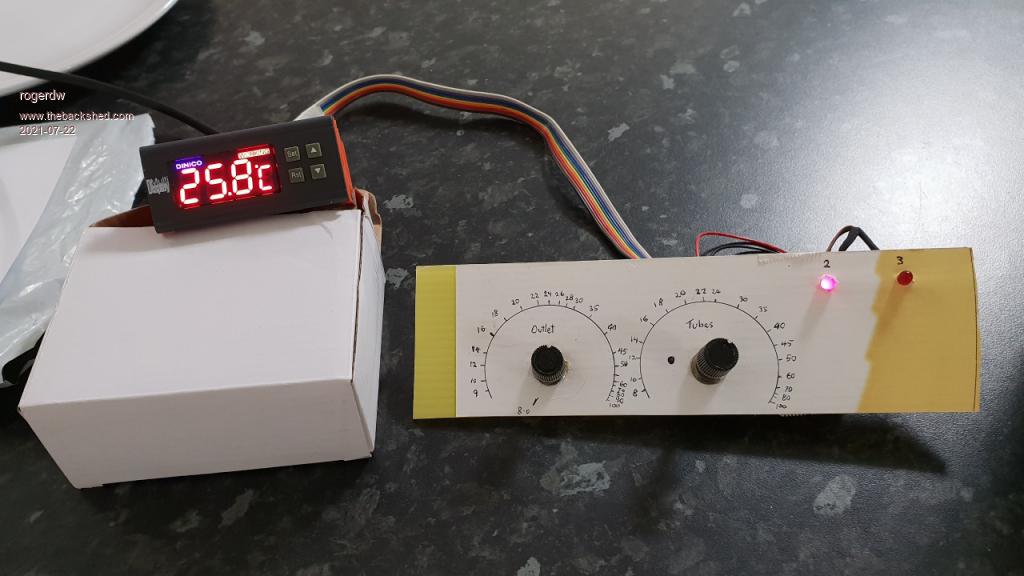

Well I did as you suggested, and played with the device. Almost felt like I was getting the concept, but it still alludes me. Bit like my 60 y/o tractor  ...  a couple of pops and bangs and a cloud of black smoke  ...  but not starting yet!
I need to substitute the sensors for a couple of 'calibrated' pots  ...  and fit a 12v light globe on the output relay  ...  then I reckon I'll get a grasp.

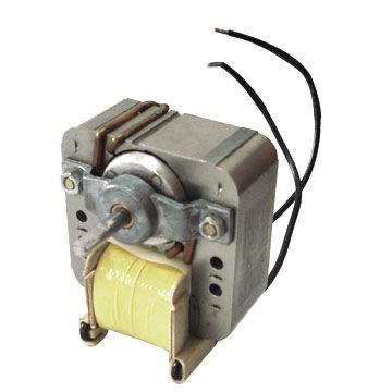

The motors in these exhaust fans are of the shaded pole type, with a single 230v winding.
Its not possible to reverse the motor electrically.
What needs to be done is the rotor needs to be removed by taking out two long bolts, and turned around, so drive shaft sticks out of the back instead of the front.
Then if the whole motor is turned around and reinstalled in the housing, the fan will turn in the opposite direction and blow air instead of extract air.

Okay, so I've finally just fitted this controller  ...  and I set it how you suggested Tony  ...  with the Ld at 5 degrees and the Hd at 15 degrees. You've been spot on with everything else so far, so I need to listen for a change.
Yesterday was our coldest, darkest, wettest day so far this winter  ...  so I didn't get anything from it.
The highest I saw in the tubes was 24 or so  ...  but turning on the fan still had the output at around 15  ...  so switched straight off.
This morning on the other hand is back to a nice sunny day. By the time I wired it up it was 11:30 and the tubes were up over 90 degrees  ...  actually over 110  ...  because even the differential controller is showing an error on the tubes temp sensor and its maximum reading is 110.
I've put the fan onto high speed because I (hopefully) won't have to keep an eye on it myself any more  ...  and let the control do its job.
When I first fired it up  ...  the outlet went up to 60 degrees within seconds and as high as 88 degrees inside a minute.
After 15 mins or so  ...  the tubes had dropped to 61 and the output 50.
I suspect the output will drop to 30-35 if the sun stays out  ...  or nose dive if it gets cloudy.
20 mins later  ...
Well, I just had another look and cloud has come over and tubes have dropped to around 30  ...  and the outlet is around 28.
I realised that because the room is still only 16 degrees  ...  5 degrees on the controller means that it will keep pumping until the tubes are down to 21. That is too cold, coz the outlet will be a degree or two below that  ...  maybe 19.
So I reset the Ld to 10 degrees  ...  and I watched while the tubes dropped to 26.3 (room 26.4)  ...  and the fan switched off!!!
Now I can wait until the cloud moves, and the tubes get back up to around 31 when the fan should come back on.
Haha  ...  and while I'm typing this I realise the fan did come back on already. I went and had a look  ...  and saw that the temp was dropping again.
Amazing, this is working exactly like it's supposed to. When it switched off  ... the outlet was pumping at 24.8. May be a couple degrees too cool  ...  but getting close already. Just needs fine tuning like you said Tony. I know, I know, oh ye of little faith!
It's done a couple cycles already  ...  I can hear it from here. Amazing.
Posted: 03:11am
23 Jul 2021
Fantastic progress there Roger, it might need a little tweaking still, but basically sounds like you have a goer.
