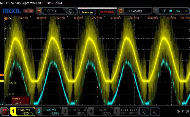

For some time now in the last Inverter and power board, I've been chasing some high frequency noise and ringing, this followed across to the New dual inverter, the boards only have ferrite beads on one side in both boards.
So I wanted to try the power board's with all ferrite beads fitted, see if it makes a difference.
In the dual inverter, the noise appeared to be more noticeable from one power board, but due to the radiating nature of this noise, it was proving hard to pin down.
I spend the past couple of days building two new power boards, the ferrite beads I used are not as thick or as long as wiseguys original, so inductance will be different, but these beads should make some difference, and they allowed me to mount one power board straight to a big flat heatsink, so didn't need to build up a set of spacing bars.
Test mode is your safety net for testing without damage, use an adjustable power supply, I set the current limit to around 400ma, and start the voltage at 10V and slowly increase it looking for any sudden jump in current, the LCD will indicate some AC output even at voltages around 13v to 16v.
I found one power board made the Test Inverter setup draw twice the idle current, as the other board, I traced that to an incorrect resistor value on one Opto coupler
The result is the waveforms are now really good and all the noise has gone, but more testing will be needed to see the real impact of the ferrite beads, and if the smaller beads are suitable.
A benefit of reducing the noise, the idle current is now slightly less.

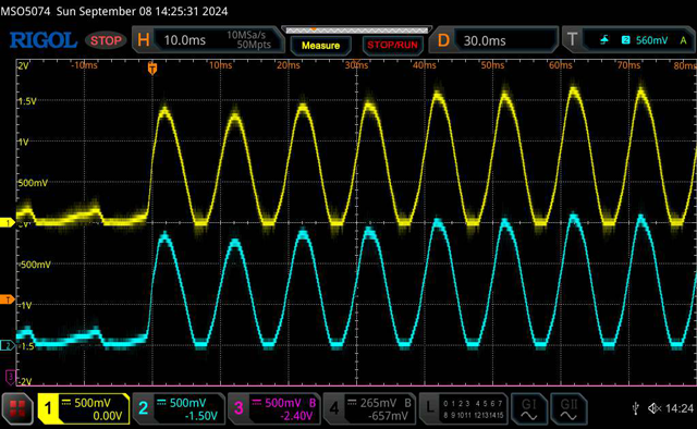

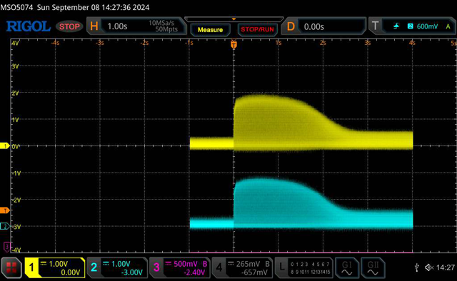

Current sensor on the DSO are now really clean, DSO captures of the compressed startup current waveforms are now a clean smooth envelope.
Old boards 240A per power board (480A total input):
New boards:
Old Boards : Current sensor zoomed
New Boards:

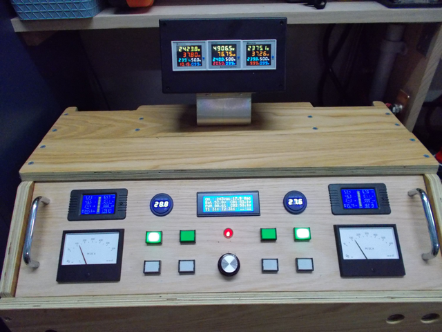

Finished the Triple multi function AC output monitor.
It's that black housing on a tilted stand that sits on top of the Inverter, the stand simply slips over the rear top section of the Cabinet.
I wanted all AC wiring to take a direct path straight out the back of the Toroids, these and the 4 chokes and AC filters sit in the bottom of the cabinet. I'm Trying to keep Inverter HF noise from the choke cables and DC "cables" from radiating into the AC, especially after it had gone through the AC filtering stages, so no AC monitors or wiring in the wiring looms or anywhere near the Front Control panel.
Power stage 1 AC on the Left, stage 2 AC on the right and combined AC power & current in the center.
BTW that's showing a power stage delta of 48 Watts at almost 5kW, it varies between 28w to 48 watts at 5kW as the AC meters have different sample and update times, and the load is varying slightly.
It's now evening and the Inverter has been at 5kW for 45 minutes, up from it's normal daytime 1kw to 4kW, heatsinks sit at room temperature all the time (28° to 29° ATM), both Toroids still at 31°, they vary between 31° and 35° throughout the day - the Toroid cooling fans have not come on as yet in this dual power stage inverter.

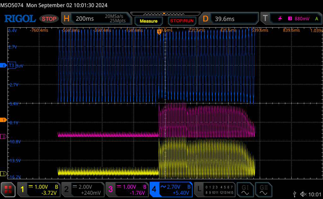

My suspicions were correct:
I remembered back to the tests I did changing the residual flux of the Toriod with the flick of 1.3v cell, which changes the so called Cap+Toroid "Resonance frequency" by -30Hz to +100Hz for the same value of secondary Cap.
Step 1:
I replaced each NTC position with two 47R 5W resistors - they could be 1 watt if using a small delay, however as I'm manually switching and can hold the Pre-Flux state for any amount of time, I used higher wattage R for this test.
I chose a high total value of around 100R because I wanted to verify the possibility that all we are really doing is just getting the Stage-2 Toroid to play nice before connecting it across the AC output of Stage-1, and not trying to get it to 240AC.
Step 2: I removed the Capacitor boards from Power Board 1, I replaced them with a 10uF AC CAP, this 10uF cap was to help dampen any ringing and noise when running the 1st Power Stage without CAP boards.
CAP boards were removed so that the Hall DC current sensors would register the TRUE current drawn by Power Board 1, and not be fooled by the CAP bank discharge current.
The Result:
Nothing much changed - Current draw through 94 ohms is very low in the Pre-Flux stage.
Delaying a second or so before closing RL2 (shorting the Resistors) was exactly the same as before.
Flicking the switch as fast as I could from off to RL2 energized made a worst case 50A PEAK draw, but 5 out of 8 times it would hardly resister a current reading, but with a load there is hardly any current spike when switching as fast as I can, and for as many times as I tried.
The 2nd Toroid appears to prefer a fast Pre-Flux time, 200ms to 300ms I think wiseguy was thinking of and that sounds about right, a longer time has no benefit and sometimes causes a slight current spike on the DC peak meter.
Stage-1 Idles at 31 watts - it's powering the Inverter electronics including my small fans etc.
Switching Stage-2 on only increases Idle power by 21W, which from memory is around the magnetizing power I measure for these stacked Toroids on the bench - I will have to check.
