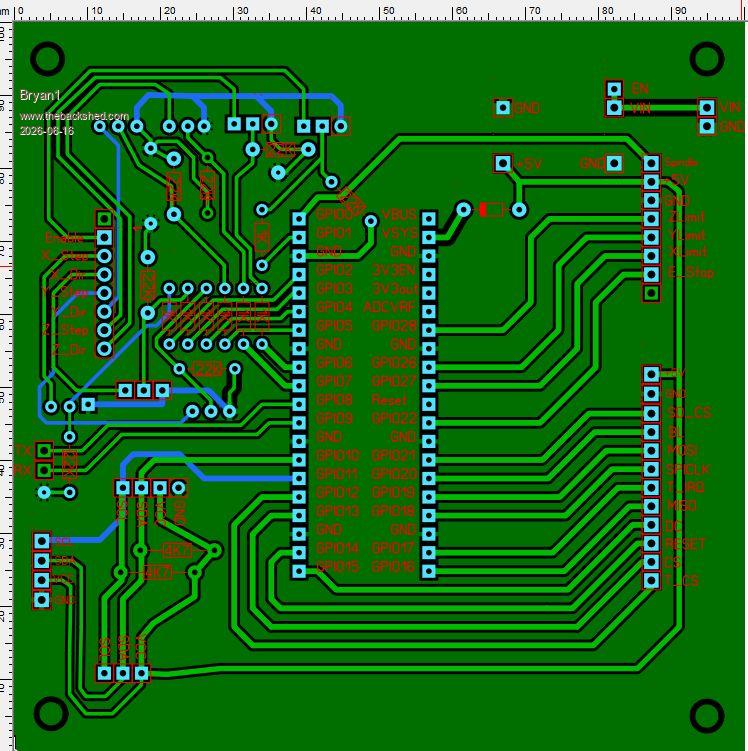

Just looking back over some things and couldn't figure out why the steppers won't enable. This might be a problem:
I think this has the Enable permanently tied to 3v3. Hopefully an easy fix
Regards, Lyle.

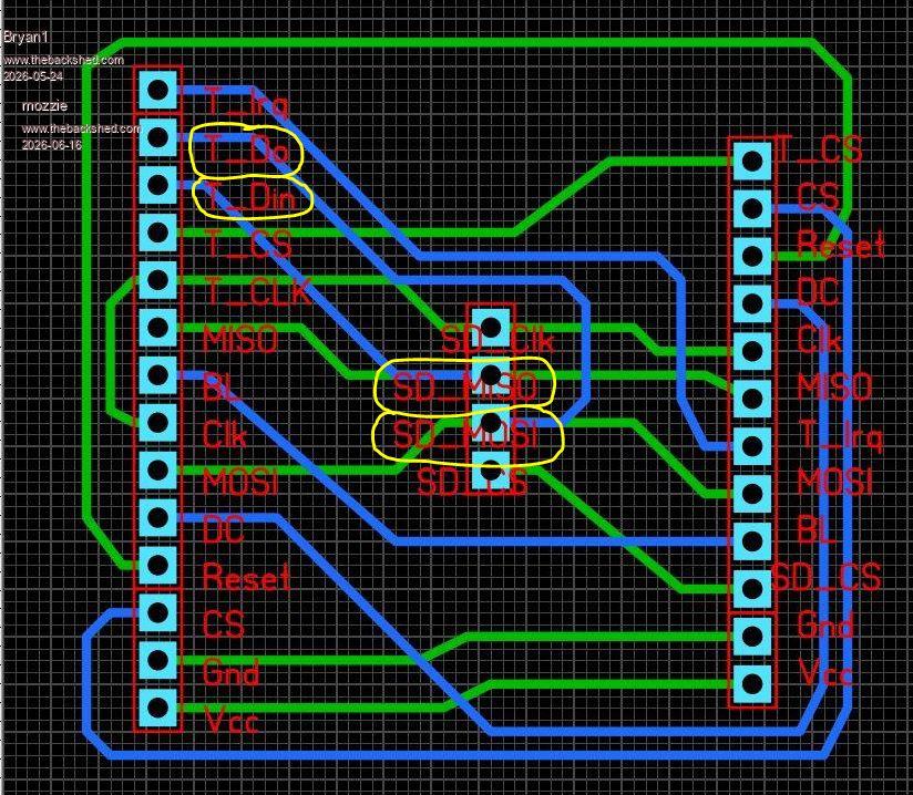

A close look at the LCD PCB and it looks like:
MISO is connected to Touch-DIN
MOSI is connected to Touch-DOUT
This could be causing some grief
Regards, Lyle.

Thanks for pointing out that mistake I made Lyle   I changed the SDCard 4 pin header to a 90 degree pin setup and put it under the pcb then cut both tracks and soldered in jumper wires the correct way.
I did put V3.00RC19 on and doing B: files did show the SDCard contents but trying to set the time on the RTC is still going the "not found" error.
Now as the boards only cost $3.50 for 5 of them   I'm going to get on and correct the error of the SPI lines which should make a nice no bones backpack for the LCD's.
Regards Bryan

The 3 I2C sockets are wired correctly to each other but are the wrong way round at GP10 = I2C2 SDA & GP11 = I2C2 SCL.
If you consider getting new boards made perhaps add a ground pin to the bottom socket.
While you are at it there appears to be room for pads for pullup resistors on SDA and SCL. You may never need to install the resistors but it costs nothing to add the pads, just in case.

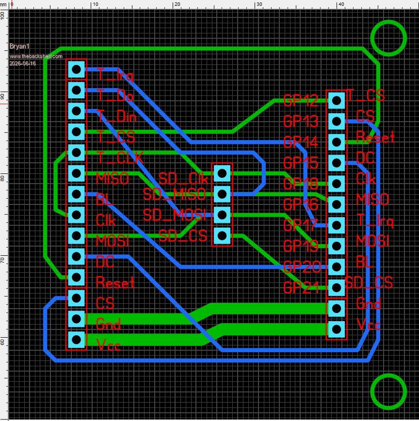

Ok it does seem these grey cells got both boards all wrong so just got on and ammended the mistakes on both boards.
Now with the LCD board moved the silk screen for the SDCard connector so one can see them and swapped over the SPI lines.
On the stepper board corrected the I2C lines, put in pullups also put GP1 which is the Enable pin to ground as tying it to Vcc stopped the steppers being armed. Also with the step and limit connectors added a non connecting pin to make them a 8 pin socket as 7 pins sockets aern't around.
Also one thing I need to do with every board which I neglected to do was put in mounting holes so they were added.
V2 Stepper Board
V2 LCD Board
Now rather than rush ahead and order these boards if I have gotten something wrong again could it be pointed out please.
Regards Bryan
