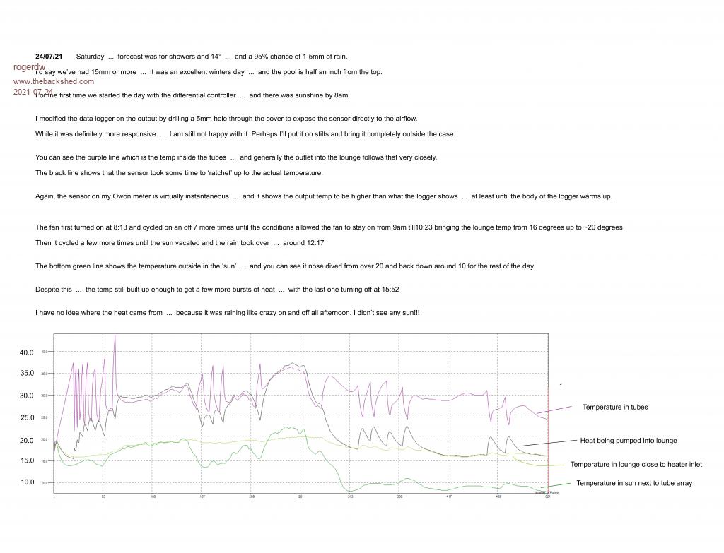

I haven't posted any charts for a while but thought it was worth showing how things look with the new differential controller looking after things. Thanks Tony.
Hopefully tomorrow's will be better again seeing it can be ready to go with the first sunlight  ...  assuming of course that we do get some.
And I really do need to pull apart another of the data loggers and fit the sensor externally, so I get quicker and more accurate readings. At present it takes 8-10 mins to catch up  ...  and if there are any wild swings it misses them altogether.
I might go out and modify one now  ...  and be ready for the morning.

I don't know if this is a normal winter or not for us over here  ...  but I have been amazed at how many days the sun does shine at least for a few hours  ...  and how few days it is grey and overcast all day.
Another observation is that it doesn't seem to matter how cold the ambient temp is  ...  if the sun shines, we can pump heat.
At present I have 18 tubes and the new one will be 60  ...  so potentially 333% higher  ...  plus being on the roof, will not be shadowed by the fence in the mornings and later afternoon.
It started off early this morning, soon after 8 am  ...  though I wasn't able to concentrate much on what was happening. Seemed like it maybe should have been allowed to build up more heat before it came on  ...  I'll have to look at the data tonight to see if it makes more sense.
I did crack open the logger that sits at the warm air outlet and drilled a hole so the sensor is exposed directly to the airflow  ...  so will hopefully be a bit more responsive.

Okay, well I thought this mornings figures were a bit dodgy  ...   but while I had drilled the outlet data logger case to expose the sensor to make it more responsive  ...  and it does seem a bit better  ...  it still seems a little slow.
I might bring it right out on stilts into the airstream to see if that helps.
Apart from all that, it looks like the system is working very well
With the conditions we've had since the rain set in at lunch time, I normally would have just turned it off  ...  but like you suggested Tony, the system still managed to eke out half a dozen more bursts of heat that I would have missed out on.

Thanks Dave. It did actually start out very well because of the early sun  ...  and took the room from 16 degrees up to just over 20.
Then of course when the change came through and the outside temp dropped considerably  ...  the guts dropped out of it.
I need to address that data logger because I was getting away with its sluggishness before  ...  because it used to have time to catch up to the changes in temperature  ...  they were long slow changes   ...
...  but now that the temp goes up and down over only a 5-10 min cycle  ...  the device takes far too long to respond and reads 5-10 degrees too low sometimes.
If I could use my good meter to log the readings, it would look far better.

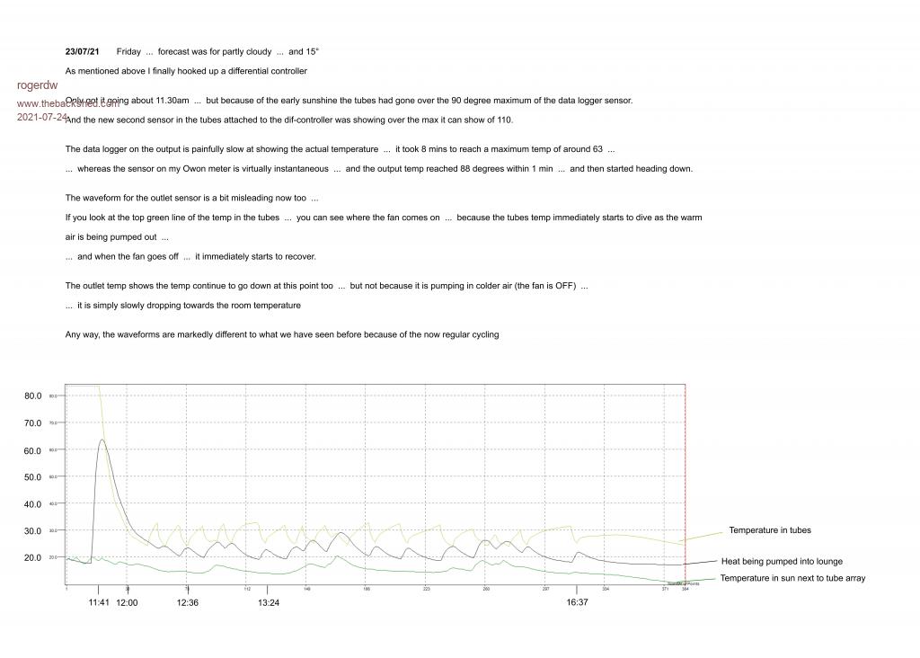

So today, a higher output would have been around lunch time before the rain started.
Air Velocity 4.0 m/s x
Outlet Duct C/S Area = .01779 sq/m x
1000 x
The outlet temp was 37 degrees minus inlet of 21 degrees = 16 degrees
4.0 x .01779 x 1000 x 16 = 1,138 watts
Yesterday when I turned it on late in the morning and the output was 88 degrees  ...  minus the input at 16 degrees = 72 degree difference.
4.0 x .01779 x 1000 x 72 = 5,123.5 watts
Of course that was only an instantaneous reading because it very quickly dropped back as it removed the stored heat from the tubes  ...  but it was still pretty impressive standing in front of the duct pumping out that level of heat.
I like to imagine the new one at 3.3 times that output  ...  though that sounds almost dangerous  ...  but I'll be happy if it can be pumping out 3 or 4kW on a regular basis.

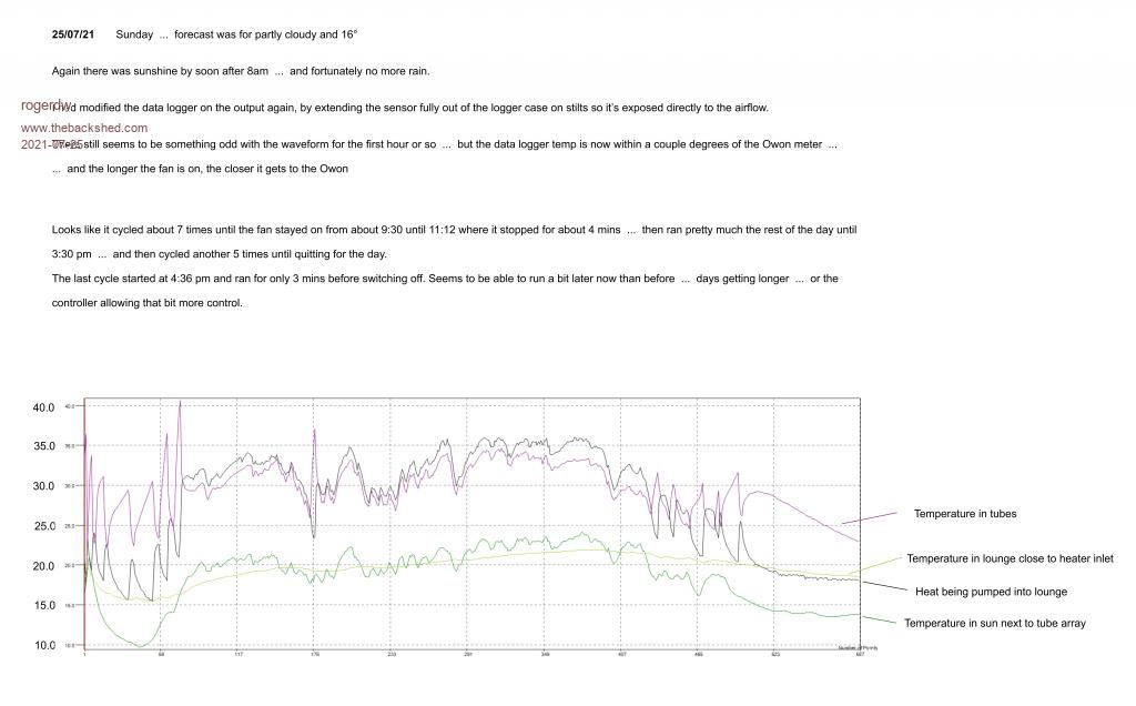

rogerdw
  Warpspeed said  Wind and a low outside temperature should have little or no effect, the only real killer will be big black nasty clouds that block the sun.
Yes, that seems the case.
What surprises me most is it doesn't seem to need direct sun either  ...  just light  ...  though of course the output is not that spectacular until the sun pops out.
My modified data logger is working better than yesterday  ....  much more responsive  ...  though still 2 degrees below for a minute or so  ...  and finally as close as .5  if the fan runs for long enough.
Looking forward to seeing the chart tonight.

Posted: 09:44am
25 Jul 2021
rogerdw
Here's todays figures. Was a nice day  ...  cool enough, but sunshine on and off all day.
Nice to see the lounge temperature go from 16 degrees up to 22 degrees.
The charts are certainly quite different to before fitting the differential controller, with the switching on and off until the sun is sufficient to allow the fan to run continually  ...
...  and then later in the afternoon as the sun reduces and it comes in cooler  ...  then the fan switches in and out again until it gives up for the day.
Another thing I should mention is that I have had the fan switched to high speed ever since fitting the differential controller. Just about all my graphs in the past were with the fan on the low setting  ...  except on really sunny days.
Something that seems odd is the temperature of the outlet into the lounge is higher than the temperature in the tubes during the middle of the day. Not sure how or why that is happening.
