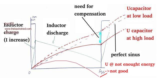

Further comment re Bret76. re reading your post a number of times I think we are saying similar things but with the translation a bit more difficult to fully interpret.
You did allude to, with the 20kHz periods and your diagram that there was a difference between where we are (without the heavy load) where we are with the heavy load and where we need to be with the heavy load.
I believe that using a DSP or similar really fast number crunching ability yes we could make corrections on a 20kHz cycle by cycle basis, so we are correcting for load changes on the very next on/off period, but I know my limitations and that stuff is on a whole different level.
Yes there is a definite tradeoff compromise between the inductor, mains capacitor, acceptable ripple on the output voltage waveform, idling current etc.

  bret76 said  According to the calculations I'm trying to do (L, U, R in parallel), KeepIS seems to have found a very good compromise on its inductance value! And unless I correct the sinusoid every 50µs, I don't see how to do better!
I should have replied to bret76 on how I finally settled on the Choke values and the compromise.
I literately spent months over the past few years winding chokes and testing saturation levels. Looking at low and high power load waveforms for various inductance and core material, until I found the sweet spot, and that was spread across building three different Inverter.
Interestingly, the final chokes turned out to be the best choice for each of the different electronic designs of Inverter power-stages and controllers when they were retested - I still have them.
As wiseguy said, it is always going to be a tradeoff.
The tradeoff was between low power efficiency and perfect idle AC waveforms, OR making the Inverter live under ridiculous levels of startup loads and running high power loads.
I chose the latter
Sometimes you just have to do the hard boring repetitive work of just testing the dam things under the conditions that you hope/want it to survive
99% of the time the waveforms are identical and good, and then that 1% shows up like that waveform, for me the 99% rule applies.

bret76
@wiseguy : we agree.
Maybe for a short time after the current spike, the tuning is not optimal (but it works, so perfect).
What I mean is that with a no-load tuning, adding all the 20Khz steps together, we will get a nice sinusoid.
But changing the current without changing the tuning, the sinusoid will be different.
And if a too small energy is stocked in the L+C, will be flat before endding the 50µs, so an inductive the load can try to push current back to the inverter -> big oscillations ? New add on my manual oscilloscope
We are  here in particular conditions : big step in power (in a normal house, step will be lower because of multiple loads and lower loads), long time before PWM actualisation (like keepIS say : the only one like this).
@KeepIS : I'm not trying to question this inverter or the work implemented, but rather my understanding.
I spend a lot of time reading the hours you and others spend in testing, but still sometime not clear to me / like : "ok this value worked for me" (but why ????? How dit you find it ???).I don't have your experience to develop an inverter, and I'm not sure I'll get there yet. So I have to try to understand at least a little bit how it works.
Can you confirm : for 1 stage (one toroid) you have something like 2x23µH + 2µF or 4.7µF
If possible, can you also put me the PWM values of a similar conditions (low load / big load). Steady state is ok.
I have the feeling that the sinusoid may be a little distorted - at least when passing 0V (not a problem, just to confirm my interprétation).

nickskethisniks
If you want to calculate something, what you can do is use 20% ripple current and 5% reactive power to calculate inductor and capacitor as a startpoint. Unless we have special simulating tools or specifications to make analysis there is no calculation involved.
Maybe try something in excell and play with different parameters. I found some youtube stuff that would be interesting for you I posted the link before, I will try to find it.
Then it's up to realworld testing like keepis and others did.
Like we all agree you will allways have distortion on each step of the sine with this kind of technology, you can only try to minimize it and look for a compromize.
We also use lf transformers and like wiseguy stated in the past it is important to have symetrical pulses so you don't create flux wandering trying to correct something.
Asking this kind of questions I feel you are ready to make one prototype and do some experimentation with it. Comfirming some theory and find there is allways more to learn and understand.
