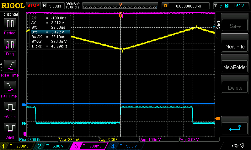

No sweat, you can still work out the inductance by using the inductor you make and measuring things with the oscilloscope.

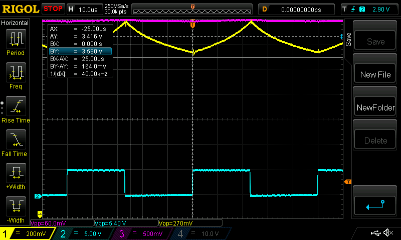

Here is inductor of an unknown value (I know it already but anyway..)
I have it in the converter board, running at 2000W output.
Input voltage 106.6V
Output voltage 48.8V
pwm width 23.1uS
current sensor trace shows a 0.280V difference from start of pwm pulse
to end of pulse. At 0.0197V/Amp this means 14.2 Amps
See the DSO capture, it shows the nice linear current increase during the period
of the pwm switch ON event.
Yellow is current sensor output, Light Blue is pwm
Now, from the fundamental inductance equation
L (inductance in Henries) = (difference in Volts) * (difference in time) / current
we have
L = ( (106.6 - 48.8) Volts * 23.1/1,000,000 Seconds ) / 14.2 Amps
Important to note that the voltage the inductor sees is the output voltage subtracted
from the input voltage. (It is a Buck Converter when it's all said and done and that is what the inductor is exposed to)
So L = 57.8 x 23.1E-6/14.2 = 94 E-6 or 94 uH
Let's see what the AUD $500 BK Precision model 879B LCR meter says..
99.36uH when measured at 10kHz
This is close enough for government work (as AvE might say)
The testing done in the converter is the best test we can do. It includes the effects
of the DC current passing through the inductor and the effect of this current is not to be ignored.
I suspect the small difference in values can be due to the about 30 Amp current DC flowing through the inductor, probably bringing down the Al value down a bit.
The LCR meter tests components with zero DC current injected into the test.
Also, I could have increased the Yellow channel gain, to give a bigger trace to measure, and so get a bit better accuracy.
I keep saying, it's real world inductance we need. Not so important what the LCR meter tells us, but for sure, the meter is a great guide for a start point.
This is why the test program I posted earlier has value. We can develop a clear image of the worth of the inductors we make for this particular application.

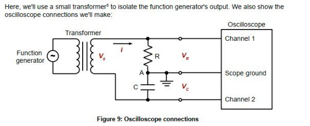

Another way to measure inductance is to determine impedance.
How to do this?
(from the BK Precision pdf on using LCR meters)
You need a 2 channel CRO or DSO and a function generator.
Then do this:
It works just as well when you test an inductor instead of a capacitor.
Any transformer will do, I used a 12V 1Amp from a wall wart when I first did this
at work. This time I used a large switching PS tranny.

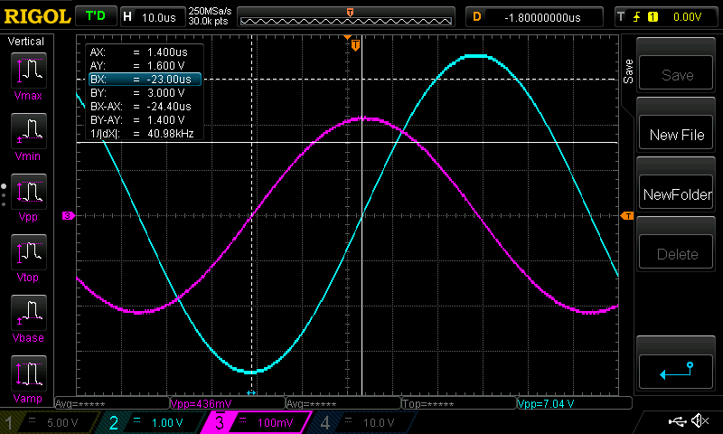

FunGen settings:
6V peak to peak output, this is not important.
10kHz sine output
And note, the purple trace, which is the voltage across the inductor
IS INVERTED.
We can see the two sine waves, the Purple sine is leading the Light Blue sine wave
in time.
Impedance is found from the good old V = IR, or R = V/I
In this test:
Resistor is 150.6 Ohms
Vr (voltage across this resistor) is 7.04V
Vi (voltage across the inductor) is 0.436V
10 kHz frequency, this means 100uSec period
leading phase angle = 24uS which means 24 / 100 * 360 = 86.4 degrees
Ir (current flowing through Resistor AND the inductor) = 7.04/150.6 = 0.0467 Amps
Z (impedance or the resistance of the inductor at this frequency) is
0.436 / 0.0467 = 9.3 Ohms @ 86.4 degrees
since Z = WL (where W = 2 x PI x frequency)
we can solve for L
L = Z / W = 9.3 / (2 x 3.142 x 10,000) = 148 uH
We didn't need the phase angle but it's useful for working out ESR and other things.
The LCR meter shows Z = 9.07 Ohms @ 87.8 degrees
and inductance as 144.34 uH
This is very much close enough for our purposes.

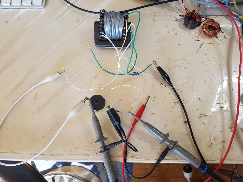

here is the high tech test setup that produced the above results

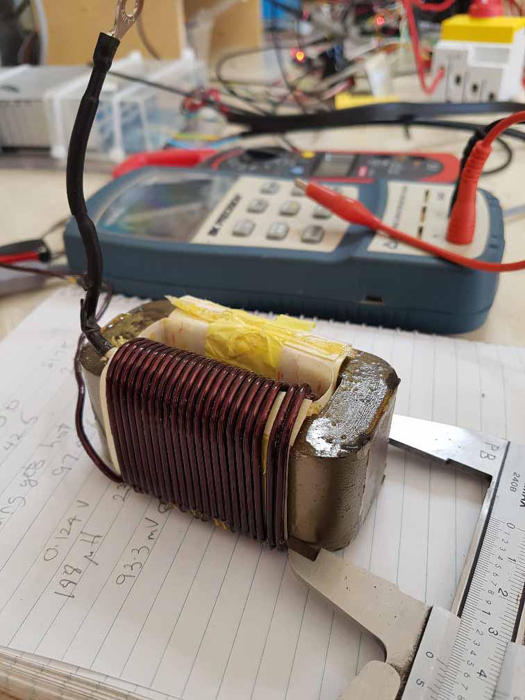

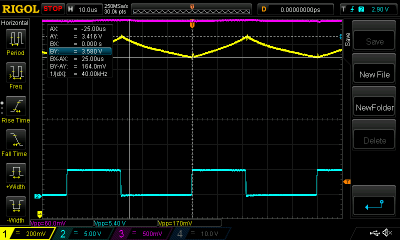

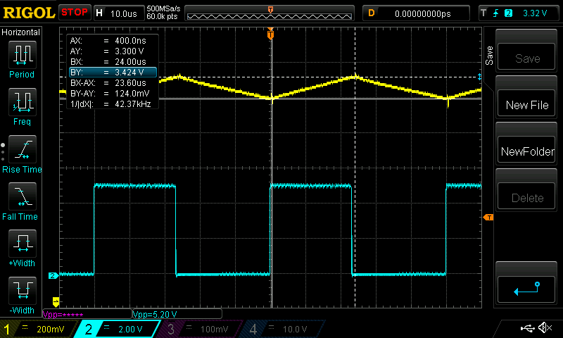

I was wondering if I could saturate the large Aerosharp Iron core.
I figured to put a lot more turns around it and test it in the standard test:
2000W
110V
1 Ohm load. approximately
20 kHz
27 turns and 258.2 uH
Surely that is too many turns.
The Amp.turns product must be too much now.
In 106.9V, 20.6A, 2202 W
Out 49.5V, 42.7A, 2113 W, 96% efficiency
Only about 6.3 Amp ripple. This is tiny for the kind of power
the board is dealing with.
And it did not saturate.
The winding for this was the 4.5mm2 pvc insulated PV roof top cable
I usually use for just about everything.
During the short test, the winding did get warm.
0.107 V at 6.15 Amps DC resistance test means
it's 0.107/6.15 Ohms or 17 milli Ohms
So there is at least 0.017 x 42.7 x 42.7 = 31 Watts lost in the winding.
Probably more when we allow for skin effect for the high frequency AC power.
This test was using the HY5110 MOSFET board. If I used the board that has
the better FDH055N15A MOSFETS I think it might be a little better again.

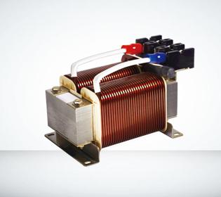

The saturation limit of steel (and powdered iron) is incredibly high compared to ferrite, but its very lossy.
Increasing the turns count does two things, it increases the ampere turns, and it also decreases the volts per turn.
So it pushes the dc flux level much higher, which steel can easily handle.
And the extra turns reduces the volts per turn, and that reduces the ac flux swing, and the ac losses.
If you look at the steel chokes typical in higher voltage grid tie inverters, there are usually two windings, each of two layers, and possibly twenty to twenty five turns per layer.
Total turns count might be in the region of eighty to one hundred turns.
These might supply a pwm inverter off a 200v to 250v dc rail at maybe ten amps.
There will only be about 2v to 3v per turn, a fairly large core cross section, and at 20Khz to 25Khz, the ac flux swing will be extremely small.
But the ampere turns will be enormous, perhaps 1,000 ampere turns on a steel choke like that.
Its a completely different design approach to using a ferrite choke which can stand a much higher ac flux swing, because the core losses of ferrite are extremely low. But too many extra turns on a ferrite core would require an impossibly large air gap to stay safely below saturation.
To get the best from powdered iron or steel in a choke application, its usual to see a far higher turns count than would be usual with a ferrite core.

I just tested the little choke, from inside the Aerosharp.
Some inverters have two of these inside.
It's marked 2.45mH and it's good for 10 Amps.
The LCR meter agreed it was 2.45mH. I took off 3/4 of the turns,
so I would expect 1/16th inductance.
2.45/16 = 153uH. The LCR says it's 188uH. Whatever, probably bumbled
the removal of turns.
Standard test:
110 V in
2000W
1 Ohm load
20kHz pwm
In 108.9V, 20.0A, 2178W
Out 49.9V, 42.5A, 2120W, 97.4% efficient.
Wow.
6.3A ripple
The winding gets rather hot fairly quickly.
23 turns or 3.6mm2 solid conductor copper, enamel coated.
The core dimensions
41mm wide x 84mm long x 35mm high
No saturation at all. Here it is at 2500W or so
Very straight line for the Yellow (inductor current) trace.
I did not believe my measurements so I repeated the 2kW test.
Again similar results.
This core would be ideal for light duty versions of the mppt controller.
For instance my East facing roof top array that never delivers more than 1200W or so
due to the timing of when the North facing array chimes into full power.
Onward and upward.

I do have another one of these small chokes. So I did what you want.
I ended up with 600uH. About 1-2 turns for each side were lost when I cut the short joining part to give me a long enough bit to pair up with the the other.
No real problem at all.
I tried it again with the standard test
110V in
20kHz
1 Ohm load ( a new one, the previous one blew last night. We could see the warning signs: increasing resistance which means thinning of the steel wire due to rust.
The last test was when it was about 1.25 Ohms and the wire was very thin and rusted when I replaced it. ...I find this fun, maybe not others here, but anyway)
600uH small iron choke ex. Aerosharp
In 107.0V, 21.1A, 2258W
Out 44.7V, 49.0A, 2190W  97% efficient
8.3A ripple
It didn't get anywhere near as hot as the previous test but it still was getting warm.
There are clear signs we are near or within saturation even at 2kW
Yellow is inductor current, 0.2V/div and 0.0197V/Amp
and here it is with 2.3kW, clearly showing signs of saturation.
This is about 50 Amps.
Again I call this a good candidate for the project.
This test used the board with the 150V MOSFETS and so we get a little bit more
efficiency and a bit less heat.
I suspect the 100V HY5110 MOSFETS are exposed to voltages well in excess of the tested (by me) avalanche voltage of about 108V, and when they get these high voltages they just short it.
The efficiency values I have provided here are guides to confirm we are on the right track. Every test so far has better than 92%. The tests are meant to show the inductor's behaviour under typical high power levels. We can then give them a pass or fail depending if they saturate too badly. Also the tests show the importance of using a reasonably high inductance value, to give the output filter caps a good chance of working for more than a year by keeping ripple current down to OK levels.

Fifty amps is really a bit much for it, thirty amps would probably be about the limit.
Its clearly well into the onset of saturation, with rapidly diminishing inductance, and its going to get really hot. Still, its been an interesting comparative experiment.
Two pairs of those "U" cores stacked, with about half the existing turns and thicker copper would get you back to 600uH and should be capable of perhaps sixty amps if you keep the same air gap.  Its going to be pretty big, but then 2.5Kw continuous is serious power.
