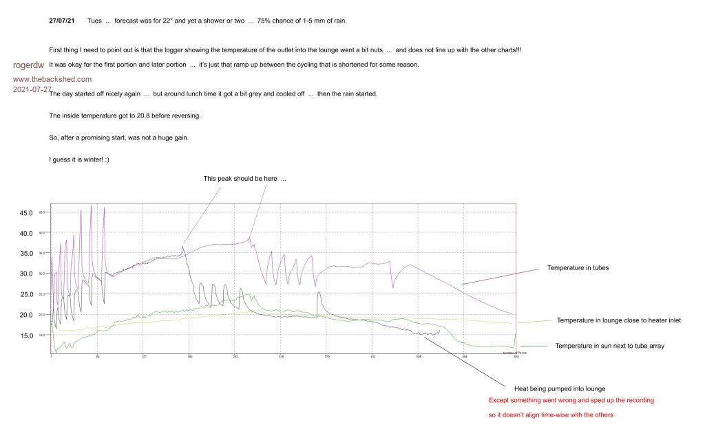

Today started off well  ... but a change with rain came in about lunch time.
On top of that, one of my loggers glitched for some reason and must have changed its recording times somehow. If you look carefully you can see where it should line up  ...  so it's still worth posting to see what poor conditions do to the results.

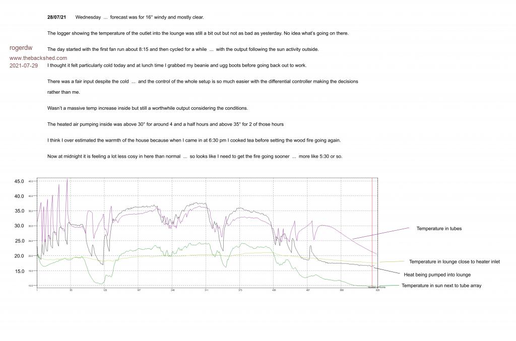

We did get quite late into the season that would normally be cold with brilliant sunny days.  I am sure your tubes would be Punching out the heat then.
The current weather makes your setup a little  iffy but then every year is different and next year may be much sunnier even if cold days.
We seem to come out of winter here, have beautiful September weather and then the first week or 2 of October is Chit just when you put the cotton sheets on the bed and  did away with the warm clothes.  Usually rains for a fortnight or best part thereof as well.
This last week since I got the Diesel going again I am running it much lower and the house is staying at 20. I was blowing through a tank of fuel every few days before, now it's just sipping it.  We had one day with a low of -2 then 5 days later the low was 12! It makes a HUGE difference to the heat input required.

When I first started I reckon we had a few days when it was pretty lousy  ...  but then it picked up and had been fantastic most of the time  ...  just the odd day that was poor  ...  but we've had a lot more of them recently.
  Quote  We did get quite late into the season that would normally be cold with brilliant sunny days.  I am sure your tubes would be Punching out the heat then.
I don't know if this is a normal winter or not really  ...  feels like it hadn't been all that cold or wet  ...  but we've certainly had plenty of rain and now cold  ...  so maybe it'll get real wintery for the next couple months  ...  and make my machine ineffective!

  Quote  That being the case, for summer I'd look at adding an electric hot water heater. If you have the solar available, it would be cheaper to use that than the gas.
Addressing that is certainly in my plans  ...  some sort of pre-heater at least
...  though I need to finish this and get on with the warpinverter and panels next.

  Warpspeed said
  Davo99 said
And Might be Cold and sunny and your setup will work a treat!!
The coldest frosty mornings usually go with a clear bright starry night, along with a cloudless sunrise. Perfect scenario for the "Roger Tubes".
Haha, yeah  ...  I didn't think it was all that cold this morning when I got up  ...  but it's certainly come in cold now. Came in for lunch and put on my ugg boots and beanie.
It's cold, blustery and has been raining  ...  but the whole time I've been in here I can hear the fan running.  I don't know how it's getting any heat out of anything but it's pumping 34 degrees at the moment so I'm rapt.
I'm also changing my thinking for when the big one goes up.
Before I had just planned to have an outlet in the lounge and one in the games room which is always cold  ...  but now I'm thinking I need the main one here in the kitchen/living area  ...  even though that's where the wood heater is.
That way, with the wood heater off, it is still the first area that gets warmed, because that is where we all mostly spend our time inside.
Once it's warm enough in here  ...  we can switch in the inlets to those other rooms to spread the warmth further  ...  which I have no doubt we'll be able to do fairly often. A couple of those damper valves should handle that ok, along with some smarts of some kind.

Posted: 07:37am
28 Jul 2021
Davo99
  rogerdw said
In fact I had figured that it would be cool to set up a raspberry pi or something to monitor the output when it has one  ...  and actually record the kWhrs it produces. Shouldn't be that hard if I only have one or two fan speeds  ...  log the temp in and out  ...  and the length of time it's on. Pipe dream of course, but nice to think about.
Maybe I just don't know enough to know what I don't know.... But seems to me it should not be that hard apart from programming the PI itself.
You have 2 of the 3 parameters, air flow speed and diameter of the Pipe so qty of air. Even if you didn't have that, Mass air flow sensor like in a car wouldn't be hard to work with, seen that done many times on DIY projects.
All you need is a sensor for the temp and surely there should be a calculation you could plug into the Pi to give both an instant and cumulative output in KW.
And that's why I also have to fit a dc motor to run off pv panels  ...  so the uneducated can't point to the little 50 or 100 watt fan and say "but it runs off electricity  ...  that's where all the heat comes from"
Although we think so much alike on so many things, we also think very differently.
Now if this was my work of art and engineering Genius and someone told me all the heat was coming from a 100W Motor, the LAST thing I'd be doing would be trying to change their minds!
I'd be saying "ya know, you are dead right, you figured it out.
I'm making 4Kw of heat from only 100W of electrical input.  I was going to market this myself but my wife wants me to spend more time with my family ( guess where I stole that line from? )  so I have decided just to sell the rights to this.
If you are interested, I'll sell you the  machine and give you full rights to the technology to manufacture them yourself and keep 100% of the profits. Can you imagine how much money you'll make?"
That the side benifit of years of marketing, sales and advertising experience Roger. If there is a potential quid in it, don't argue with people,  go along with what ever they say...... You'll never change the mind of the terminally stupid so don't try.
If ever some do gooder accused you of Ripping people off, I call it the cost of Education. We all know anything fast and time saving costs a lot and this would be a real fast education that could save them many years and many dollars they might have otherwise wasted had you not been kind enough to help them. I certainly give them all the help I could relieve them of their money and make them smarter. Just the kind, generous, giving sort of guy I am!  :0)

Posted: 12:29pm
28 Jul 2021
rogerdw
Sounds easy when you say it like that but I expect I should be able to cobble something together  ...  or find someone who can help me.
  Quote  Although we think so much alike on so many things, we also think very differently.
Haha, I hadn't thought of that. Maybe I can learn a thing or two.

  Quote  If you are going to bring the duct through the roof, you could either set it up with it's own diffuser like used for AC or look at dumping it in the AC return air plenum.
I had considered that  ...  but was concerned that with all the other ducts it might create issues. I don't know enough about ducts and airflow etc. I do have a friend who is an AC tech, so I might invite him around to show him and ask my questions then.
I am leaning towards a 3 way outlet just under the tiles, that will feed the seperate areas  ...  each with a damper valve so I can direct air or shut off completely to stop draughts like you suggested.
For the inlet, I still like the idea of a preheater  ...  perhaps a more conventional air heater mounted on the wall outside  ...  with its outlet feeding into the big one on the roof  ...  and it's inlet fed from outside air.
I keep coming back to that because like today for example  ...  as cold and unpleasant as it was outside, the laundry was beautiful and warm  ...  just a small room facing the sun with glass for the door and wall.

Posted: 09:40pm
28 Jul 2021
the temperature rise is considerable, and will be about three times as high with the big system.
I think were gonna need a bigger blower
