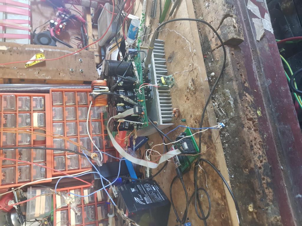

noneyabussiness
pics of test bed...
again, thx in advance

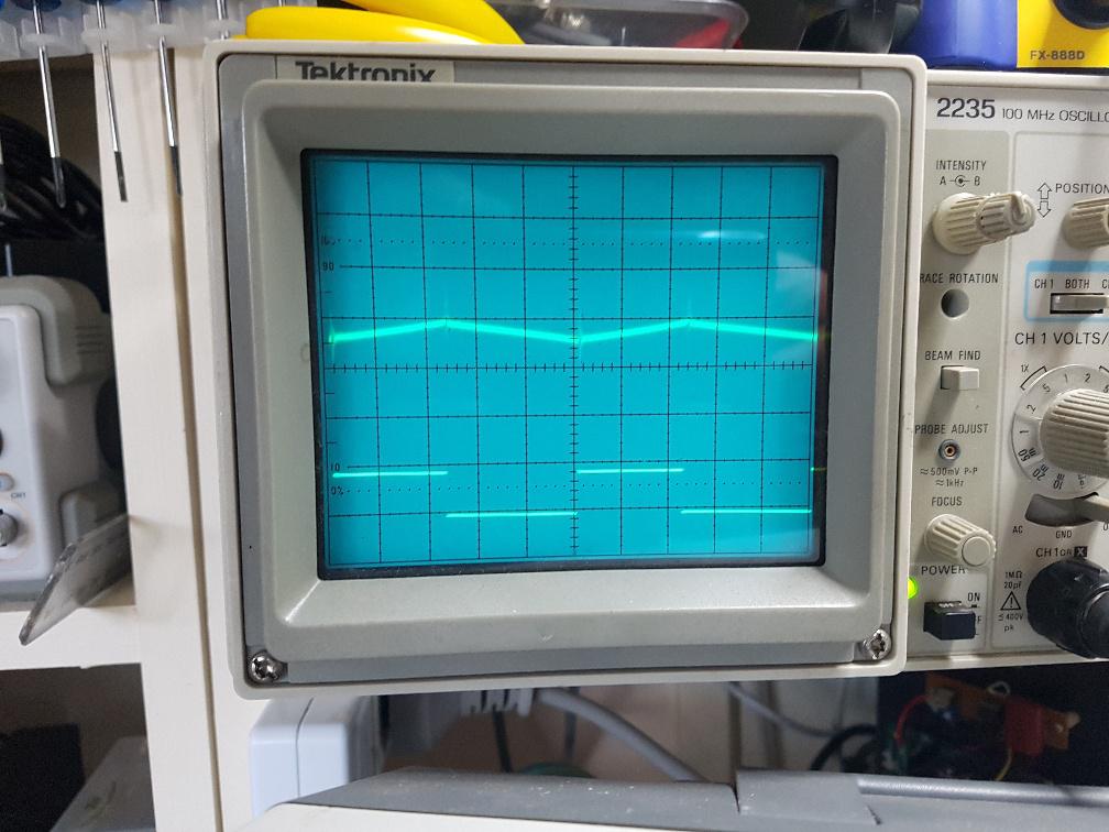

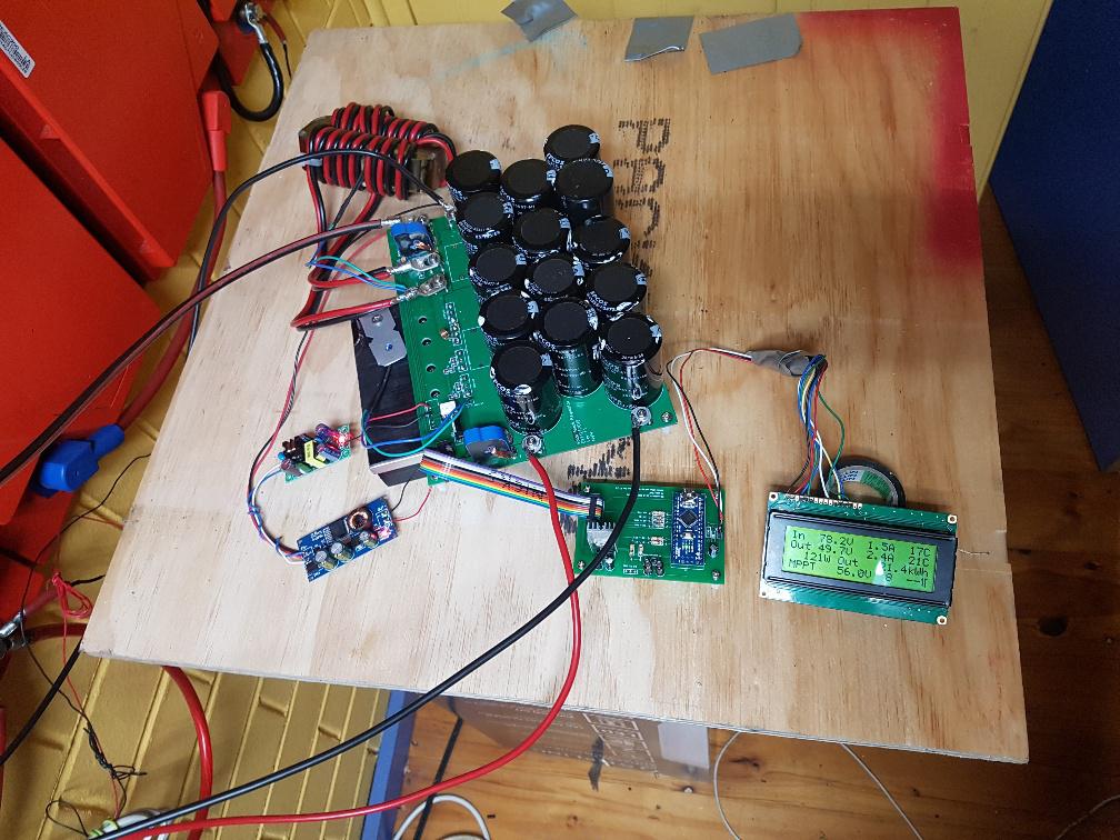

Under the heading of "pics or it didn't happen"
here is the low power mppt controller that is hooked up to the East facing array on the roof. It has run without any issue for a week (I fixed what I think is the last bug in the firmware last weekend)
Today we had low cloud and near continuous drizzle.
This must be Melbourne! Yes indeed.
You can see 2 supplies. One is a a non-isolated dc-dc converter, this provides the 12V.
The other is a floating output supply which is used for the gate drive of the MOSFETs
And for those who say "yeah but I don't have one of them fancy digital oscilloscope thingies so how will I see anything?"
My standard test of 20kHz, 110V, 2kW
Here it is using the Tek 2235
Let's build a few and see what they do.

  poida said  Under the heading of "pics or it didn't happen"
Poida, just out of curiosity, on your picture the little display shows "17C & 21C" as the last item in the first two lines.
what does that indicate?
thanks.
Posted: 10:58pm
07 Jul 2020
poida
Those two numbers are the temperatures of the heat sink and the inductor
The when under any sort of load the inductor will be hotter.

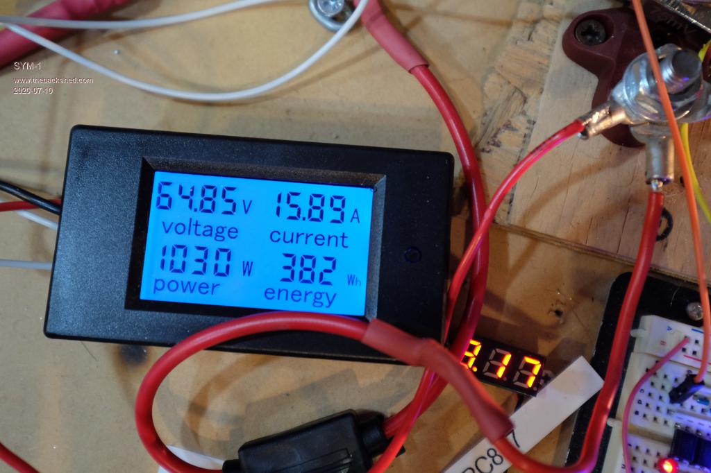

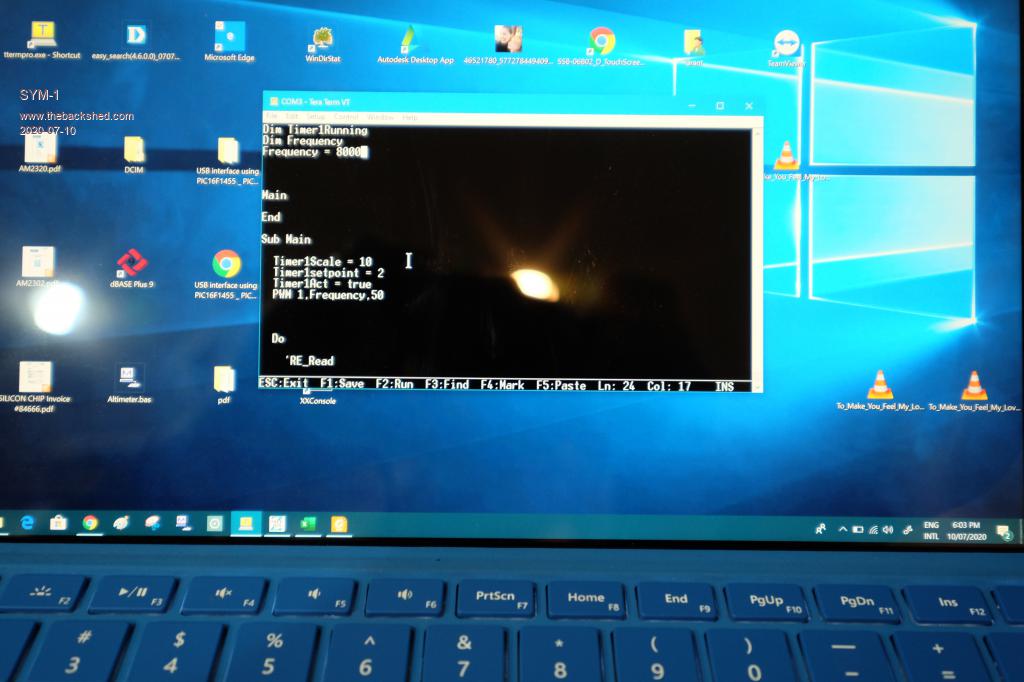

SYM-1

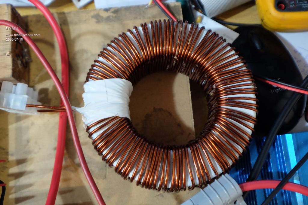

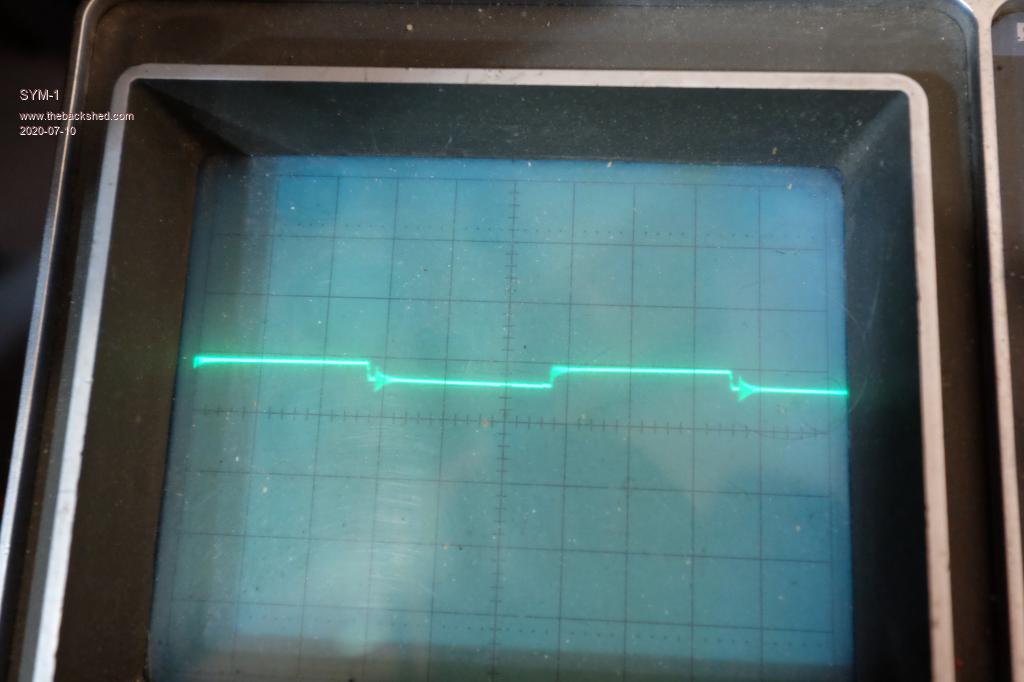

I haven't populated the boards yet and I only have 100 turns of 2.3mm dia on the -2 inductor.  I am intending to increase this to 4 sets of parallel sets of 100 turns yet to get the resistance down.
Losses are still quite high.

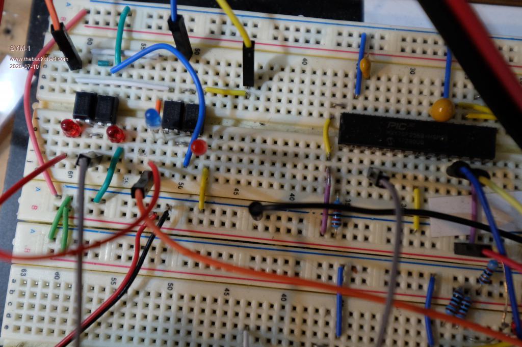

Some of this is due to my slow gate switches using 2 sets of PC817 in a DCOI arrangement.  I used 2 sets because if you one set you get inversion and the micromite I am using to produce the PWM signal defaults to ON if the program stops so I get full voltage across the output.  I have been through a few fuses and $3 FET's.
I am using a IRFB4115 FET for testing.  The diode I am now using is a VS-UFB280FA20 from RS.  It is 45ns and 1.1V drop at 120A.  Two diodes in the package.
So losses probably high due to 3 things
-DCOI
-losses in windings
The DCOI is quite slow on the rise time but the upshot of this is I have no switching noise.
I plan to try out the FET's everyone else is using plus one or two other FET's I have once I am happy the circuit is stable.
I blew up my first pair of diodes - they were 10A diodes (2 of them) but they blew up at about 11A.  The diode I am using now is rated at 175A and 200V.

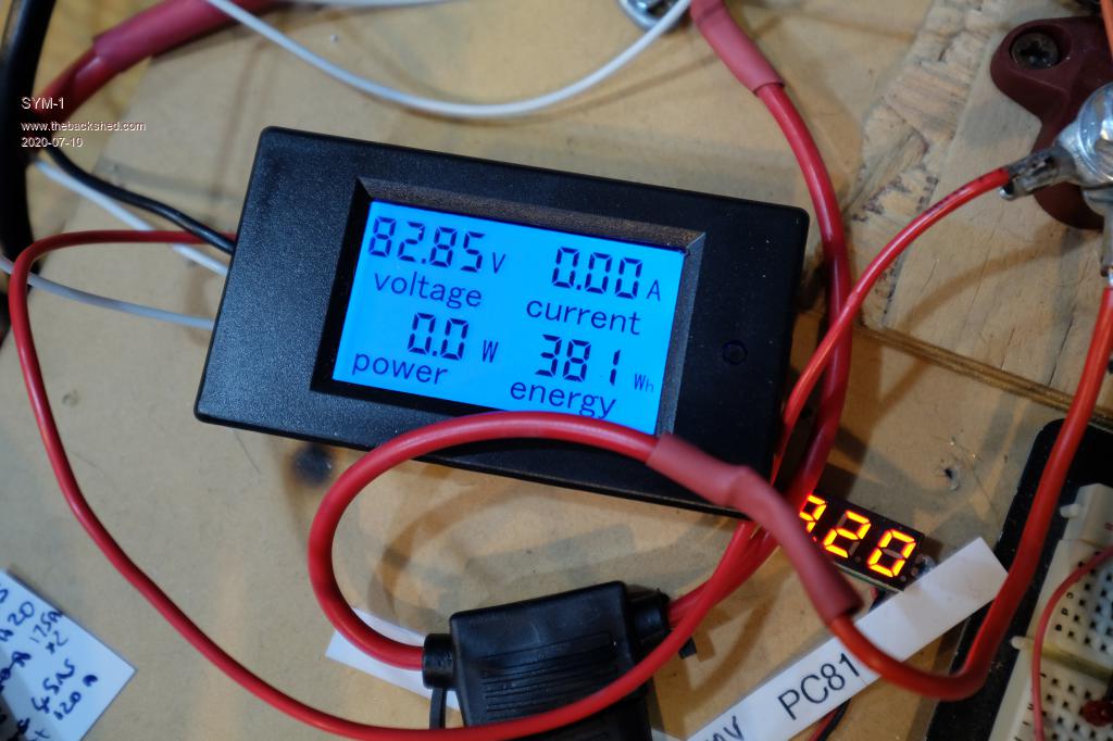

Here are some pictures of progress so far.
Voltage In
Voltage in drops a bit because I have a 1 Ohm resistor to stop inrush at the moment.  Here is a picture of the input pulling 1kw from my batteries.

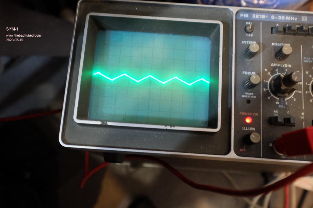

Here is the output

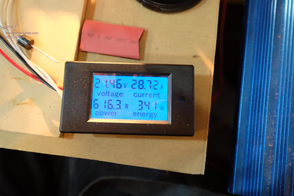

Here is the trace of the output voltage across 0.75 Ohms.  I am getting about 5V swing - 6.6A

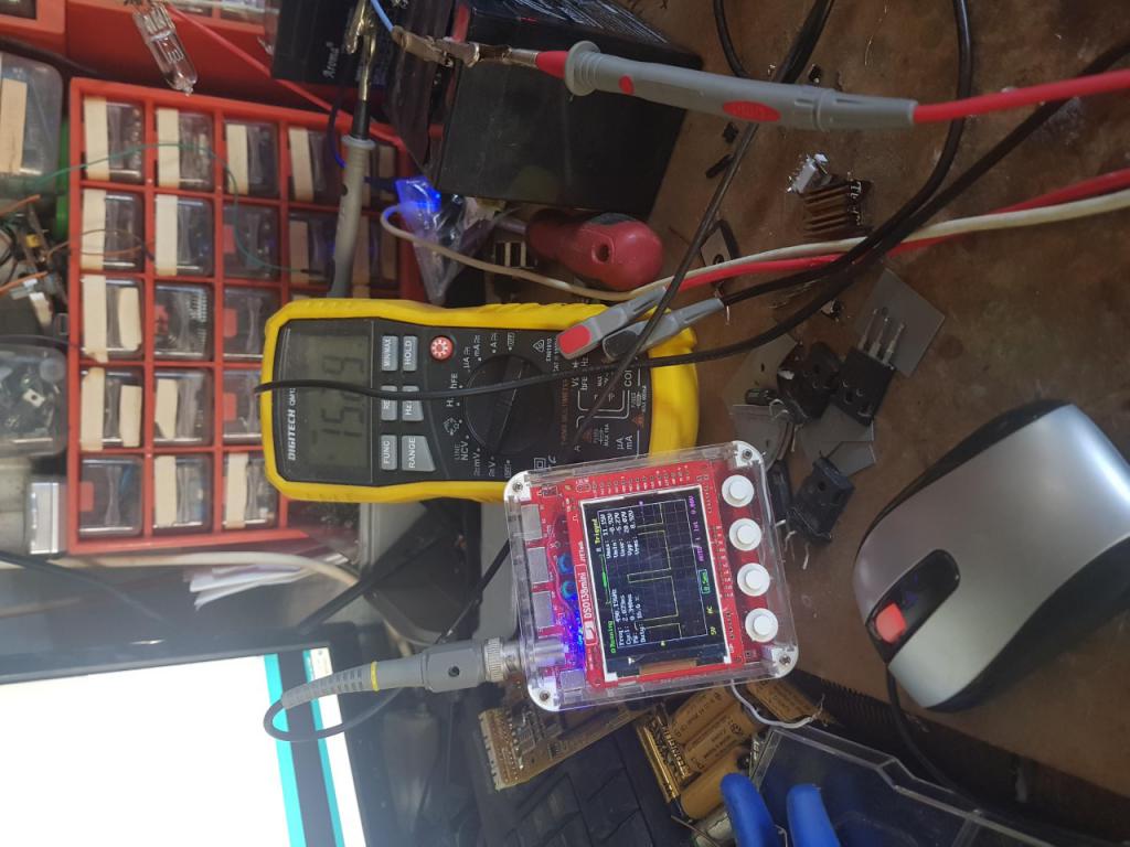

I am running at about 8kHz.   At 20kHz I don't get as much transmitted energy.  Maybe when I speed up my gate drive I will be able to increase the frequency.  I get a bit better efficiency at higher frequencies.

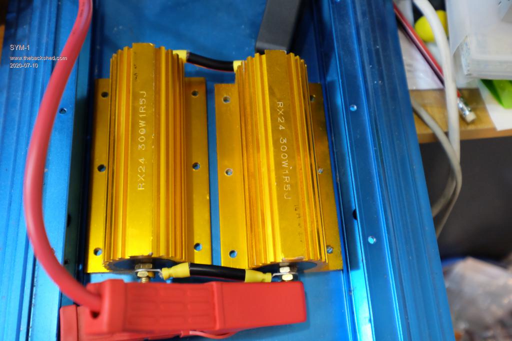

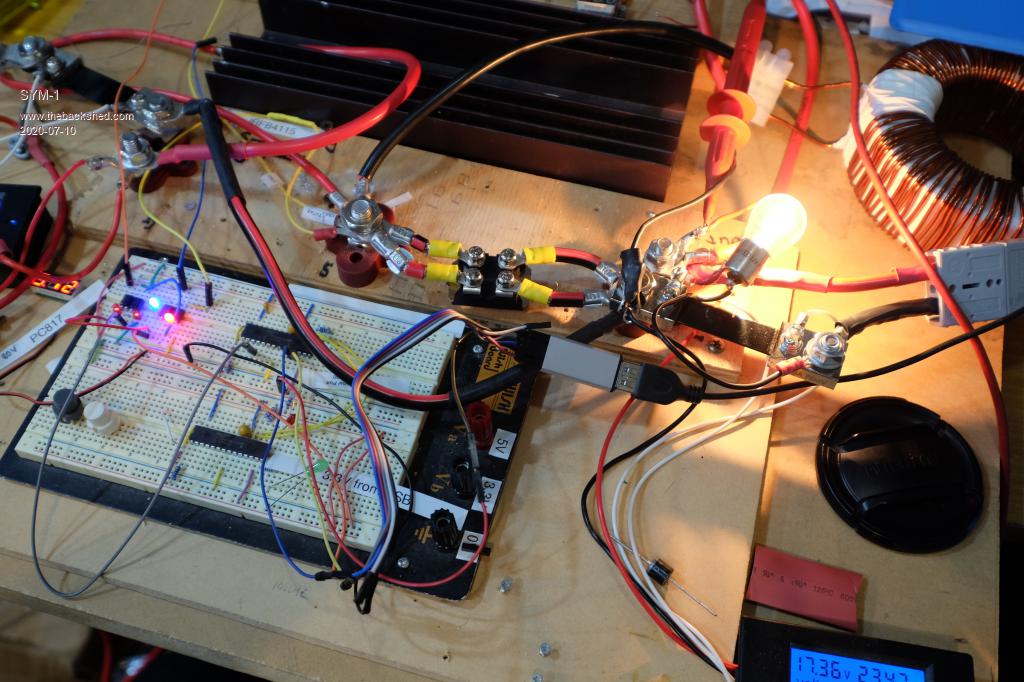

Here is a picture of the test bench.  The FET is on the big heatsink.  It does not get off cold.  The lamp is a 24V lamp which is my highest target voltage at this stage and gives me a good idea how the circuit is running.
The micromite monitor
The load
The DCOI driver using PC817's
The 5.2 inch -2 inductor with 2.3mm dia windings

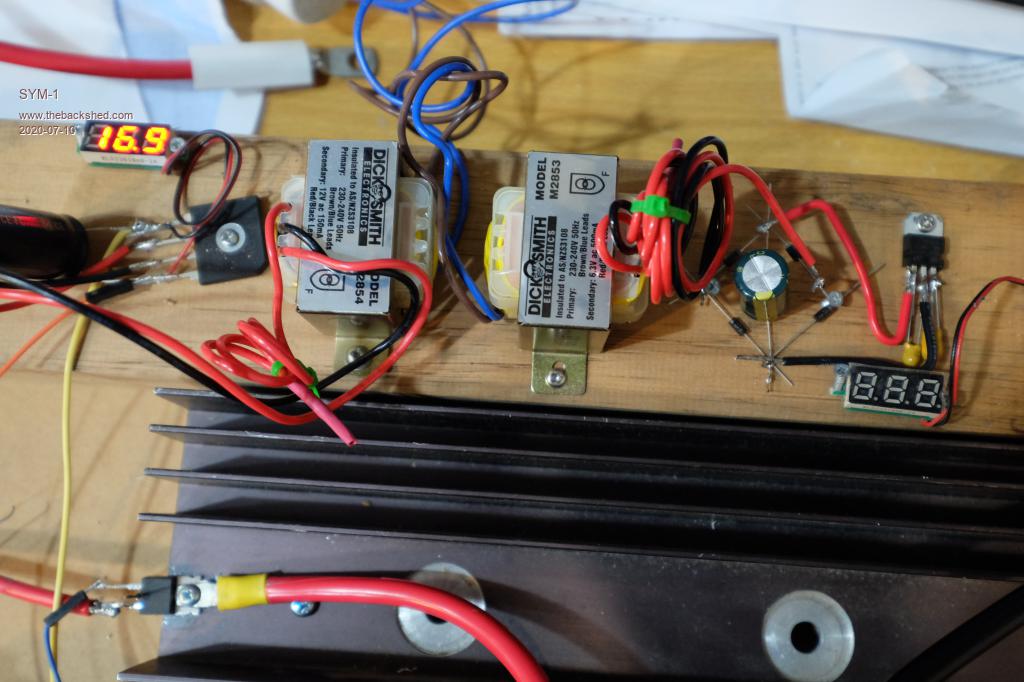

Here is the gate power supply.  I think there is some advantage to limiting this 16.9V to 12V to speed up the gate.  I will try that in the future.
Posted: 07:00am
10 Jul 2020
SYM-1
Here is the swing once the batteries are hooked up - 9A or 18A makes no difference to the voltage trace.
When I hooked up a 33000uF 40V capacitor to the output the oscilloscope output was just flat.
Edited 2020-07-10 17:10 by SYM-1

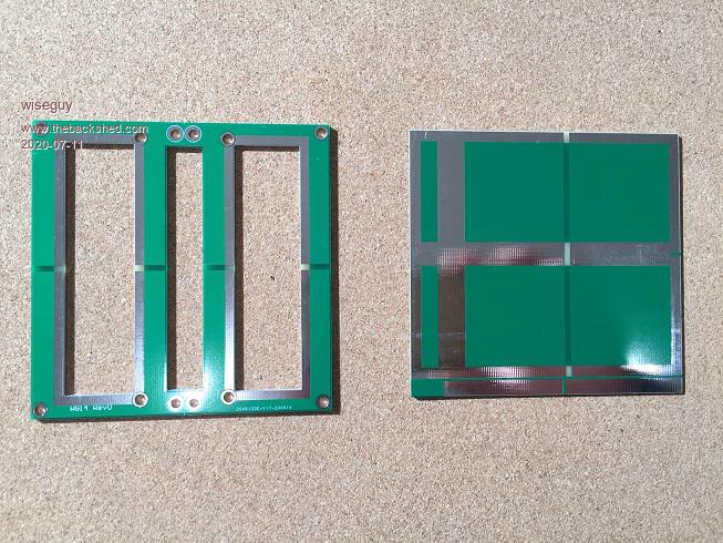

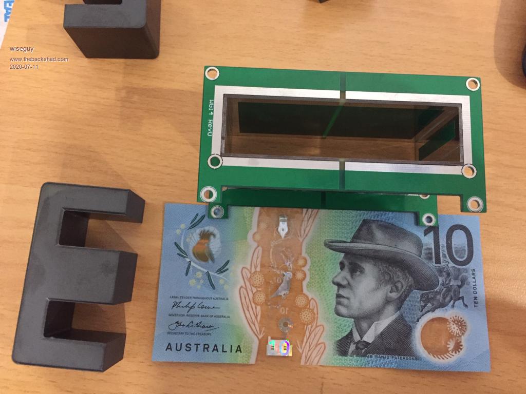

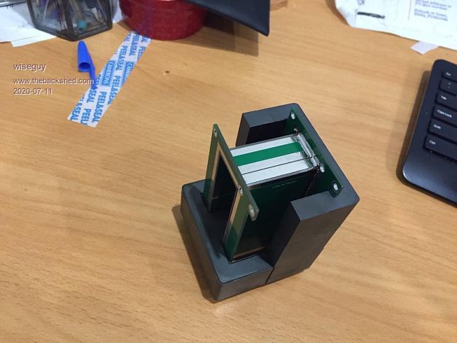

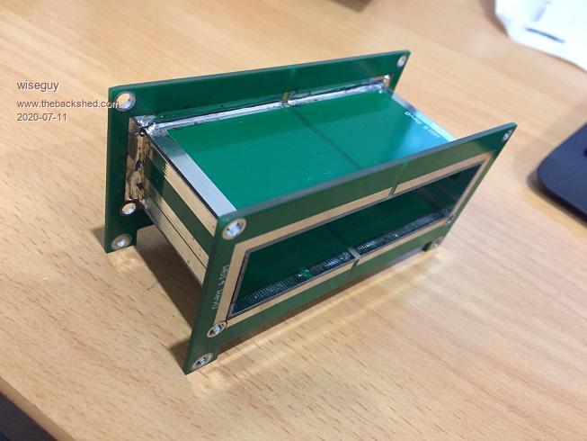

Ok finally found a few minutes to post some pictures of the bobbin I created for the triple stacked EE65 cores.
The PCB design as it arrived.
Cut up and assembled (soldered along joints).
Against a bank note for size reference.
And with 3 x 1/2 cores on 1 side and 1 x 1/2 core other side for a cut away view.
Funny email from PCB maker - Sir we think you have forgotten the drill file - er no there is no drill file. But Sir I dont think we ever made a pcb with no holes. Ok well theres a first time for everything I guess. Please make it as is - there are no holes.
The material used is 1mm for the inner bobbin webbing, the two side pieces are 1.6mm thickness.  Cost for each prototype order (10 pieces each) 2 x $7. I ordered it with another job so freight was free. Each bobbin cost to me $1.40 in pcb material. The finished assembly is seriously rigid/strong, I reckon I could stand on it without breaking it. I will need to file the sharp edges at the 90 degree bends though as they would cut into the wire.
The astute will notice a gap in the copper along the centre of the bobbin - this was to avoid a shorted turn.
Hopefully I can get some turns on it and have a play with the saturation tester soon. My FETs should arrive next week so I can finally build up a whole unit. If it works as expected and anyone wants one, they can be flat packed ikea style and posted in an envelope for ~ $1.10 no alan key required !
Edited 2020-07-11 19:14 by wiseguy
