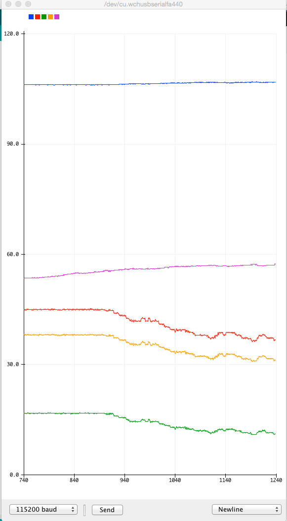

Here is how the heat sink temperature controls the output current
as 55C is exceeded.
This test was at 1720W output.
Purple is temperature.
Red is Vout
Yellow Iout
Green Iin
Blue Vin
The setting is 55C to start output current reduction, with a maximum temp of 65C
So each degree above 55 will take 10% of maximum output current.
It works well I think. It flattened the rate of rise of the Purple curve which is
temperature of course.
