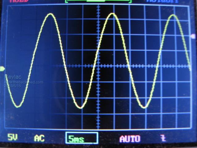

Had a little time this afternoon, So its about time to power this inverter up without caps and see if it works.
Looks like a good wave and a decent length soft start.

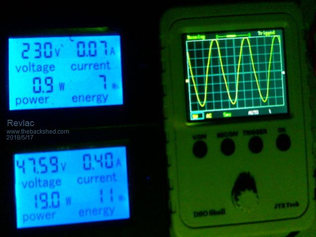

Posted: 12:01pm
17 May 2018
Revlac
Thanks oztules
For the post on the long ON/OFF switch leads.
These long leads I was using where causing some horrible erratic crackling noises in the choke and the EI tranny.
Fixed now ( bypass the 1k to ground), and putting decoupling caps ( 104 and a 10uf ceramics). This kills the interference that can get into the switch lines if they are long....
Just had to duck outside and do this mod.
Photo quality is a bit.sad
Now working much better.
Also changed the 3K9 to 4K7 for VFB, for some reason 3K9 or 7K5 did not get within the range I wanted, will investigate why a little later.
Cheers Aaron

oztules
Your welcome Aaron, Marks problems were able to help someone else... good thing.
Amazing how you learn nothing if nothing goes wrong. I have never had a problem since I ran with the above board configuration. I did not know I had beaten a problem I didn't know existed....
Although I did find out about the sensitivity, but I assumed it was with the resistor configuration I was trying for single pole switching. Did not try spdt switching at that time..... and when I did, it was above board. I do use quite long lead for the switching now, and I use high power... something is going my way apparently.
Your wave looks good enough for prime time.

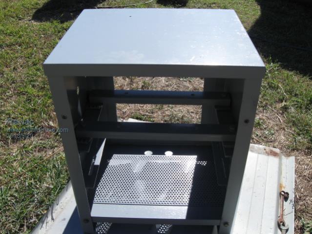

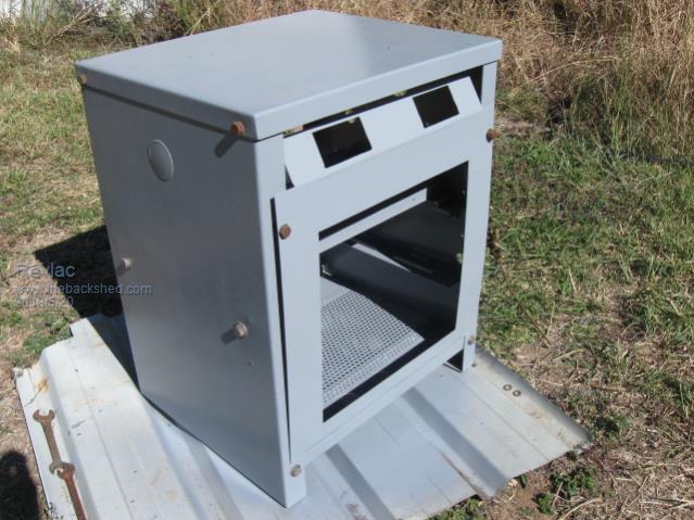

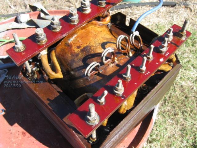

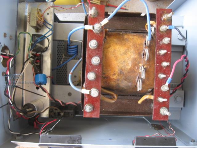

Started working on a box to put all the inverter parts in, cleaned up the rust cut some holes for the gauges to sit in, Must remember to plug up all holes to stop any of the critters getting in.
The transformer also scrubbed up nicely and should fit in the box with rubber mounts and enough room for anything els.
At the same time I am also working on a larger one as parts turn up.

Progress has been slow, many other jobs getting in the way.

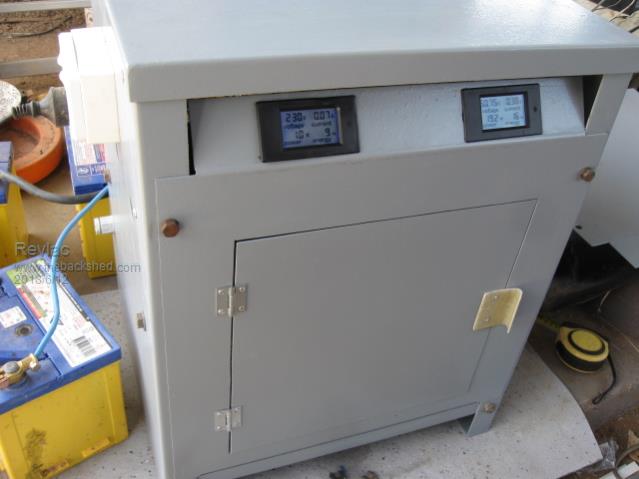

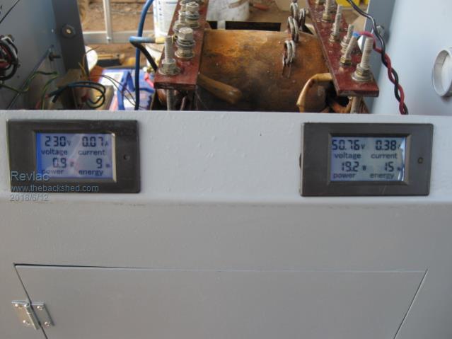

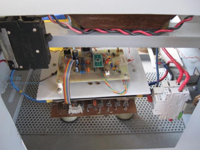

Bit of a test today and it is up and running, it still needs more work and the wiring could do with a tidy up, but happy with it so far.
The AC current meter is reading power consumption when there isn't any, perhaps the current transformer is too close to to something els?
Checked the primary voltage, about 27vac and 230V on the secondary seems good enough to me, there is also a 12vac tap on the secondary which I might try later to see if that will replace the feedback transformer, and I don't think there would be any need to filter the output as it is part of the existing winding.
The little choke that is hanging in there is not the quite correct will fix that later.
The ON/OFF switch was going to sit between the two power meters but then I decided to shorten the leads and place it inside were the rest of the switchers/circuit breakers are.
I still have to add the rest of the fets and the caps then give if a thrashing.
The case is the old SOLA computer regulator, Had that big ferroresonant transformer in it, turned into a pretty good inverter case I think.

Looks really high-quality industrial in that case, how heavy is that transformer and what is the idle current with it?
