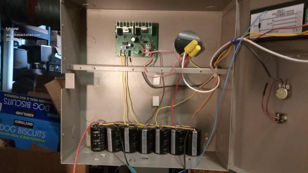

The one you have made and not tested Tony can you put up
some clear pictures of it if possible
thanks iispip

Ill start a new thread on this . Just wondered if you have seen the Youtube videos of a guy called "Opera"?
Hes heating hot water direct from solar panels he claims but I have tried following what he's doing and he has made it very confusing. Changing inverter boards and supercaps, out of focus and poor lighting etc.
Ive got one going to the point of getting a voltage out of the board but its damn hard to work out where to connect the ins and outs . So anyway I'll start another thread and hope you guys will jump in there too . Thanks.

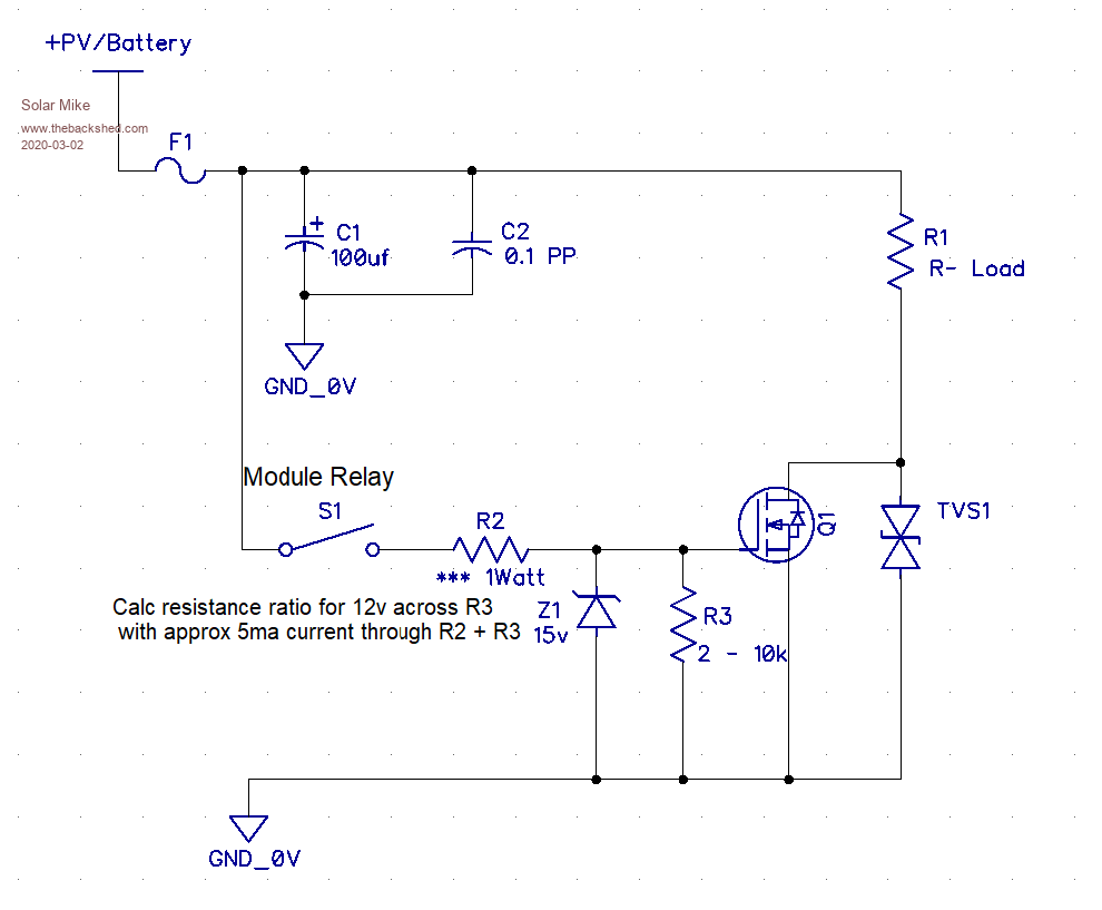

I have been working on something similar for many months and finally cracked it.
Rather than using inverter boards, I have used a a Battery charger board and a voltage level switch.
They are both 12V but I will use them to regulate an array of panels that will go to about 260V and run on a normal 240V element.
I'm using a voltage Divider to get the voltage from the panels down to something the board can handle and measure. The panels will charge a bank of caps to their open circuit voltage and then once they reach that, the board reads the voltage and triggers an SSR.
The Caps Discharge into the element and the board resets and repeats the process.
The boards have mechanical relays which are bypassed and the output taken straight to the SSR which require less power than the mechanical relays. The voltage switch boards have an upper and lower limit. I don't think the lower limit will be needed as it will climb fast just on the caps and I don't know if the board could cut fast enough anyway.
As warp worked out, 10% off power point does not make a lot of difference to the panels and as the load from the caps is minimal during charging, they seem to come up very fast and the cycling is also.
In testing with a 100W Bulb as a load and just one cap and panel late in the afternoon, I could not get any illumination from the bulb at all, not even the faintest glow. Even with the mechanical relay doing the switching (which is very slow in comparison to a solid state device which could also just be a mosfet or series thereof,) The bulb lit quite well. A very graphic illustration of the benefits of having the panels in their happy place.
Before this I experimented with just a PWM controller. This was also enlightening ( pardon the pun) as even with this, it was evident much more power could be gained over the course of a day throttling the load at a fixed rate than just having the panels directly connected which was hopeless.
The vids opera made no sense to me but reading here I got the idea of what needed to be done and worked out what I could use to achieve it.  I imagine the efficiency is still Horrible compared to what the smart people here have built but I'm happy I was able to work this out and it's a LOT better than nothing at all that's for sure.
From here I just need to work out what are the most common and easy to get boards as well as the cheapest that will do the job so I can do some step by step how to Videos and standardise the procedure for others to follow.
One thing I may need to do is work out how to measure the highly pulsed output to compare it to direct coupled.

Great work there Dave.
One fairly simple way you could make some comparative power measurements might be to average out the pulsing voltage across the heating element.
That could be done by charging a large electrolytic through a high value resistor.
The electrolytic will try to settle at some average of the on/off voltage that can then be measured directly with a multimeter.
It may still be pulsing a bit, but some kind of average heating element voltage can probably be "eyeballed" if the pulsing is not too violent.
Power will be proportional to voltage squared, so a little bit more measured voltage will indicate a correspondingly larger increase in actual heating power.
Its a bit Mickey Mouse, but it may usefully provide some kind of relative power indication for initially setting up the voltage thresholds and trying out a few different variations.
I think you will find that its all not in the least bit critical.
If the voltage switching thresholds are moved closer together, that will make it cycle much faster, but the averaged out voltage across the load, and hence the average heating power into the load will not change by very much.
Averaged and steady dc measurements will be quite comparable as far as actual power comparisons go.
Cycling rate is not going to have any effect on total power transfer of efficiency, so you can build it to cycle as fast or as slowly as you wish, and the final heating results will be the same.
The whole thing will always self adjust to match any combination of panels and available solar, to any heating element, so long as the two voltage switching thresholds are suitably set.
The way you have cleverly done it by combining simple readily available parts will be just as efficient and effective as some high tech software system on a fancy circuit board doing exactly the same thing.
Its a very simple idea that once understood, can be put into practice fairly easily in a variety of ways.

  Davo99 said   I was thinking of something like charging a cap through a diode and  having a drain on the other side like a bulb to measure Current as an indication. Doesen't have to be relevant to anything other than indicating when there is more or less power. Resistor is the same thing and would waste less power.
A diode will charge the cap very quickly up to the peak voltage, which is not what we are trying to measure.
A resistor will charge the cap when the heating element voltage is on, and discharge when the heating element is off. The resulting voltage on the cap will give a time averaging effect which is what we want for measuring the average power.
  Quote  If the voltage switching thresholds are moved closer together, that will make it cycle much faster, but the averaged out voltage across the load, and hence the average heating power into the load will not change by very much.
You read my Mind with this Tony. I was wondering about that very thing in reference to the size off the cap bank. Obviously the larger the longer the time to charge but I get the feeling that is going to be fractions of a second for the most part in any useful lightning rather than seconds.
The only thing I was concerned about was the ability of the SSR to cycle fast enough But I think that won't be a problem from what I have looked up.
Try and dig up a specification for turn on time, and turn off time for the solid state relay. Some can be fairly slow. But a cycling on and off at a hundred times a second might be o/k, but check. There is no real advantage with adding capacitors and slowing it right down. So its a bit of a compromise. Fast is good as long as your switch can handle the speed.  If its getting unexpectedly hot, try slowing the whole thing down a bit by spreading the voltage trip points or adding more capacitors.
On that, I seem to recall reading where I think it was you that suggested on someones real circuit to put in a Diode? to protect the Mosfet? from the back Current ( emf?) when the relay was tripped?  Could you advise if you think I should Put some Diodes ( have some 10A's Or 30A Bridges in the box) for that or is it only relative to something else?
A diode will be necessary across the heating element, and some kind of transient suppression across the switching device, a commercial solid state relay should already have that inside.
Even testing with one panel at around 34V, I'm impressed with the crack they give when charged and shorted with a screwdriver. :0) Would indicate some substantial amps.
It should normally discharge through the heating element, and the current will be limited by that. But you are right, stored energy can do mighty things !
  Quote  Cycling rate is not going to have any effect on total power transfer of efficiency, so you can build it to cycle as fast or as slowly as you wish, and the final heating results will be the same.
is there any advantage or disadvantage to either way? Heat in SSR's?
Very slow (several seconds per cycle) might have some definite advantages for a motor load, but for heating it does not really matter. A solid state relay will be relatively slow because the gate of the internal mosfet is only powered by a few miserable photons. One or more decent mosfets on a heatsink driven directly will be much faster. Thousands  of cycles per second would be practical and easy.
  Quote  The whole thing will always self adjust to match any combination of panels and available solar, to any heating element, so long as the two voltage switching thresholds are suitably set.
That was I thought. This should adapt to any amount of panels as long as the series Voltage was taken into account and duly set.
Is having the voltage closest to the elements voltage going to be better than say the same amount of  panels in half the series and paralleled?  I'm thinking the closer the voltage the better even if the power is the same although paralleling may lead to faster cycling but I'm thinking that's going to be pretty fast in the main anyway.
Might be safer for people to run 2 arrays at say 130V than one at 260V is all I'm thinking.
Yes its better to match the voltage at flat out full summer power. Ideally at a higher overall voltage. Less current means lower switching losses and less heat to get rid of in the heatsink. But you can stretch that concept out a fair bit and still get excellent results.
Now take a completely silly extreme example'' Suppose we have eight 250 watt 30v panels, giving us about 2Kw at 240v dc.  And we have a 24v 2Kw heating element (24v 83 amps).
Our capacitor charges up, and the solid state relay cops 830 amps of discharge.
Quite possible, and it would work in theory, but its a pretty hard hit for both a solid state rely and the capacitor.
But a 2Kw 240v heating element might discharge at only 8.3 amps under identical conditions, and whatever switches the power is going to have a much easier life.
A 120v element might average out at 33.2 amps discharge, still perfectly practical.
But a 24v element with 240 v of panels would be totally over the top. So its better to get something fairly close, but the match does not have to be exact.

One or more decent mosfets on a heat sink driven directly will be much faster. Thousands  of cycles per second would be practical and easy.
Could you suggest a suitable Mosfet and how many you would use for a 3.6 Kw Element?
I was thinking that would be the next way to go and originally thinking I could just direct mount a mosfet directly on the board I choose in place of the mechanical relay for lower power applications and sink it/ them for higher power.
Logical heat sink would be the side of the water heater Tank.  :0)
Posted: 10:21pm
26 Feb 2020
There are probably two fairly obvious contenders for mosfets.
FDA50N50 which is 500v 48 amps and rdson 95 milliohms these are available from e-bay for about $15.  I have used a lot of these, and are what I currently run in my Warpverter for the two smaller inverters.
TK62J60W this is a much more recent device 600v 62 amps and rdson 33 milliohms available from e-bay for around $25.
Either would do. I think I would prefer the cheaper device to experiment with initially, and probably the larger one for the final project once any bugs have been sorted out.
Its important to connect a transient voltage suppressor right across the mosfet source to drain. A 1.5KE350 (350v) or 1.5KE400 (400v)would be ideal.
How much heatsink ?
A 3.6Kw element might be carrying roughly 15 amps, and 95 milliohms would be 21 watts for one of the smaller mosfet. The absolute minimum for that might be about a five inch by five inch vertical flat 3mm aluminium plate, and something larger would be advisable.
A pair of the smaller mosfets would halve that power and spread the heat better.  Instead of 21 watts for a single mosfet, 10.5 total watts would be spread across two mosfets.  In other words about five watts per mosfet. That would be far better.
The larger devices are much better with 33 milliohms. One mosfet 7.4 watts and a pair only 1.85 watts each. That does start to get expensive though.
Its not so much the current carrying capacity as keeping the mosfets cool that will be the main consideration.

This morning on my web trolling for boards I came across this one:
battery charger Board
This seems to be a new generation and step up over the existing boards. It uses an LCD readout instead of the LED decimals that look like a throw back from the '80s and the thing seems to have IO ports and mentions data collection.
I have ordered a bunch of these for both my solar water heating proclivity and to use as designed. With a 6-60V input, they can easily be coupled direct to a panel and a battery.  Used others like this but so far what I have found all needs a voltage converter to work with panels.
My father has a bunch of things in his machinery shed with rather expensive float chargers on them.  My machine shed has no mains power so these things would be idea.
One 190W panel would drive a fair few of these things to float voltage for maintence purposes and the price would be less than a 10th of a lot of these commercial float chargers.
I find looking at them the 30A rating to be highly Likley typical complete and utter chinese bullship but not really a concern. There is another similar board that is different and rated to 10A but again, for my purposes even half that will be fine and If I want high power I'll just use the thing to control an SSR.
These would also be good for a mains battery charger. Mine is a High power thing but not automated and I have forgotten about it before and boiled batterys with it.
I'll put one of these in with the posh looking LCD and not have to worry again.
Thought these were very interesting with the LCD and the IO ports as to just how advanced these cheap little boards have become.  Looks like LCDs have become cheap enough to put on other things as well now.
I do wish they would do away with the mechanical relays and use SSR's or Mosfets though. Make my water heater setup that much easier. Haven't seen any that use a Mosfet so far. I'd think that would be an advantage for reliability and for use in not having a relay clicking all the time.
Posted: 05:08am
02 Mar 2020
Solar Mike
Hi Davo, that's a good find, keep us informed how well it works.
You could add a mosfet to the mix, see cct below; use the on board relay to switch a +ve gate voltage to an external mosfet or 2 in parallel.
If you need assistance in calculating suitable R2/3 values PM me.
Mike
