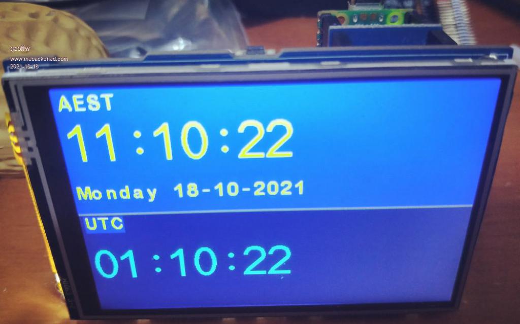

The picture looks like a dud panel, missing the light guide / diffuser that spreads the light evenly over the whole surface. Even with a second row of LEDs on the other side the middle would be a bit dark.
Or they have used the wrong size LEDs and the light is entering the light guide at the wrong angle.
Edited 2021-10-18 09:49 by phil99
Posted: 01:28am
18 Oct 2021
geoffw

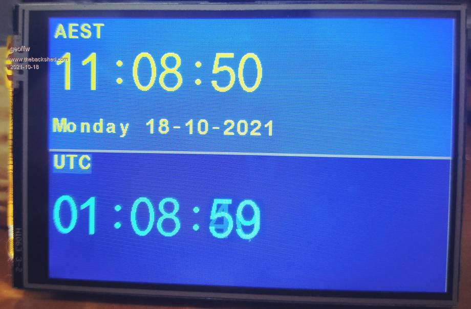

I have this display now working with Peter's latest beta. Waveshare RTC module is mounted with the Pico.
Screens below are taken with brightness at 75 and lighting is good across the screen.
The photo showing the top of my screen is quite different, I would suspect a manufacturing fault.
Geoff

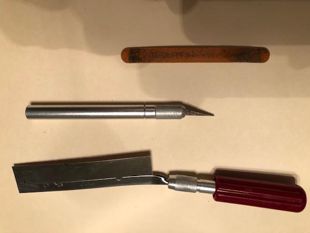

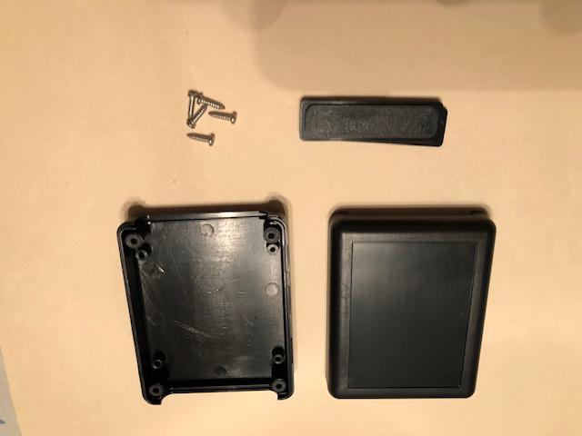

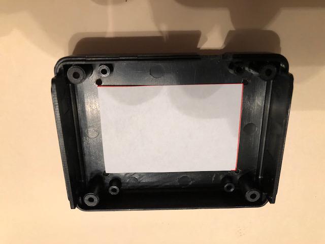

This post describes a simple handmade case for the Waveshare 2.8 inch pico. The case is created using a Zulkit 90 x 70 x 28 mm plastic case available on Amazon. Five cases cost $10 USA. Here's a picture of the contents of each case. The rectangular pieces are side panels for the case.
One side of the case includes a "depressed" area that is the perfect size for the 2.8 inch display. This area is removed using an Xacto knife and hobby backsaw. I first score the edges of this area several times with the Xacto knife and finish using the backsaw. The plastic in this area is thinner than the rest of the case.

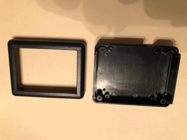

The edges are cleaned with an emery board. Here's a picture of the top and bottom of the case.
I use a paper template to locate holes in the case bottom for mounting the standoffs included with the pico as shown in this next photo. The holes can be created with the Xacto or a small drill. I use four small machine screws to attach the standoffs/pico.

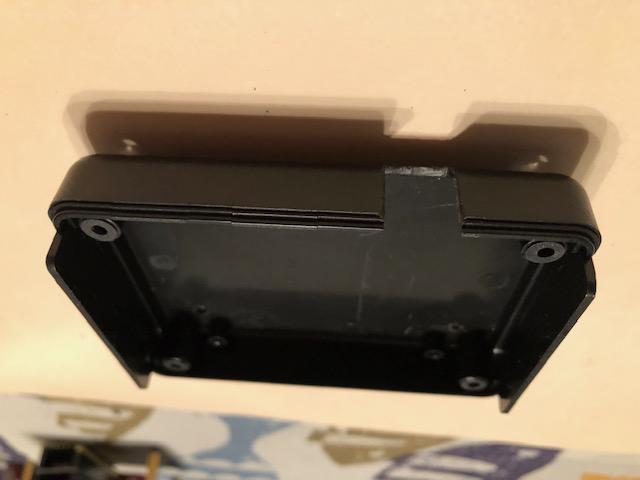

Finally, an opening for the usb cable is cut in the side of the case bottom using the backsaw. Two slots can be cut slightly wider than the usb cable. The plastic can be snapped off using needle nose pliers and cleaned up with the emery board.

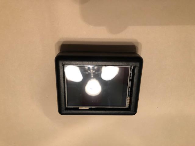

Here's a picture of the completed case. I place four small bumper feet on the bottom so the case does not slide.

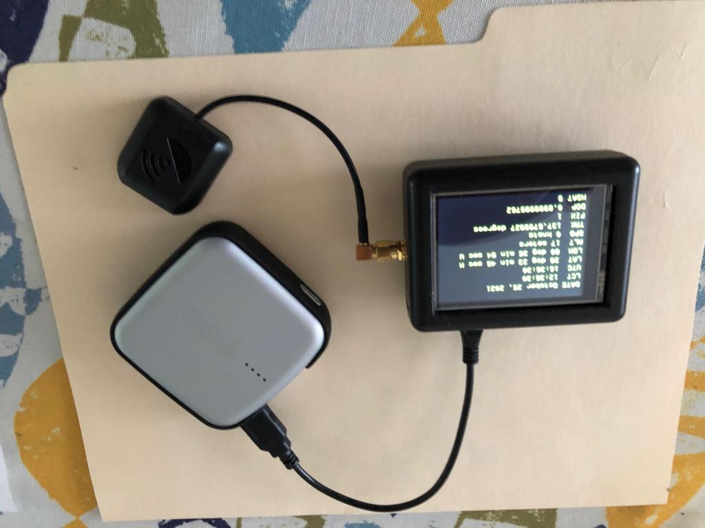

Here's a picture of a "PicoGPS" using the previously described case. This project included a Waveshare GPS with an active antenna and Voltaic rechargeable battery. The display shows everything available via the MMBASIC GPS function.
