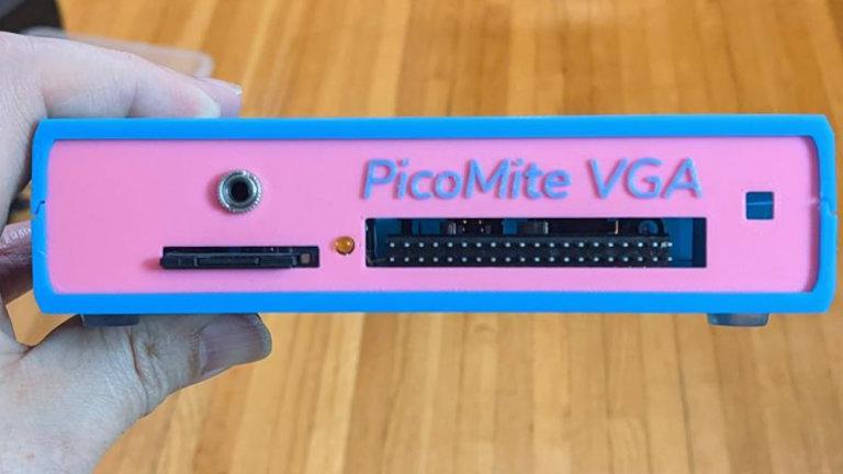

Posted: 03:37am
07 Jan 2023
scruss
If I were a person who knew what they were doing I'd probably not need to ask this, but:
Will a PS/2 keyboard only work if you're powering from USB? My two keyboards only work if they get 5 V power from USB. If I use a power adapter through the 3.3 V LDO regulator, neither of them do anything.
Otherwise, my colourful PicoMite VGA works great.
Thanks!
Posted: 05:05am
07 Jan 2023
  scruss said  Will a PS/2 keyboard only work if you're powering from USB? My two keyboards only work if they get 5 V power from USB. If I use a power adapter through the 3.3 V LDO regulator, neither of them do anything.
Generally speaking, yes.
ALL keyboards - USB and PS/2 - expect a 5v supply.  Trying to run them on 3v3 USUALLY results in no-talkie, and even for those that will talk, it is probably marginal and the board could stop and start working at random.  Much better to always feed KB's 5v DC and use level-shifting on the DAT and CLK lines as per the manual.
Posted: 10:24am
07 Jan 2023
I have two or three PS2 keyboards that are fine on 3V3. The only thing I notice is that the LEDs are slightly dimmer!. However, I design my boards to power the keyboard from 5V and include some sort of level shifting for the PicoMite. It's not worth doing otherwise.
That looks so cool, scruss... and no clash with the purple PCB at all. LOL!
Posted: 08:07pm
07 Jan 2023
scruss
Ah, thanks. Looks like this one is going to be USB powered from now on. Just as well, as I can't source any other 3.3 V regulators affordably.
