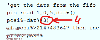

Posted: 11:49am
15 Jul 2026
Phenix,
Maybe this helps:
Posted: 02:10pm

PhenixRising
Nah. Was one of the first things that I tried.
